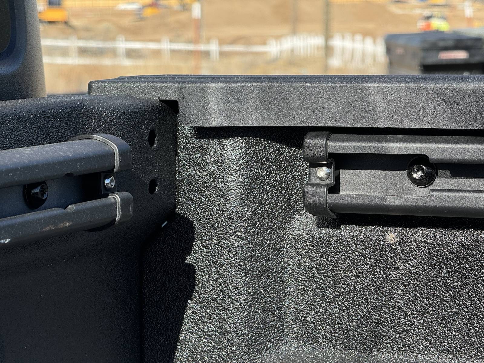

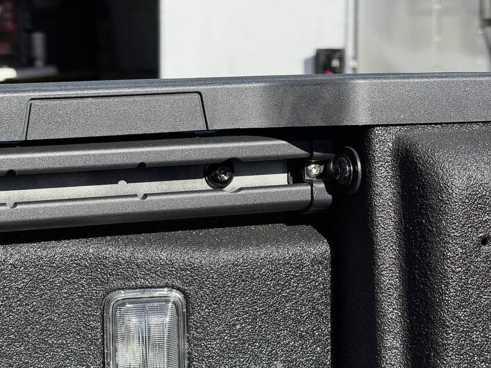

Can't flip them over, actually. In fact now that I think about it, there ARE separate L/R rails... at the rear-end of each rail is a metal tab with a hole that is designed to be screwed into an insert that you put into a hole... here it's easier to just include photos.
Jeep Gladiator Amazon "Trail Rail" kit -- is it defective or is it my JT? 2024-01-29 13-35-47
Jeep Gladiator Amazon "Trail Rail" kit -- is it defective or is it my JT? 2024-01-29 13-35-53

Get out your tape measure and take some measurements of the rails and the truck bed.
also, according to the pic in your link those rails have a slot on one end of the groove to insert the rings.

Thanks! I never noticed the slot. Good eye.
