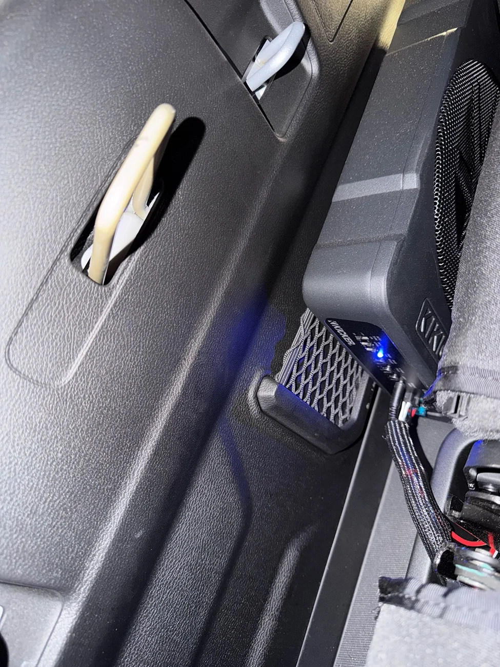

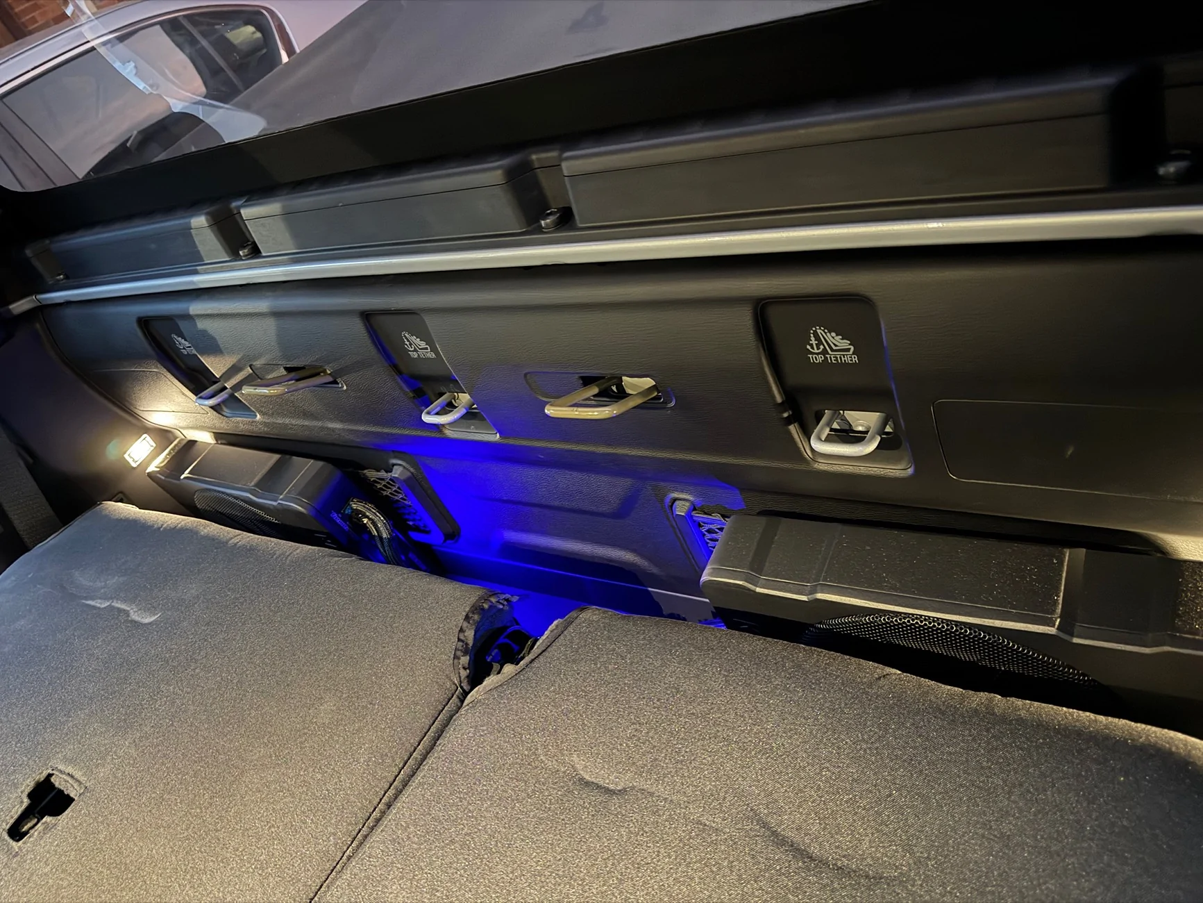

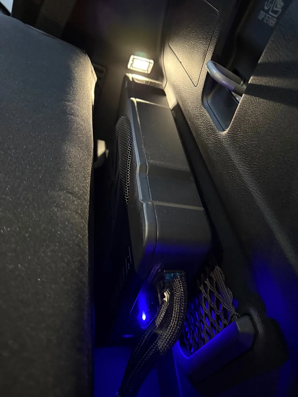

Look on ebay for the Kicker HS-10 powered subwoofer (cheaper if refurbished ). I bought two & they don’t take up any valuable storage space. Follow the trail seven install video. I also replced the top dash & soundbar speakers. Big difference but not the same as a dedicated amp/sub box

We need some photographic evidence of said dual HS-10s in the Gladiator. :movember:

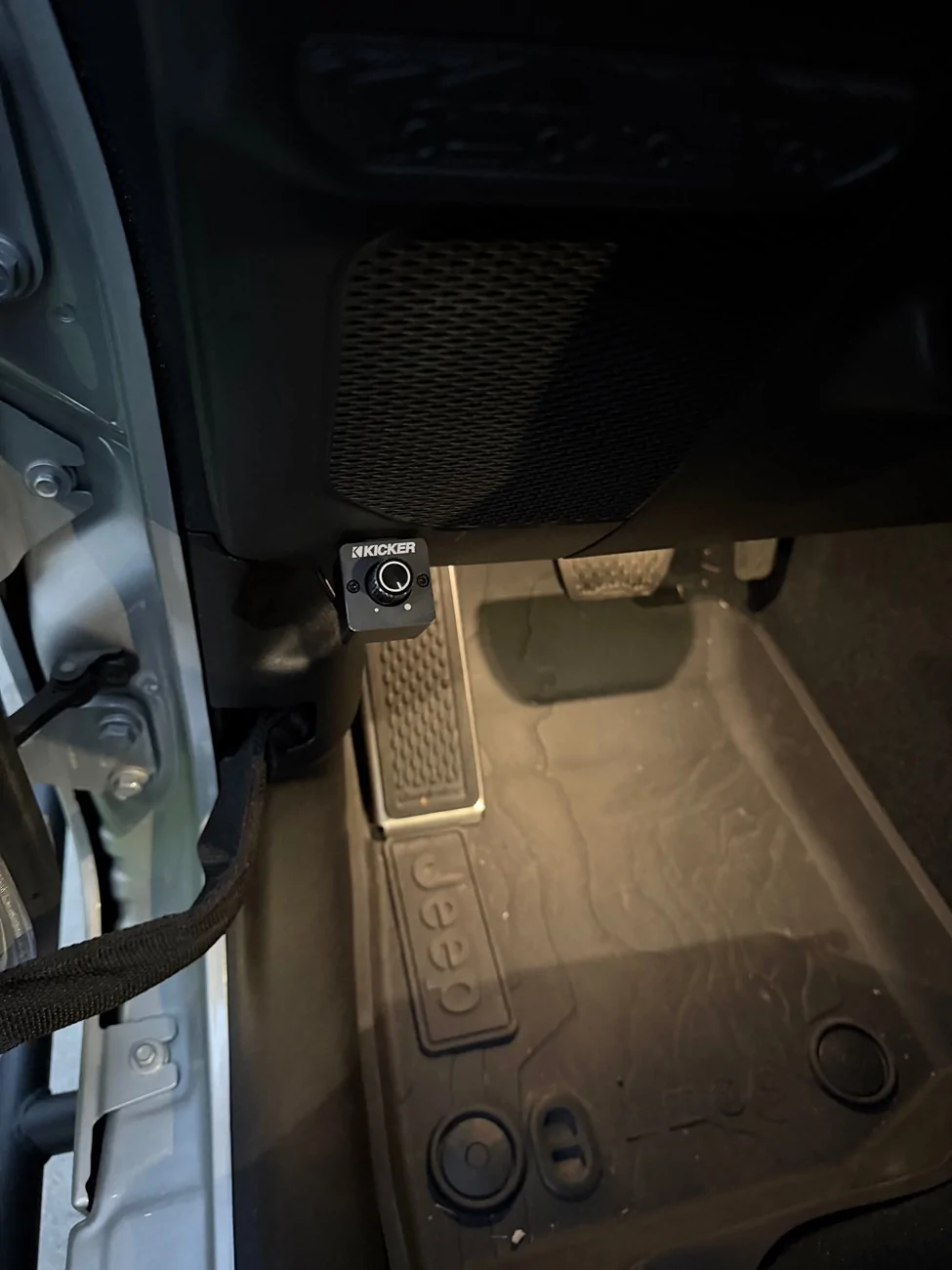

Here you go. I did also buy the remote subwoofer level knob that controls 2 subwoofers (otherwise you would just have 2 knob’s).

Looks good! I like how you pointed all the wiring towards the center. I’ll have to double check specs and see if this would be better than the HS-12. Haven’t seen one of those in a Gladiator yet so not sure how fitment is going to work out.

Didn’t know Kicker made a HS-12. But the HS-10 fits perfectly. If I remember right, I started with one sub & later added the second one which I tapped into the same speaker leads as subs are non directional & these are self amplified (just needed a signal). I did run a separate power & ground for each. I wish there was an easy way to add sub pre-outs on our basic radio (without headunit removal). I am using the Hi-pass setting currently

HS-12 is a fairly new release. Within the last few months. I didn’t know about it either until someone on here mentioned it. Slightly bigger footprint and slightly bigger amp.
