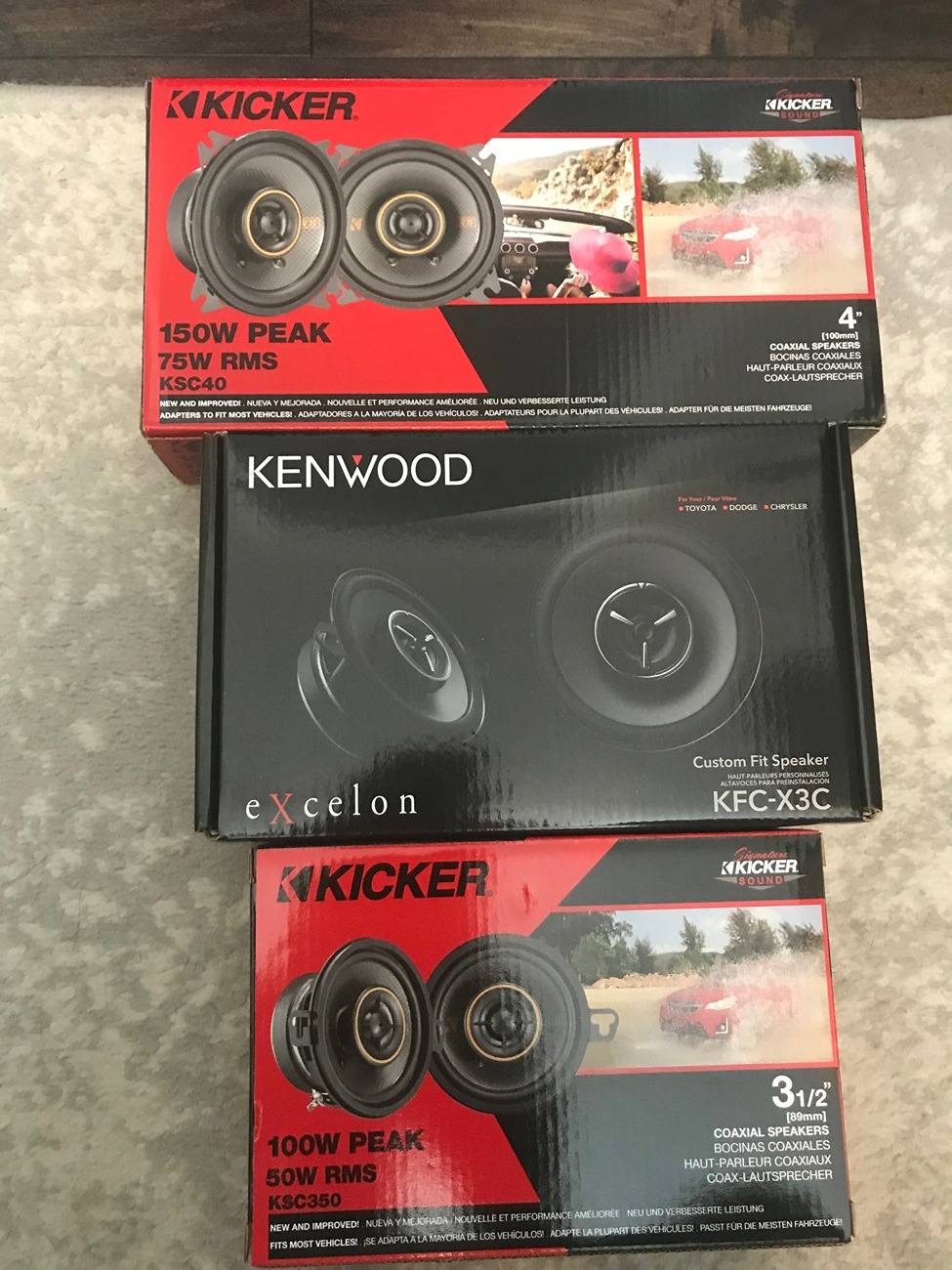

Is there a reason you went with the Kenwood for the soundbar instead of using another set of the 3.5" Kickers?
That is what Crutchfield recommended on their website for a 2024. And so far, they work great, Sean!

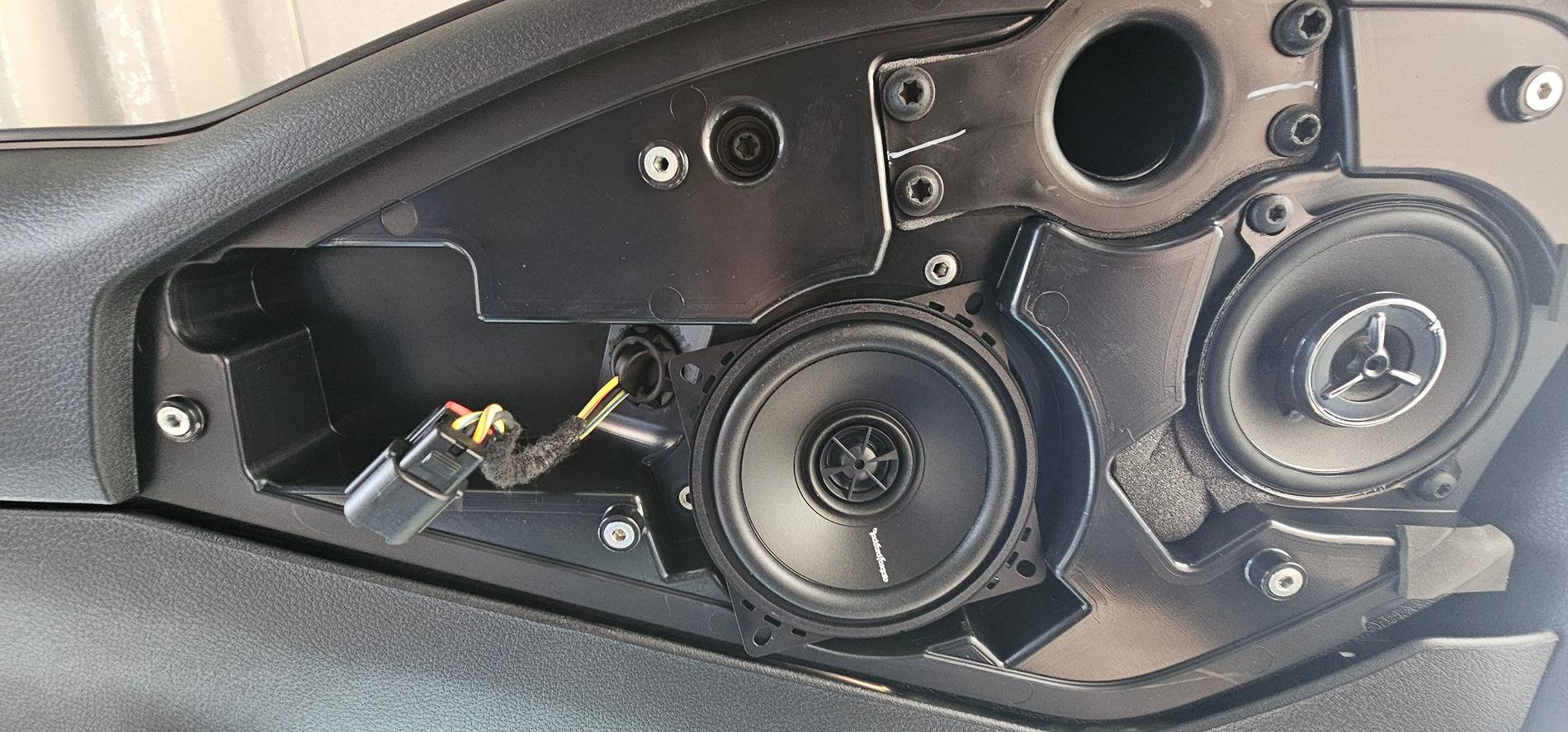

Going to revive this thread as I purchased a 2024 with the base sound system. The audio is just freaking ridiculous for a 50k+ vehicle. I installed the kenwoods in both the soundbar and dash. Honestly no real improvement. I also bought a set of fosgate r14x2. They will not fit unless I do some cutting to the soundbar. My expectations for these tiny speakers are not to blow the freedom panels off but to at least get rid of the 1950 transistor radio sound. It's like everything is in tweeter mode. I have my equalizer setting with the bass at 9 mid at 2 and high at -5 just to try and deaden the high pitched scream of the speakers. I'm thinking of sending back the kenwoods with the fosgates and go with the kickers.
I think you will like the Kickers. Big improvement for me anyway!

Plus I don't understand Crutchfield's "expert" advice of mixing speakers (in your case the Kickers and the Kenwoods). Is it to provide a mix of frequencies, does it improve the sound compared to if you just went with all Kickers?

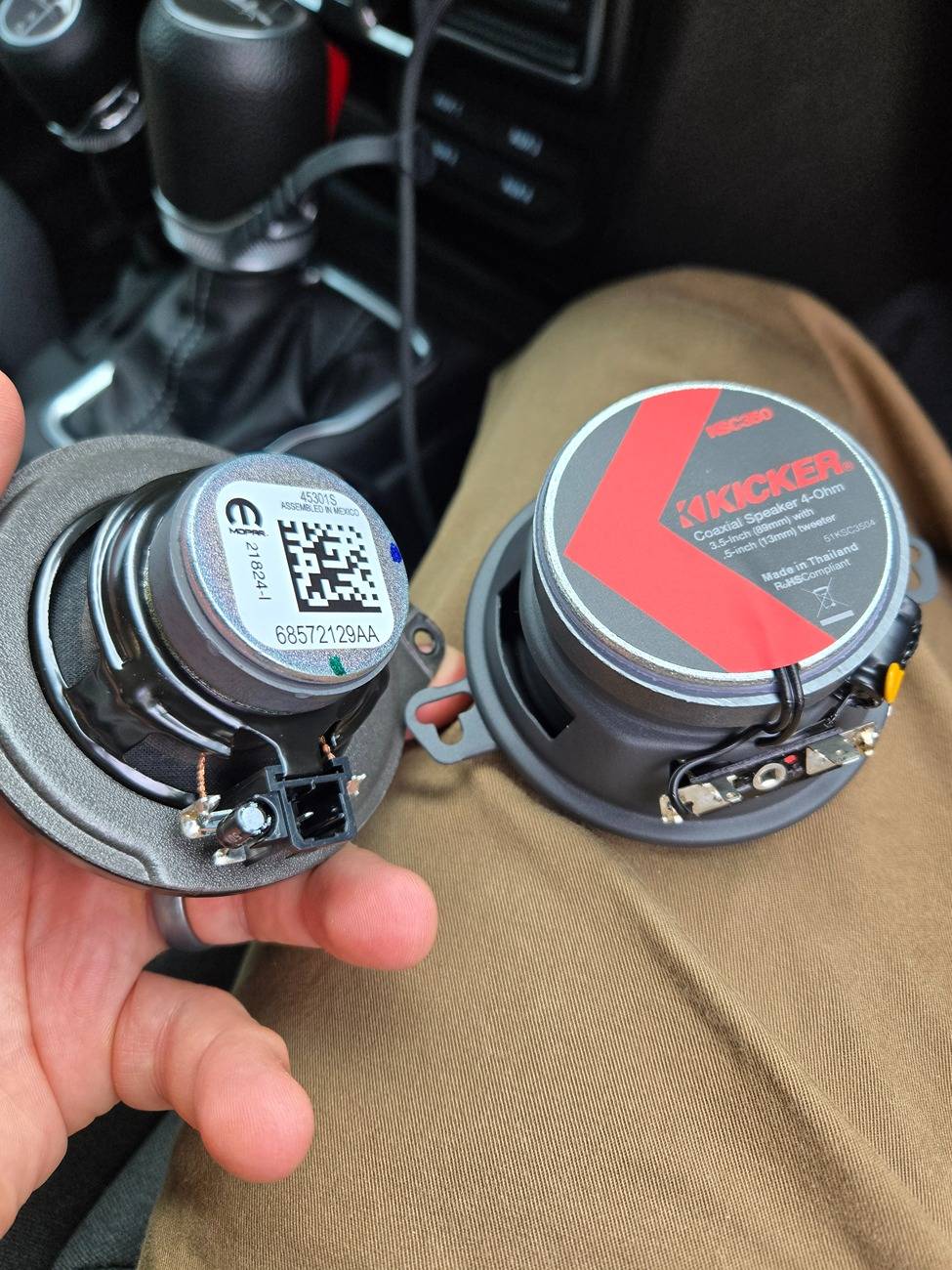

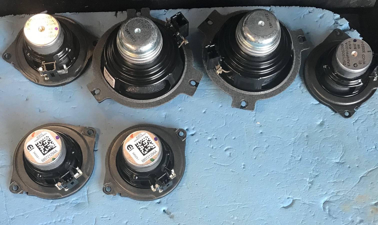

I have a 25 with base stereo. I replaced the front dash speakers only and it made a huge difference. Just look at the size difference on the magnets .
