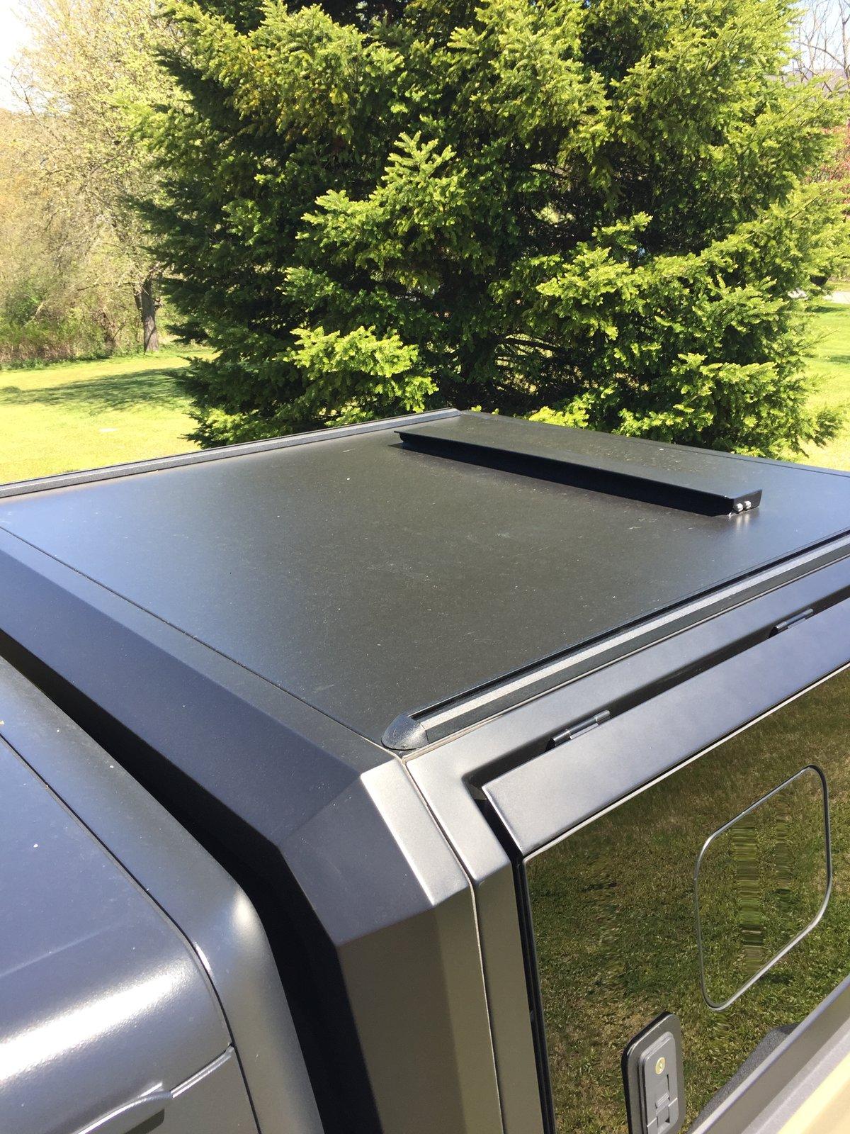

@RSI North America Inc where is the positive vent located at? I can's see it in any of the photos. And can you confirm that the top of the cap is slightly higher than the top of the truck? Do you know by how much?
The total height of the SmartCap Gladiator Edition with the Positive Pressure air vent is 22.84". Typically, the roof of the cap is in line with the crown of the cab roof.
Thanks for the quick reply. I've got a couple more questions for you.
1. Is the vent taller than the mounting rails? The pic makes it look that way but I don't think it really is.
2. What is the dimensions of the Bins and the MOLLE panels inside them?
3. What are the dimensions of the drawers in the Drawer Bin?
4. Is the Drawer Bin only available on the driver's side?
5. What does the Evo cap weigh?
6. What is the distance between the bed and bottom of the Bins?
Thanks for taking the time to answer all of those.
See below for specific answers.
1. Is the vent taller than the mounting rails? The pic makes it look that way but I don't think it really is. Yes, the Positive Pressure Air Vent is slightly taller. The Roof Rails are 20mm high and Air Vent is 30mm).

Thanks for the detailed responses. It's a bummer that the vent is taller than the rails. That means nothing can be flush mounted over that area of the cap.
One last question (for now lol), what is the spacing between the two rails?
The width between the rails is 1190mm or 46.85".
