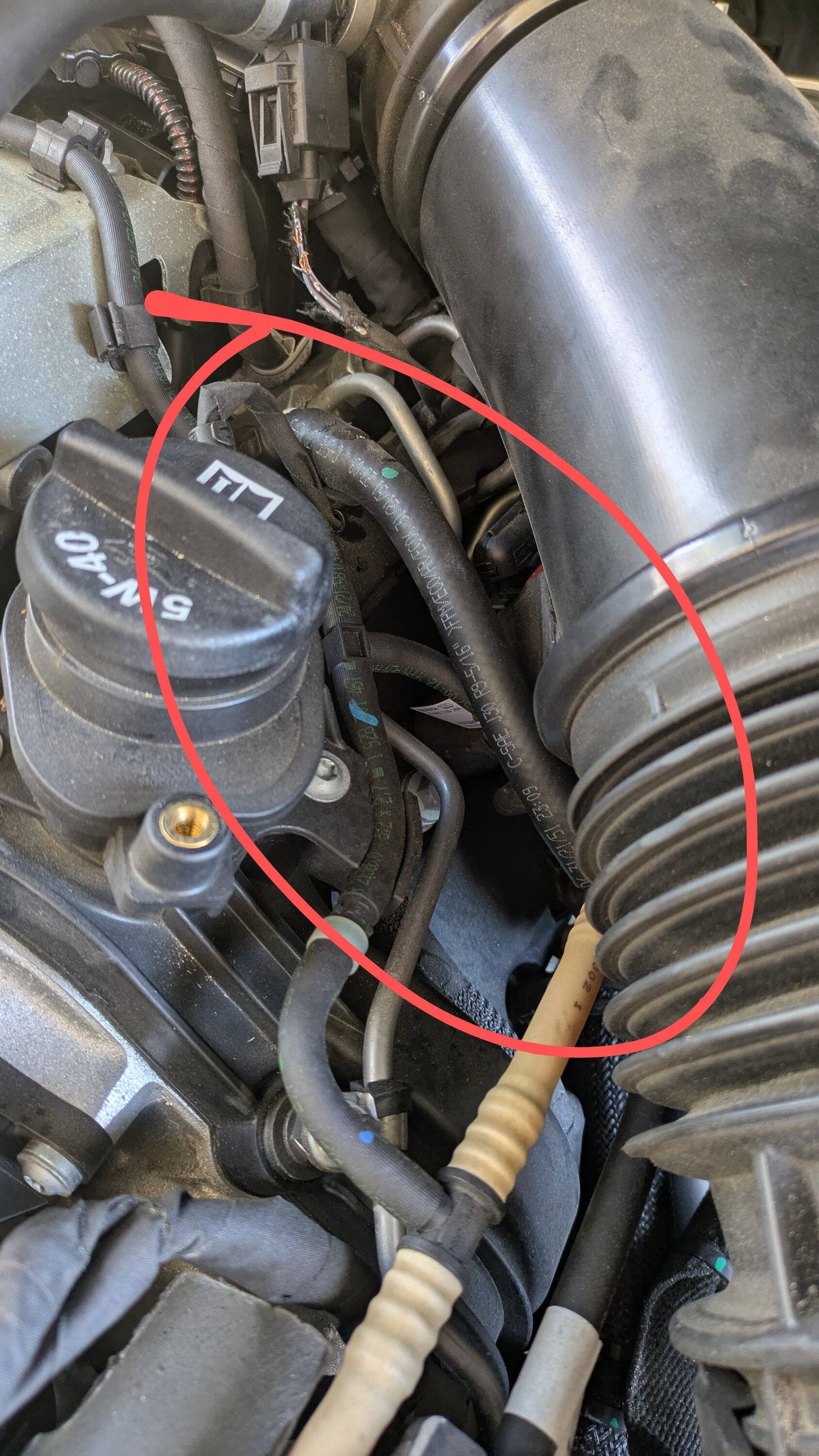

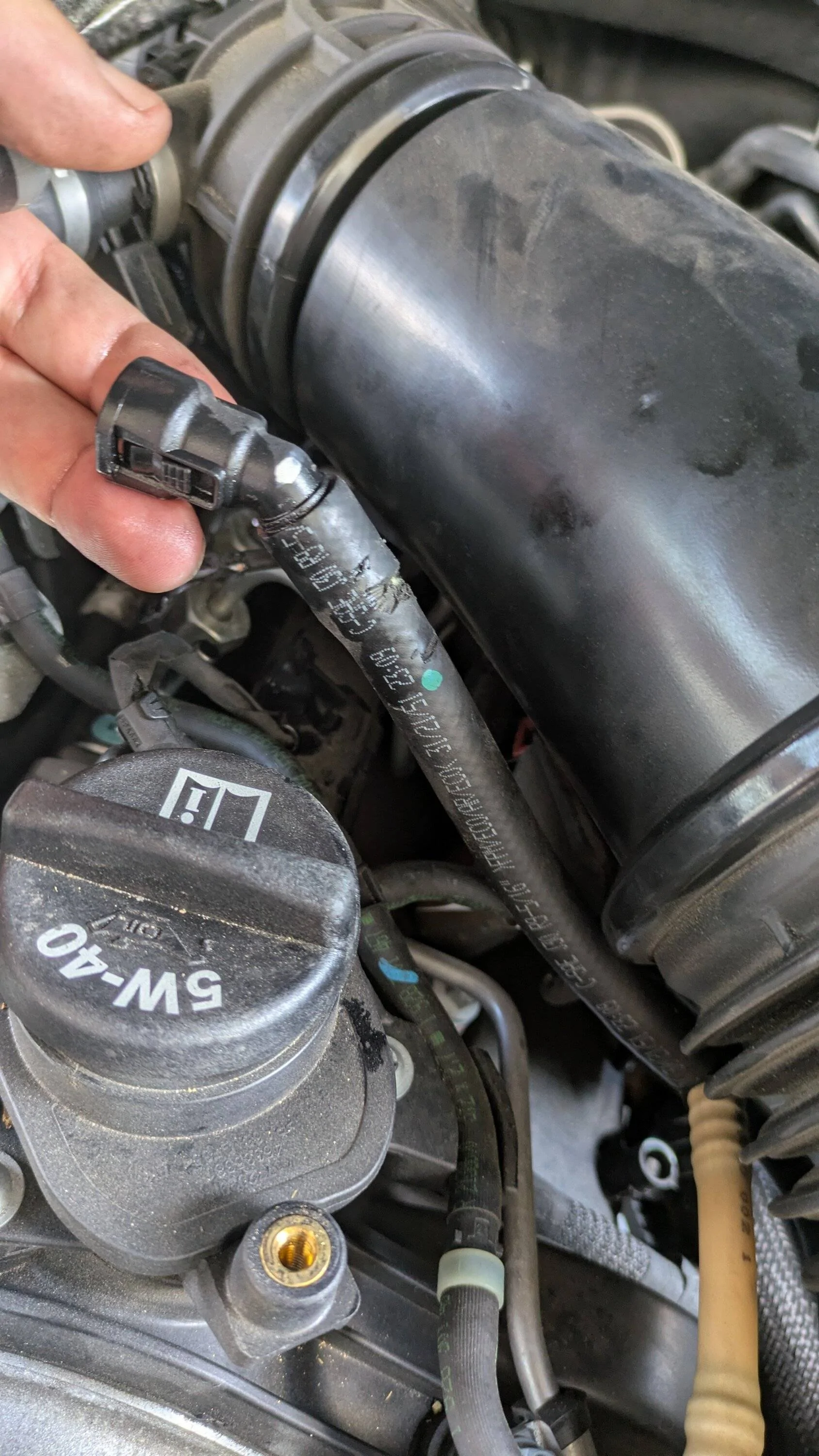

Can anyone help me identify this hose so I can order and replace? 2022 Eco-Diesel.
I can cut and solder the wiring harness
Any help or illustrated parts breakdowns would be greatly appreciated.

Looks like an EVAP line.

Think I can just buy some 5/16" fuel line and reuse the connector, possibly add some clamps if necessary?

Looks like the fuel return hose for the rail, only available as part of the next higher assembly -- part number 68504210AA. You probably can replace just the hose if you're careful.

Definitely looks like that's the part. I appreciate the assistance!

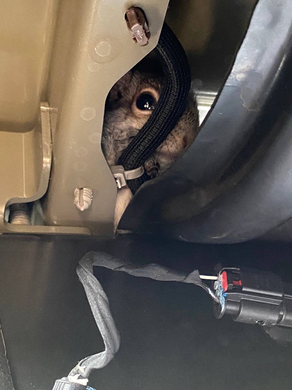

Been there. In 2018 a squirrel chewed holes in an emissions hose in my 17 Wrangler JKUS while it was parked in our driveway. $300+ damage. I was able to garage my JK after we got the moving boxes out of the garage about 3 months after we moved.
I have a Daisy Red Ryder with a scope at my front door. Pepper their busy asses every day. Doesn’t kill them - but they sure run like hell. Payback’s a bitch! 🐿🐿🐿

I hate squirrels . After this guy and the one that tried to chew his way through my house roof vent, I gelblast them daily. It doesn't kill them but annoys the crap out of them.

We ended up buying a Grid Guard to put around our motorhome to keep the Squirrels and Mice out. Wasn't cheap but neither is repairs. Basically an electrified stainless steel mat, doesn't kill them but sure keeps them away from it. Accidentally set down on it one day, I sure know why they stay away haha.
