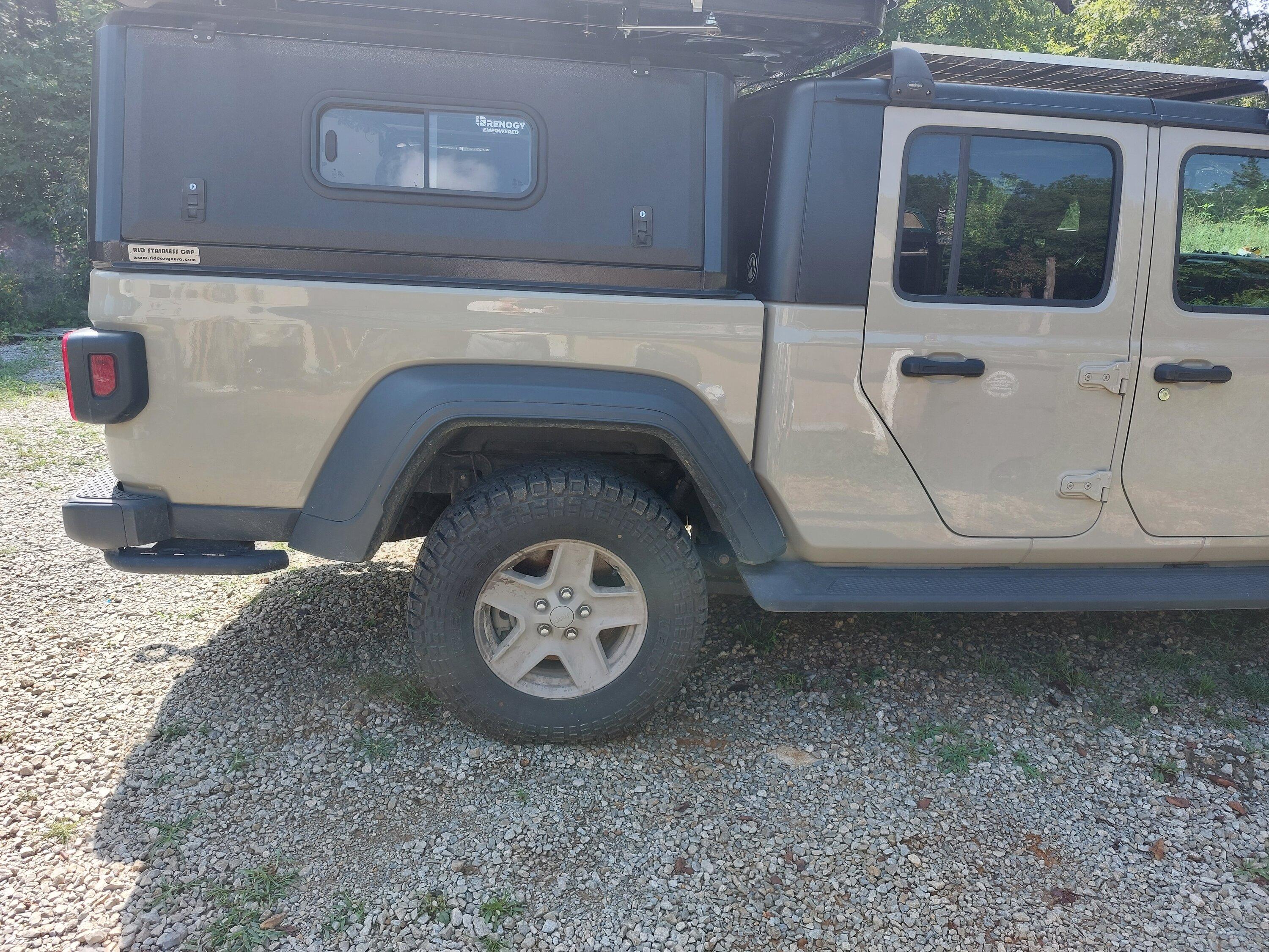

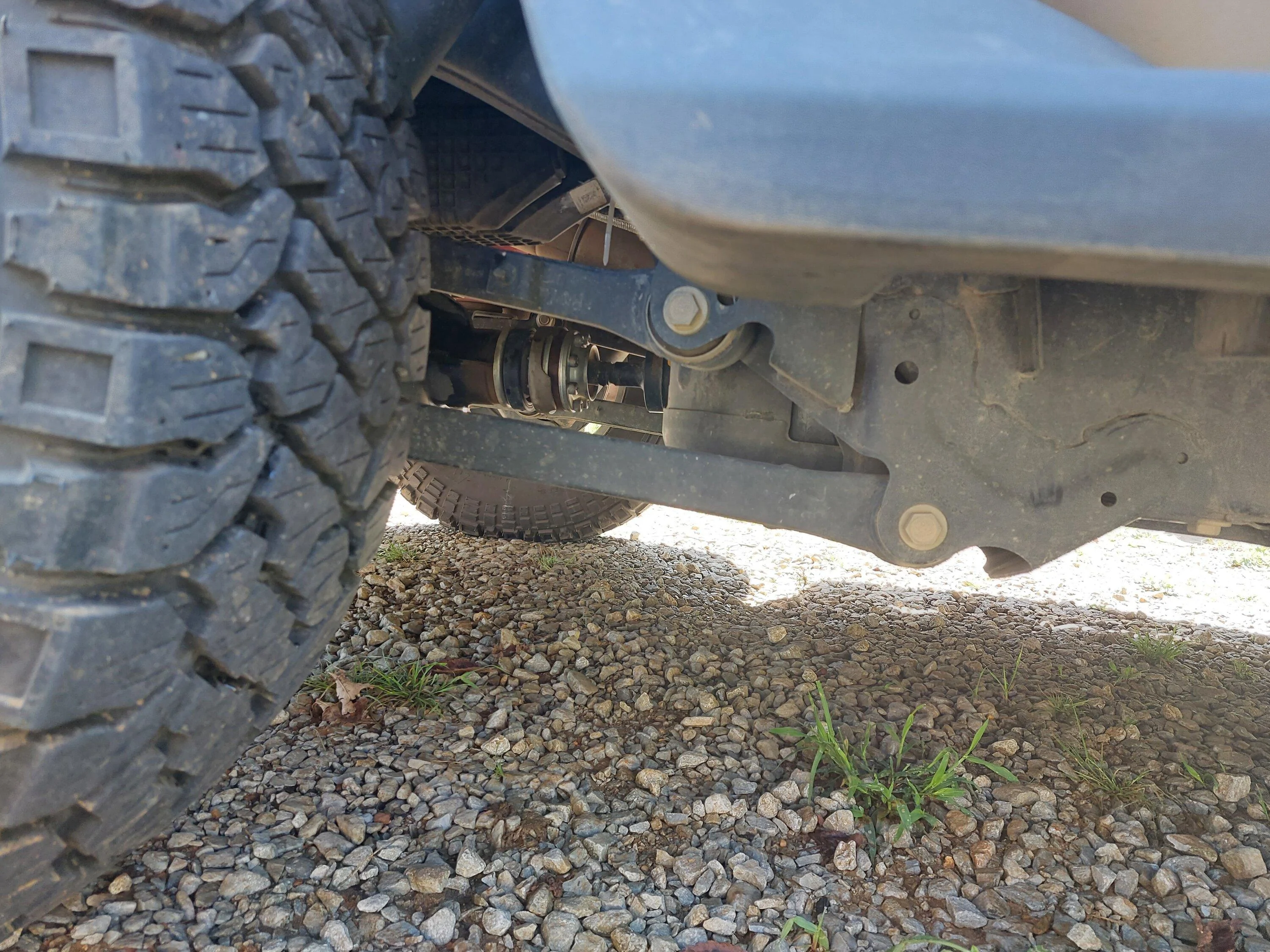

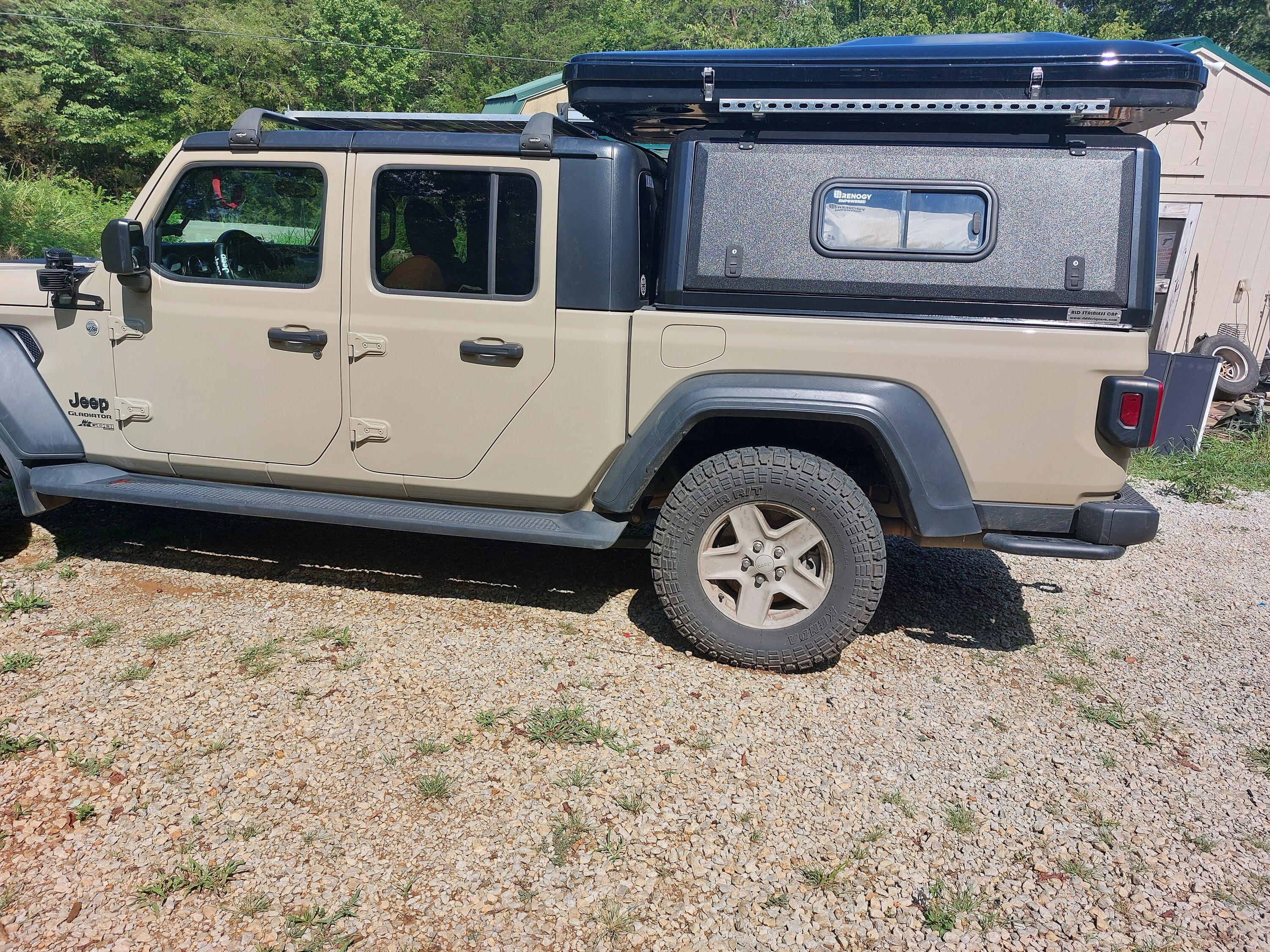

Bill you have a idea of how much crap is in my Max-Tow so I'll plug in a few pics. The air bags have 14 psi air. Probably around 900 lbs load (others to note). I need to get weight of my JT again and down load then do the same empty. The scale I used in past went out of service.
I remember dang air shocks always needing checked and reiflated, that was a concerned on air bags i had too. I've so far not had any issues with leaking down.
