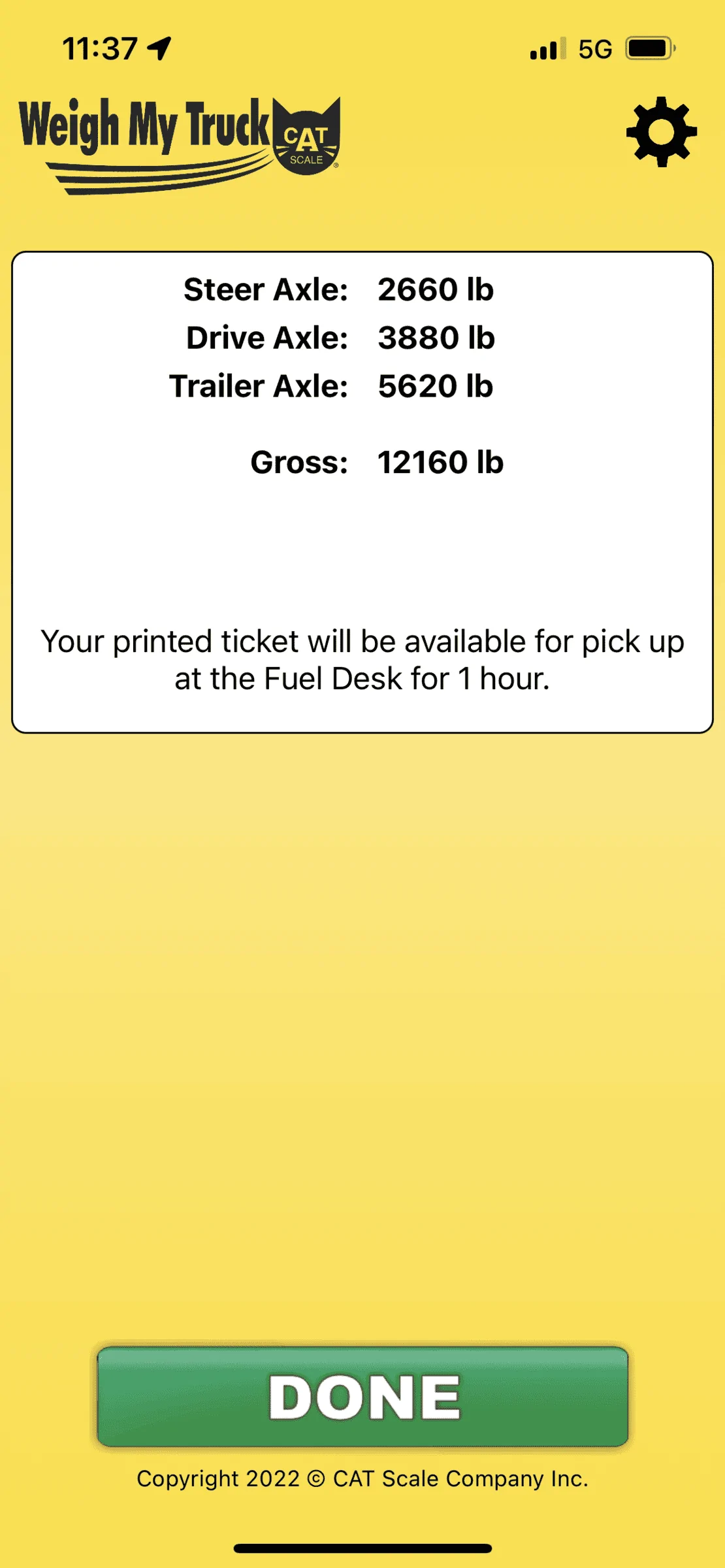

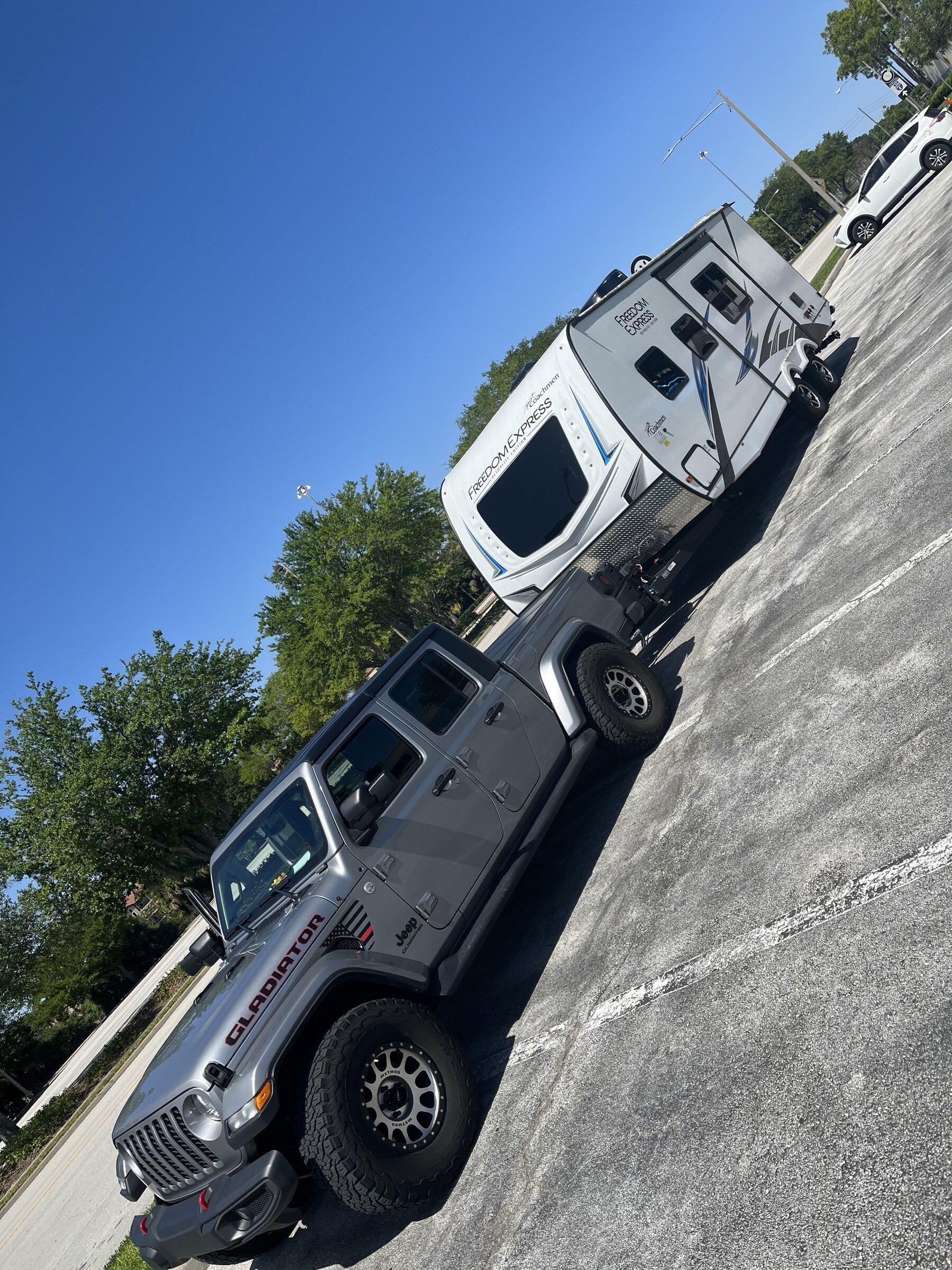

Just reading through this post. Just did the CAT scale this past weekend. Family of 4 (me, wife, 14 yr, 11 yr). Full tank of gas, lightly loaded bed, we are weekend warriors. I know I’m over on Drive axle, trying to figure out my tongue weight. TT is a 2020 Coachmen Freedom Express 248RBS. I am going to order some air bags to help with squat, but isn’t too bad. Any input would be great!! Thanks.

I am all setup, minus the air bags. I shifted around the wdh setup and leveled out pretty well regarding weight on the axles. The JT is more than capable. What model TT you looking at?
