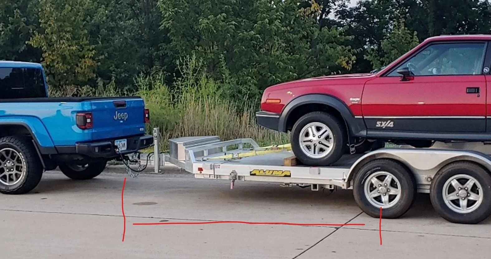

if people look at the tracking of a swaying trailer, you will see that the trailer is actually covering more distance than the tow vehicle, it's going FASTER than the tow vehicle and to do so, it has to cover more ground, and swings back and forth behind the tow vehicle.
That's why hitting the trailer brakes ONLY where possible (electric brakes) will stop a sway - you are slowing the trailer only.

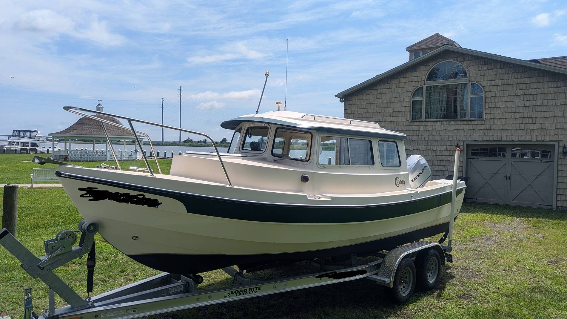

C-Dory 22 (not related to Cape Dory, oddly, made doubly odd that someone bought both the later evolution of this hull and also the naming rights to Cape Dory, and started making a Cape Dory Marinaut 21 which isn't a C-Dory or a Cape Dory (in the traditional sense)). 22' pilothouse modified dory hull (sharp entry to trim down into the chop, flat aft for good economy: 6mpg isn't unheard of at good cruising speed; top out around 30mph). Helm seat flips forward, table also hinges for more space, and converts to extra berth. Stove and usually a heater on the other side near sink. Good cockpit size. Wanted one for years. This is a 2005, but will be new to me. (I scribbled over the reg # up front and on the trailer)
Oooo…..that is definitely more boat than mine! That would be a wind sail compared to mine. Like everyone has said, it’ll come down to tongue weight.
I don’t know what mine is, but I can’t lift it.
