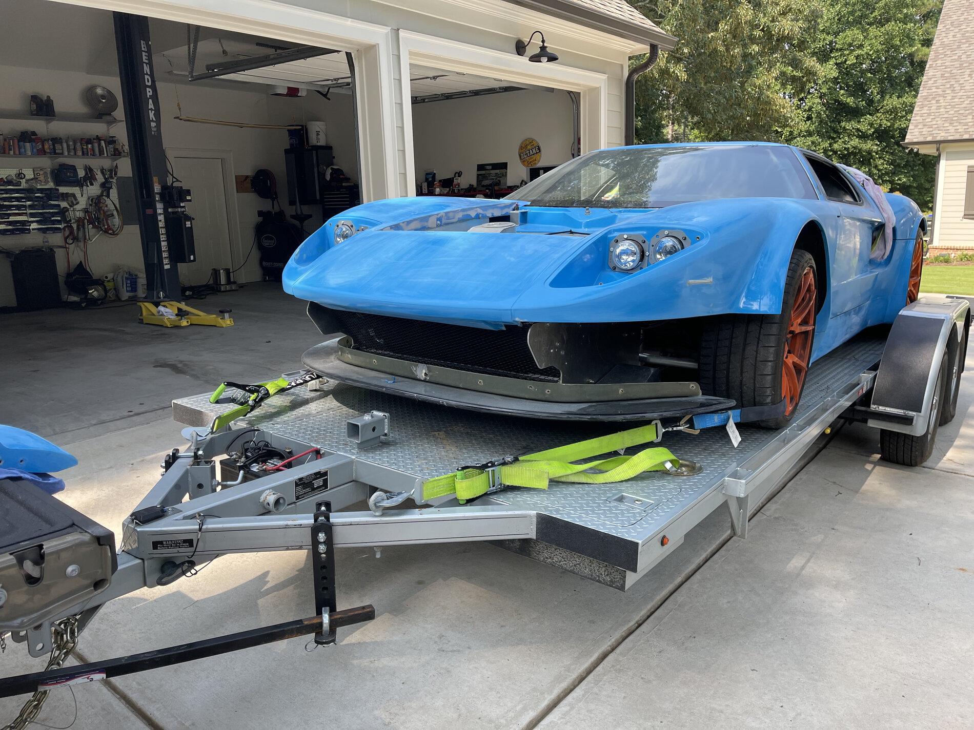

FA92-00-0600Fastway e2 Weight Distribution w/ 2-Point Sway Control - Trunnion - 6,000 lbs GTW, 600 lbs TW
Jeep Gladiator Weight distribution hitch IMG_1266
Towing is great, loading and unloading sucks. It is a tilt trailer and it will not tilt with the bars in place. Still worth it for getting there and back.
