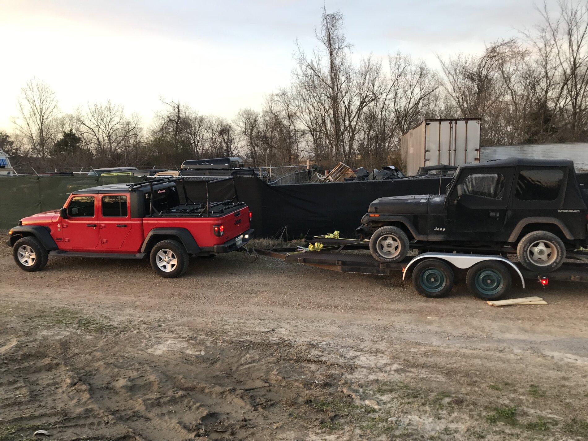

I just towed a Jeep YJ on a 2500lb U-Haul trailer (the old steel one) total weight was around 5500-6000 lbs.
This is how close the trailer tongue was to the ground. tge Max Tow JT has quite the squat, estimated tongue wt about 5-600 lbs. load leveling hitch would have been much better
That looks sketchy.

? you got that right! And Uhaul thought it was fine. You can’t move weight back on the Uhaul trailer. So you live with it. Options I could have done were a level or inverted my 2” drop hitch. It tied fine and I survived.

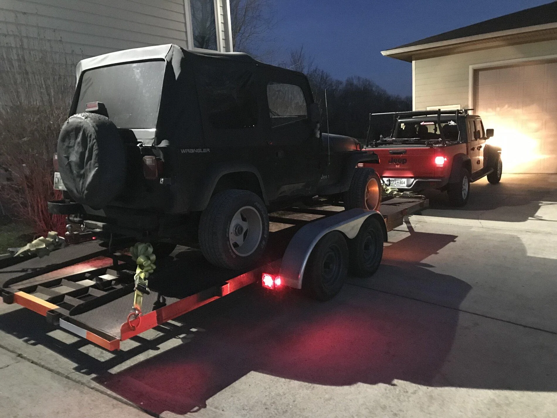

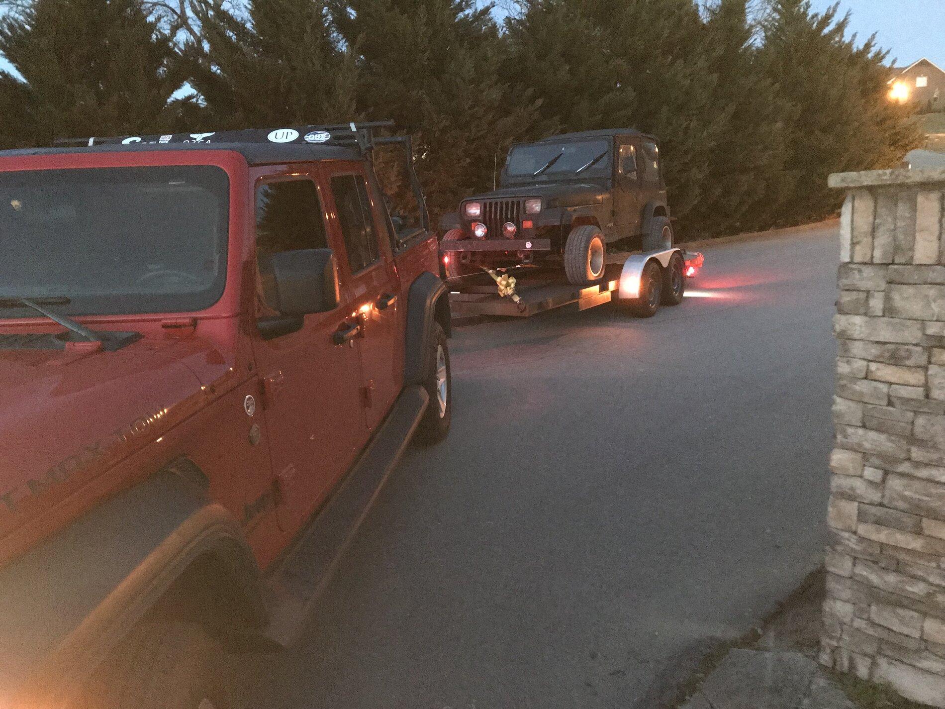

Here is my setup now, I bought this trailer 7x18ft car hauler for adventure build out, but still able to haul a car orJeep when finished with build.
2” drop hitch with the load over the axles as they should be.
Jeep YJ weighs a little under 3300 pounds, trailer is 1500#s total weight is 4800#s.
Tongue weight is about 500lbs
