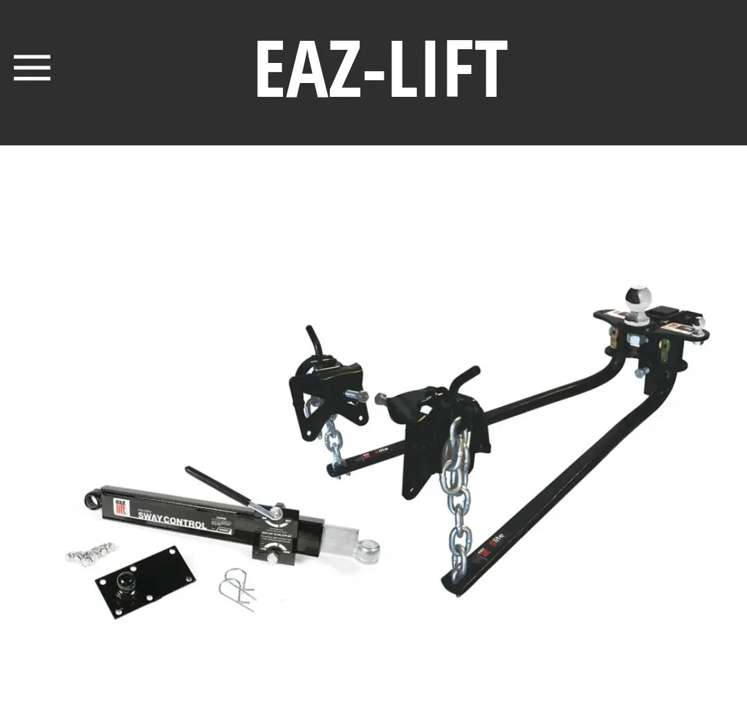

Not sure if this belongs in camping or here (or RV forum lol) but, I'm looking to purchase a WDH, just unsure which tongue weight I should go by. I have an overland and max is 600lbs. My camper is 400lbs. Should the WDH be 400 or 600? I was looking at the camco recurve 3 and not really sure if that 200lbs will make a difference. I was leaning toward the 600lb one just b/c its the max for the JT so I'll never have a camper above that as long as i have the JT. https://www.eaz-lift.com/collection...ecurve-r3-weight-distribution-hitch-600lb-kit

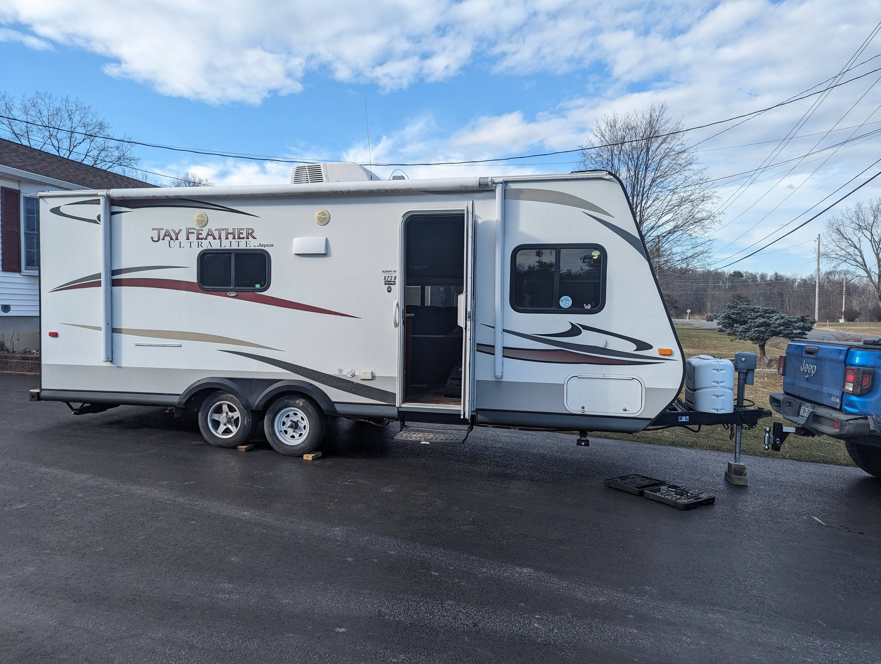

That was on the list too. I like that its light weight compared to others and doesn't have component like a brake pad, that wears down but Ive seen complaints about bending the frame bc of how it attached to the a-frame. maybe like anything, those with problems are more vocal then those without.
Feel like there's so much I had to get compared to my popup. This thing is like a jeep, eating the money. Unfortunately, it just cost me 300 to get it registered and get plates. wasn't expecting that hit today

Yeah, i think I'm going with the 600 if I go with the camco one. 200lb difference shouldn't be overkill. I've read that running something too high could overdo the weight distribution and have a negative effect.
