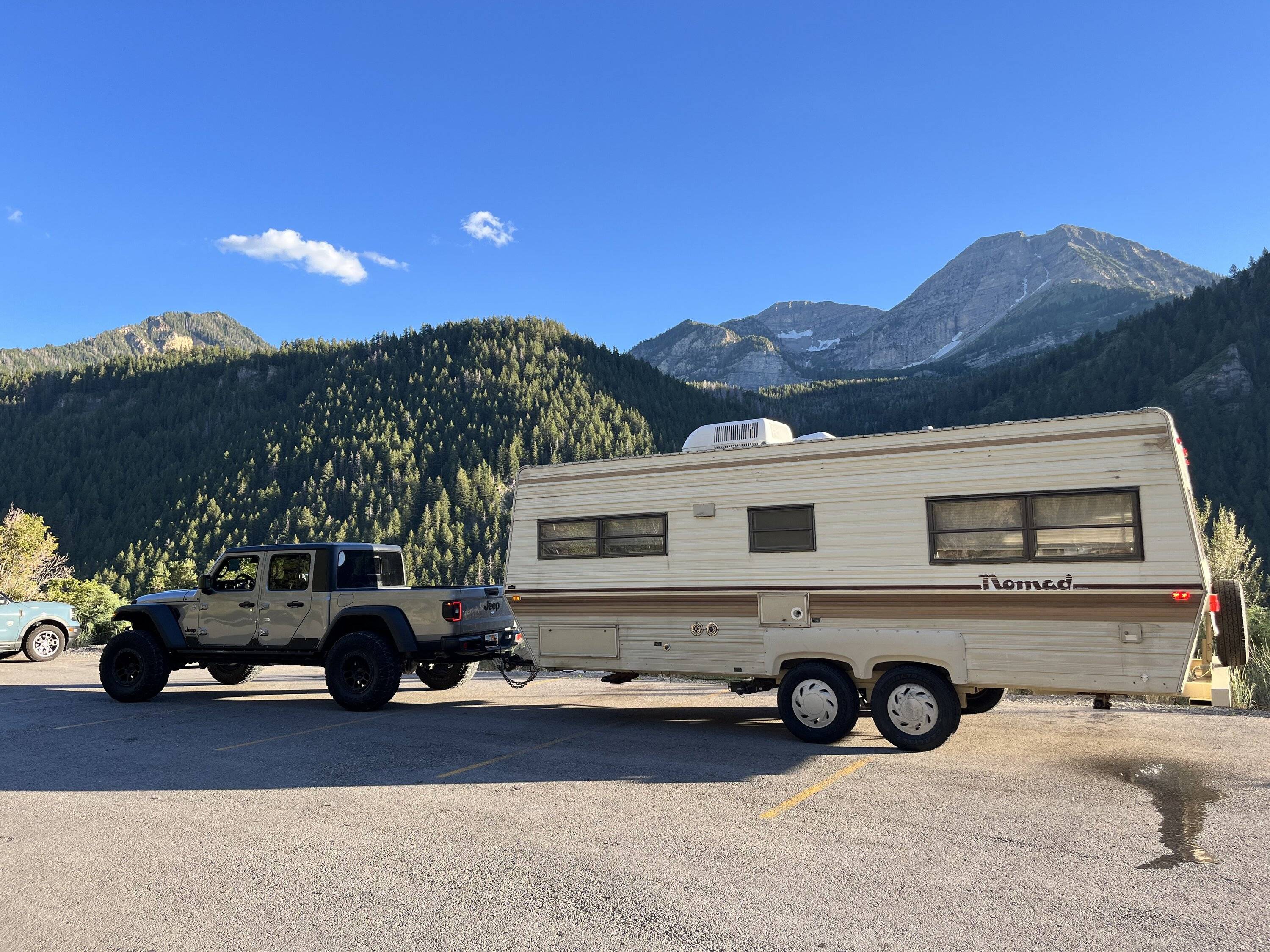

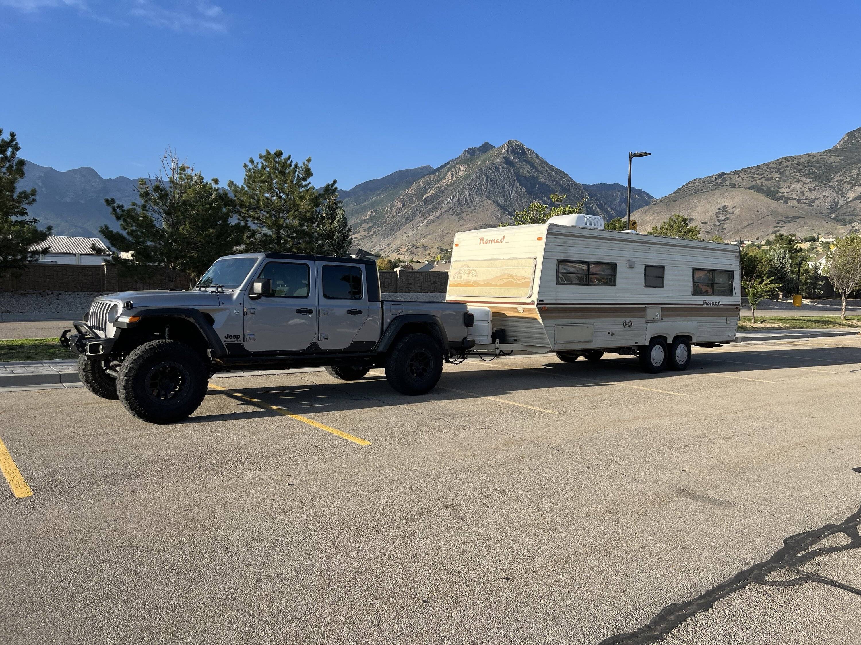

Did you set up your own WDH? Some say that even the dealerships don’t do it right sometimes, which I believe. So I tackled the project myself today on my “equalizer“ branded hitch from what seems like 1984 (specific guess only based on the year of my trailer). They’ve been in business 75+ years and it’s clear they don’t change much! Anyway, I was surprised to find that during my adjustment for the weight distributing, that the front end didn‘t compress at all. Which is what they have you do all your measurements off of. So, because I was a little confused as to why I wasn’t getting any movement, I went against my better judgement and just eyeballed it.. Yikes! I know.. But I think it turned out really well and I went and gave it a test drive & it pulled great! I was seriously impressed. But then again, it wasn’t on the freeway. So I won’t count it a win just yet. I was wondering if others that set up their own WDH had the same experience, fighting to get that front end down.. Here are some pics of the progression for me.. This is leaving the WDH how it was from the dude I bought it from.. Lots of squat.

I think it looks better!

If it works, it works! I’ve followed directions on similar-age WD hitches, and it just wasn’t right. Decided to try my own approach, and achieved great results. Sometimes, it just takes trial-and-error.
