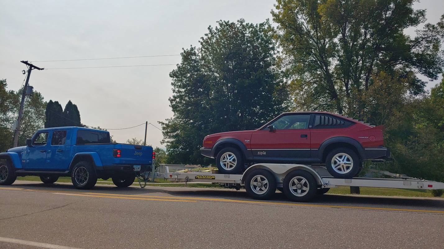

I’m set to pick-up a 22’ boat on a dual axle aluminum trailer that the manufacturer says cannot accept a WDH due to strain on the “Y” shape. It’s in their FAQ on the website, and I’d read that is the case for many aluminum boat trailers (vs galvanized steel boat trailers or other shape trailers, eg flatbeds, dumps etc). I have a stock 23 Gladiator Diesel Willy’s with 6500 lbs tow rating; loaded boat trailer 4500lbs. I’m assuming for quick math that the rear axle weight will be fine (will check later), but am considering adding both air bags and a mechanical sway control. If the increased weight on the rear axle from using air bags (it makes it more than just straight bumper carry, according to a video I watched that weighed with and without airbags) keeps me below the axle rating, and I use a sway control, do we think that’s sufficient? Overkill? Would one be better than the other if I only did one? Is straight bumper carry ok? The trailer has surge disc brakes but no controller. I considered sumo springs and similar but feel the air bags make more sense for my use case. I’ll be driving 8 highway hours to purchase this boat, and then back again, so it’s something I wanted to get right ahead of time. (Why? It’s a rare boat in this part of the world and the price is right). Thank you for any insight from people who have gone through this.
If the tongue weight isn’t horrible, just tow it. You already have electronic sway control in the Jeep, and that’s not that much weight. The tandem will help a ton, and is appropriate for a 22’ boat. Just don’t load the truck up with extra stuff. If they say not to use a wdh, don’t use one. I don’t use one either my 14’ cargo trailer. It’s 2000 empty and I’ve easily had 3k+ of cargo in it. No probl with sway whatsoever. You’re not going to be going 80, but you don’t need to. Just take it easy. It’s well within the limits.

Thanks, everyone. I’ll look into what’s involved with adding airbags myself or if that’s an appointment somewhere. I use the receiver hitch frequently for light trailers but will need to get an adjustable drop hitch so I can set it so the trailer is level post-sag. Appreciate the tip about not overloading one axle; I’ve only towed single axle prior.
Great group.
Definitely, even with small trailers it’s very important that it be level. If you don’t want to spend adjustable hitch money, just measure when you get there, and hit a hardware store to get an appropriate fixed drop. Get one a little higher than your measurement by several inches to account for losing your rake with the tongue weight.
