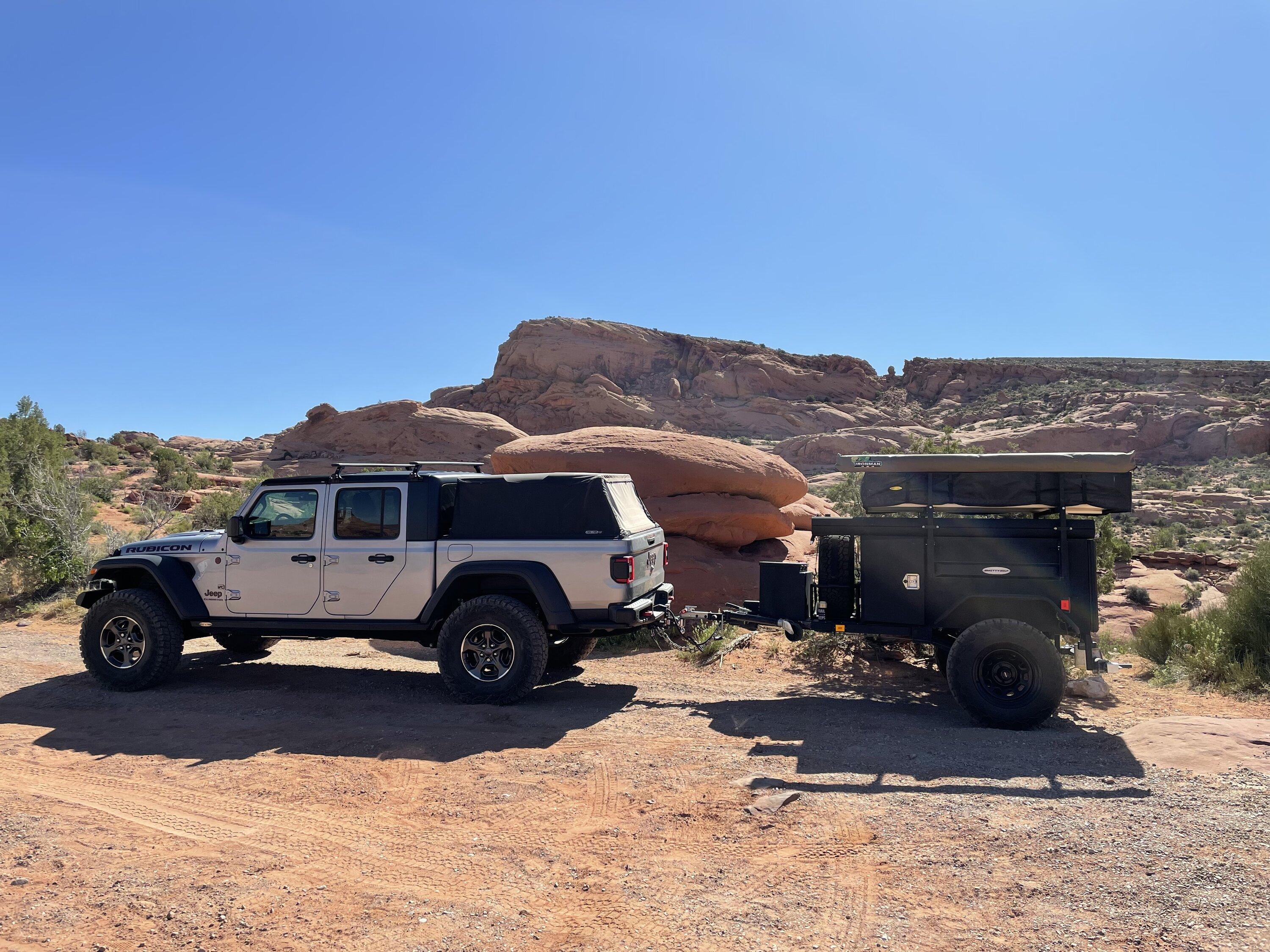

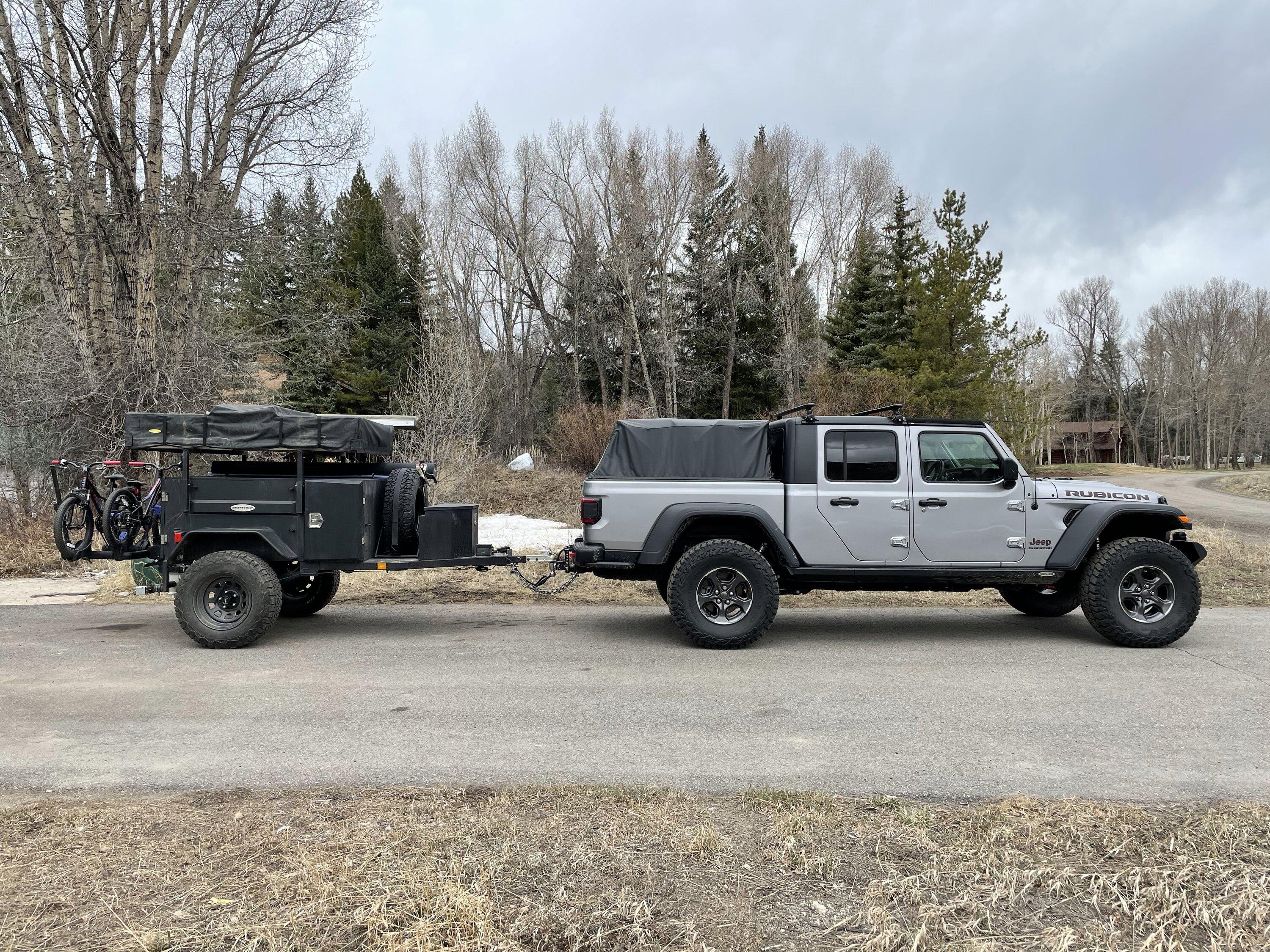

I have experience with this first hand. I have a 3” lift up front, but am using BDS 3” lift springs for a ram 1500 in the rear. It’s a mod a local shop came up with, and had done on several gladiators before me. It rides perfectly, maintains a rake, and never sags when loaded up and towing. It also works off road far better than without this. The rake increases departure angle, and makes climbs more stable. I could not be happier with the result. Here’s a picture of it hooked up to our trailer, and there’s several hundred pounds in the bed as well. The trailer tongue weight is around 300 pounds.

These BDS springs are not harsh at all. It rides very smooth. No handling issues whatsoever. It’s a perfect solution.

Fair, but they might make something for that height that gets a similar result.

Tough to say. That how mine looked with hundreds of pounds of camping gear in the bed as well. I just don’t like air bags. You’re asking the bags to do what the springs have failed to do. I’d rather have springs that do the job on their own.

I get the perspective, but these are not harsh like max tow springs. They’re really nice riding. It feels like a 1/2 ton ram empty. And it wheels perfectly with almost nothing in the bed.

I didn’t have it when I originally posted this, but got it from BDS at some point. I also have BDS tuned fox 2.0’s in the rear to match, but don’t have that part number. The shop I used parted both out from complete BDS kits I believe. BDS 032308R. I think they’re expensive from BDS, but the way my shop did it, I only paid I think $250 for this spring/shock upgrade. For what it’s worth, it articulates REALLY well. I can stuff them all the way into the fenders, but without rubbing. I get within a 1/2” of the fender liner.
