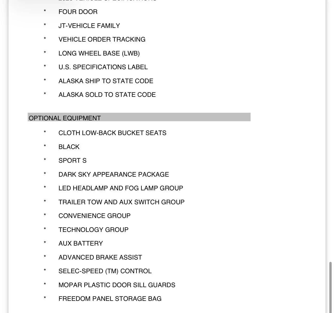

Check your window sticker. If you have a factory installed receiver, you should have a factory Tow Package, which gives you a 6k pound towing capacity with an automatic transmission.
Just looked at my build sheet and it seems I have the factory Tow Package, so that bumps my tow rate up a bit. Not that I want to get anywhere near that limit though. LOL
