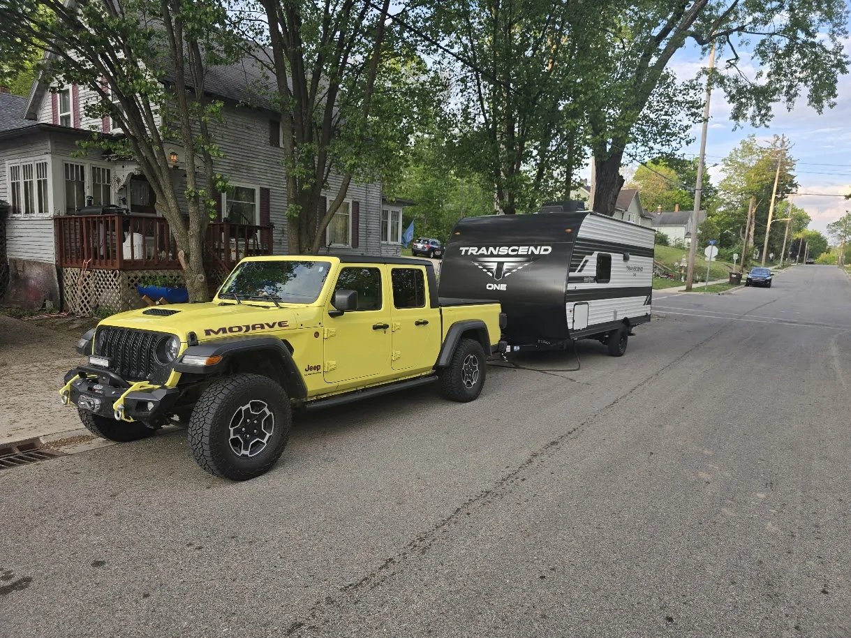

Nope, that's pretty much how it tows.
Hills in Northern Michigan are smaller than from TX to MO, but I would have to slow down on the larger hills to keep my oil temps in check. Lot's of rpm, not much beyond 6th gear, even geared down to 4.88, just did the same thing in higher gears lol.

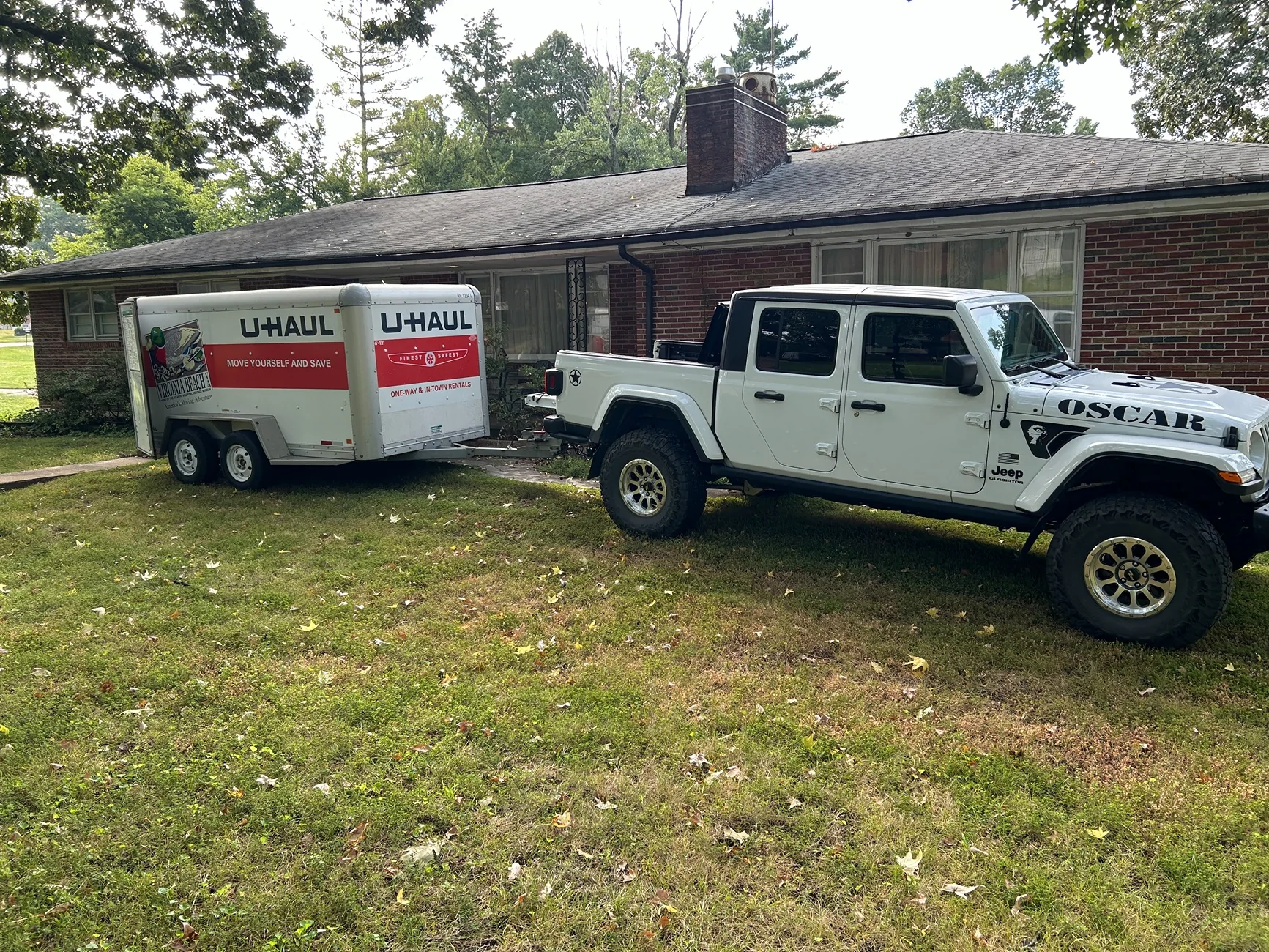

Pic for reference
Jeep Gladiator Another towing thread....sorry... IMG_2842
