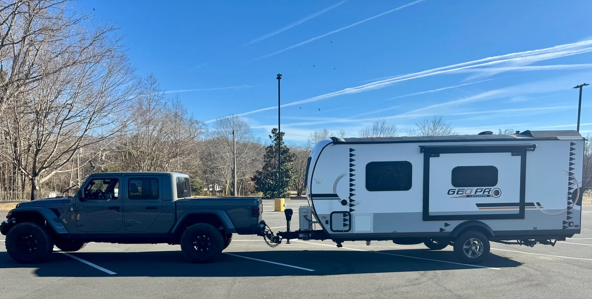

A little late to the chat but here’s my towing setup, it is the diesel. I am very experienced towing all kinds of vehicles and trailers. This combination I’ve towed for over 30,000 miles. I regularly live in the left lane doing 70-80mph passing people. Colorado mountain passes in Summer do limit speeds 1/2-3/4 of the way up but every vehicle I’ve towed at 75% of max GVWR has so I’m not sure I’d knock it for that
Jeep Gladiator Another towing thread....sorry... IMG_3220
