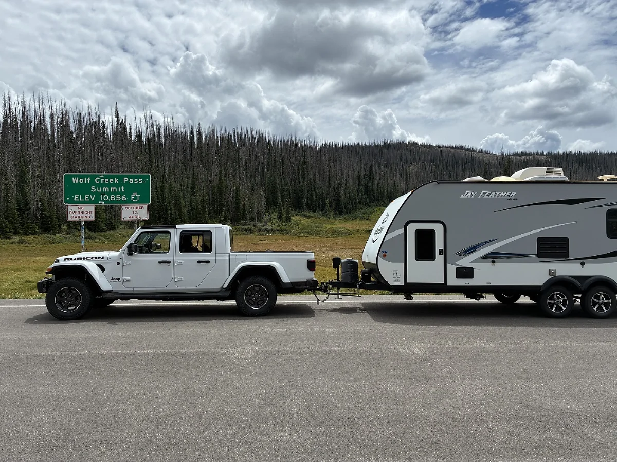

My set up...'20 Overland, stock (ordered 5/19, delivered 7/19). Trailer: 27' Vantage Sonic SN220VRB, 5,100 lbs with all we want or need, ~500 lb tongue weight, BlueOx WDH, Tenkonsha Primus IQ brake controller. Hitched up no WDH, 1 1/2" drop in rear. Hook up the WDH, only 3/4" drop. Shift manually, cruise at 65 MPH in 7th at around 2,100 RPMs, drop to 6th or 5th on occasion to maintain at least 55 MPH on grades, RPMs around 3K in 5th. Mileage: 10 through the Poconos in NE PA going to New York, 13 towing to coastal areas on the east coast...yeah, beaches. Handles my trailer very well.

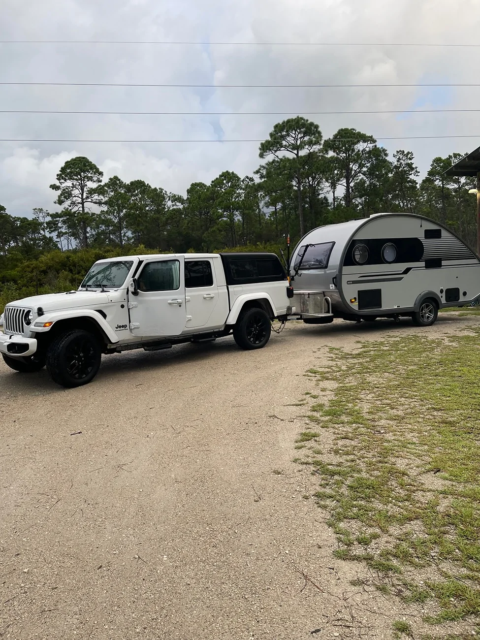

Pic for reference
The Grouch looks good.
On another note. You'd want more tongue weight if you were to tow again. 10% is bare minimum, and that's of the loaded trailer weight. 10 to 15% is recommended tongue weight.

I agree but I had the front packed side to side and didn’t want to stack on top of my parent’s 60+ year old furniture.

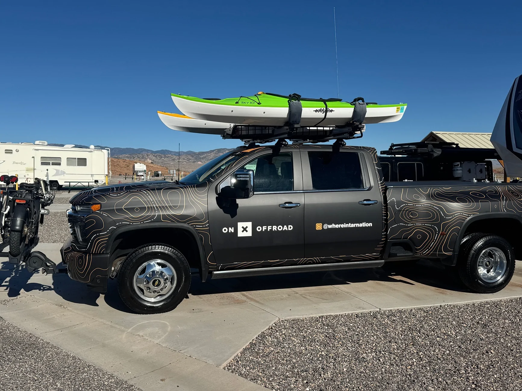

I’m sorry. No matter how hard I try I consider the Gladiator wishful thinking as a tow vehicle. I love mine, but when it comes to towing I use a vehicle that’s made for it. And get twice the fuel mileage pulling a weight that maxes out a Gladiator.

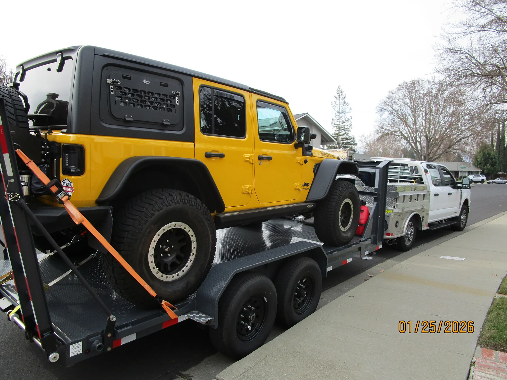

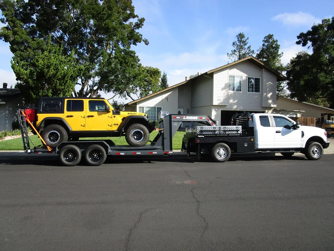

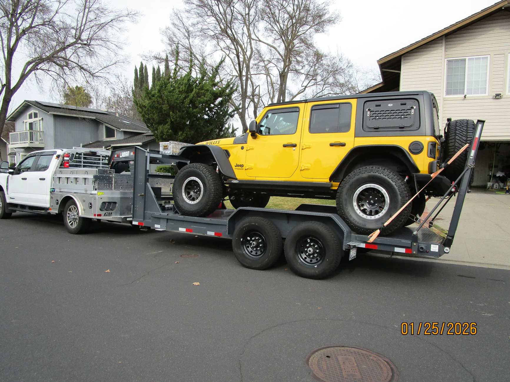

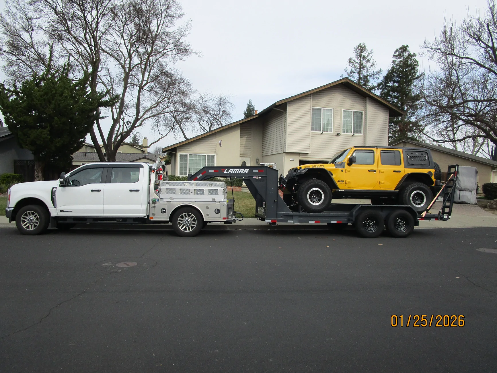

This is the way I tow. With my 2025 f250 diesel I can do 80mph at 7000ft altitude 7% grade pull 9000lbs. Before I had a 2020 f250 6.2 gas. same hill struggling to do 40 to 50mph.
Jeep Gladiator Another towing thread....sorry... 25 F250 & TRAILER  (1)
Jeep Gladiator Another towing thread....sorry... 25 F250 & TRAILER  (2)
Jeep Gladiator Another towing thread....sorry... 25 F250 & TRAILER  (7)
Jeep Gladiator Another towing thread....sorry... JEEP ON TRAILER (12)
