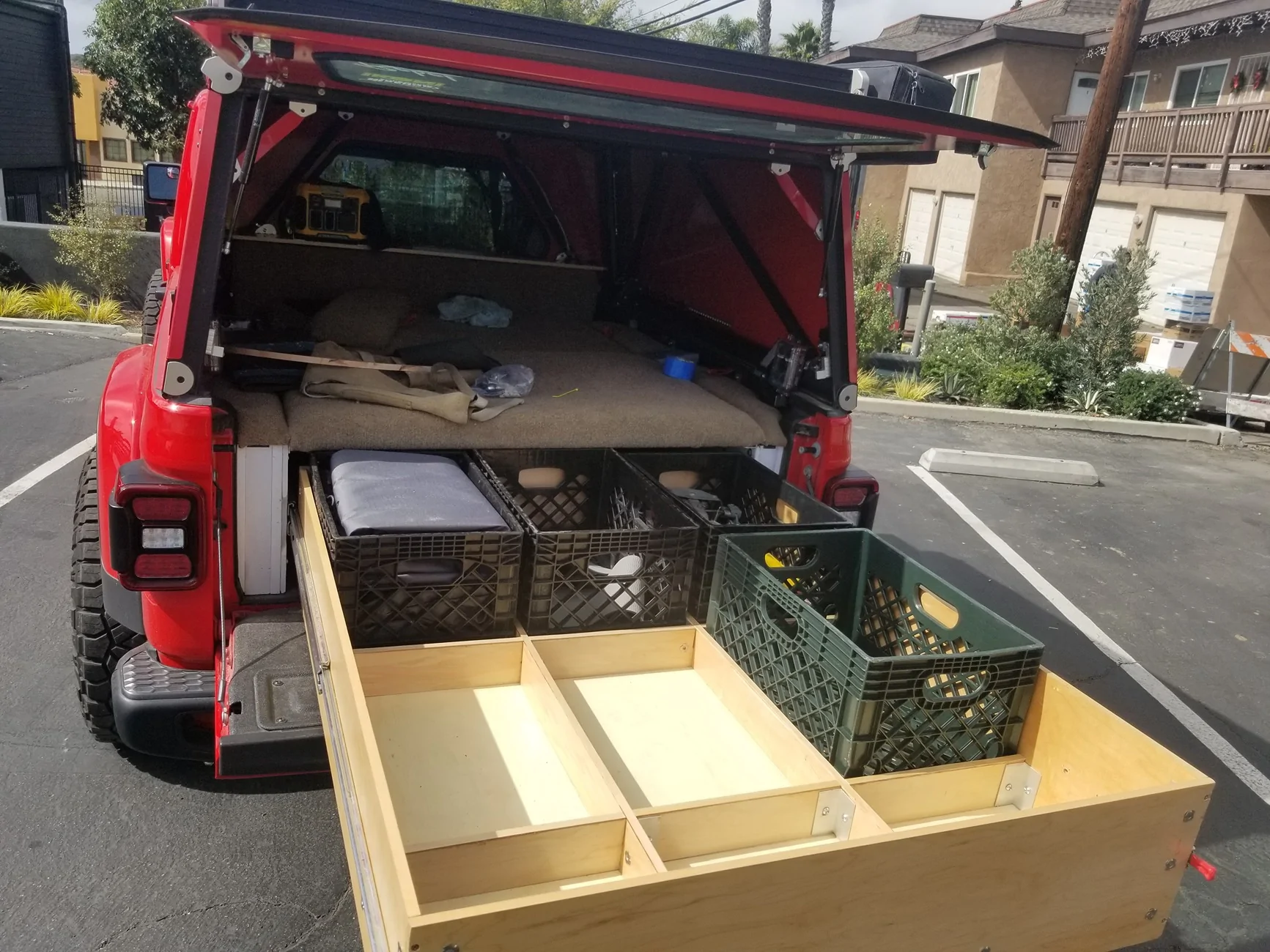

I'm looking at installing nutserts on the elevated ribs of the JT bed floor. I would use these as mounting points for a bed storage system (similar to the goose gear bed plate). Any reason I shouldn't?

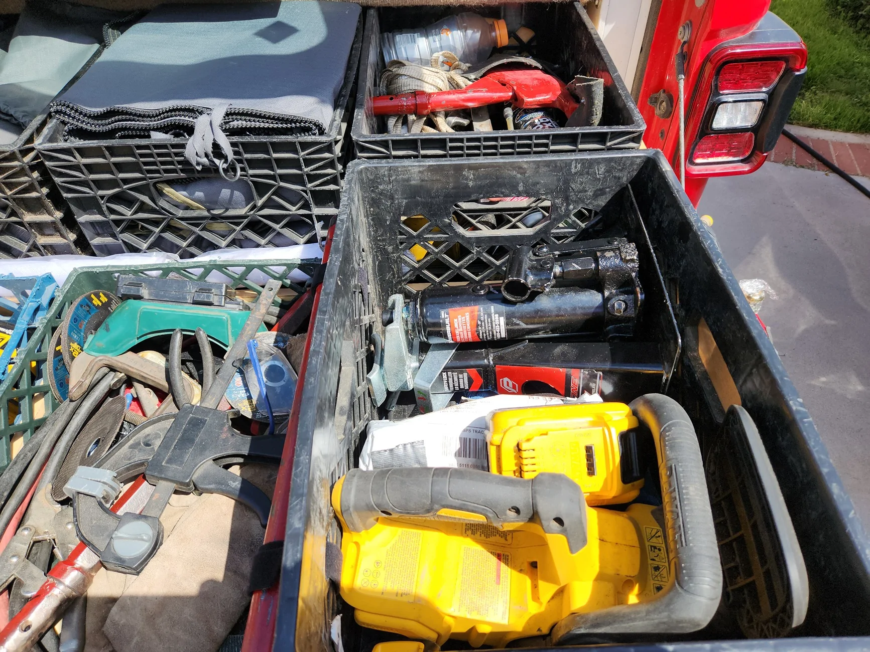

I built my drawer system with Rivnuts. My Gladiator has been up to the Artic Ocean twice with 60,000 towed and driving Miles. No issues at all. Those Alaskan and Canadian roads put your rig through the ringer. Real happy with my rivnuts.
Jeep Gladiator Any reason not to install nutserts in bed floor? 20220221_112821
Jeep Gladiator Any reason not to install nutserts in bed floor? 20230510_144440
