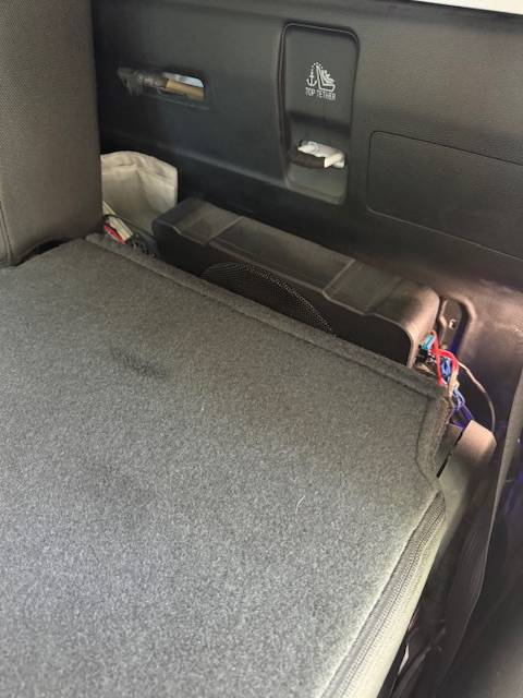

What kind of bass do you want? I have a Kicker 46HS10 behind the seat that fills the jeep quite nicely. Even with the freedom panels removed it still sounds great. It won't win any competitions but it does have some thump to it.

Thanks for the reply! I’m 43 and not trying to win no competitions either just have a little something would be nice. Do you have any pictures of your set up?

Not on me but I can take some when I get home.
I used to like (and still do I guess) bass that you can feel so I was always running a box with 10s or 12s under the seat (crew cab trucks). But this time I wanted something that wouldn’t take up cargo space as I wasn’t wanting a toolbox on the gladiator. This thing filled the spot just right.

I could probably make the wiring a little neater but ehhhh

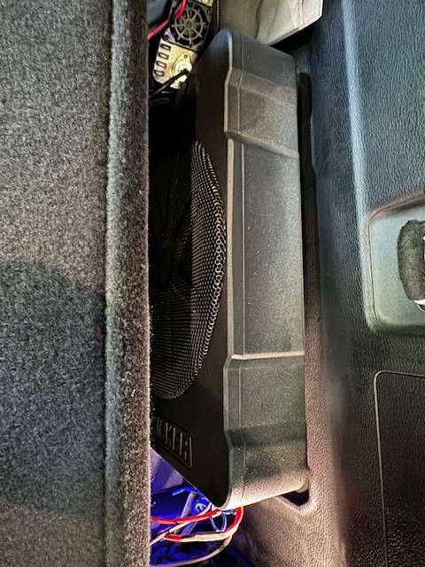

There is plenty of room back there for it!
It sits perfectly in that plastic tray that’s there. I did have to pull that net out (and the plastic trim that holds it in place) to get it to fit.

Sweet! Did you run your power right off the battery?
