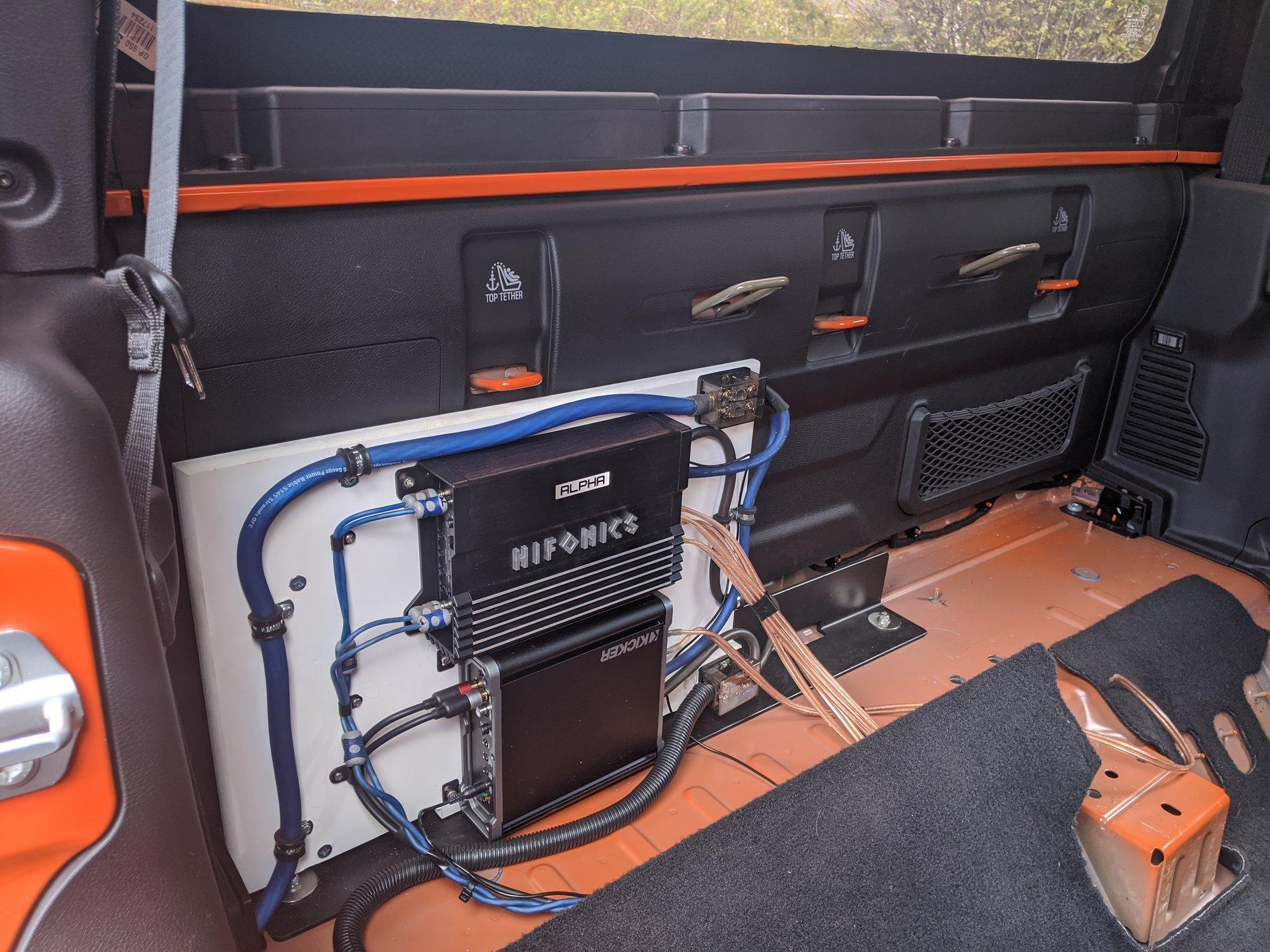

The angle iron (its way over kill, but what I had on hand) is drilled and place over the factory studs that hold down the lower cargo tray(removed) then just fender washers and 2 nuts
The PVC board is bolted to 2 peices of flat stock that I welded to the angle iron.
This bracket is way more than needed for an amp rack, but I previously had a powered sub woofer installed in this location and that was much heavier

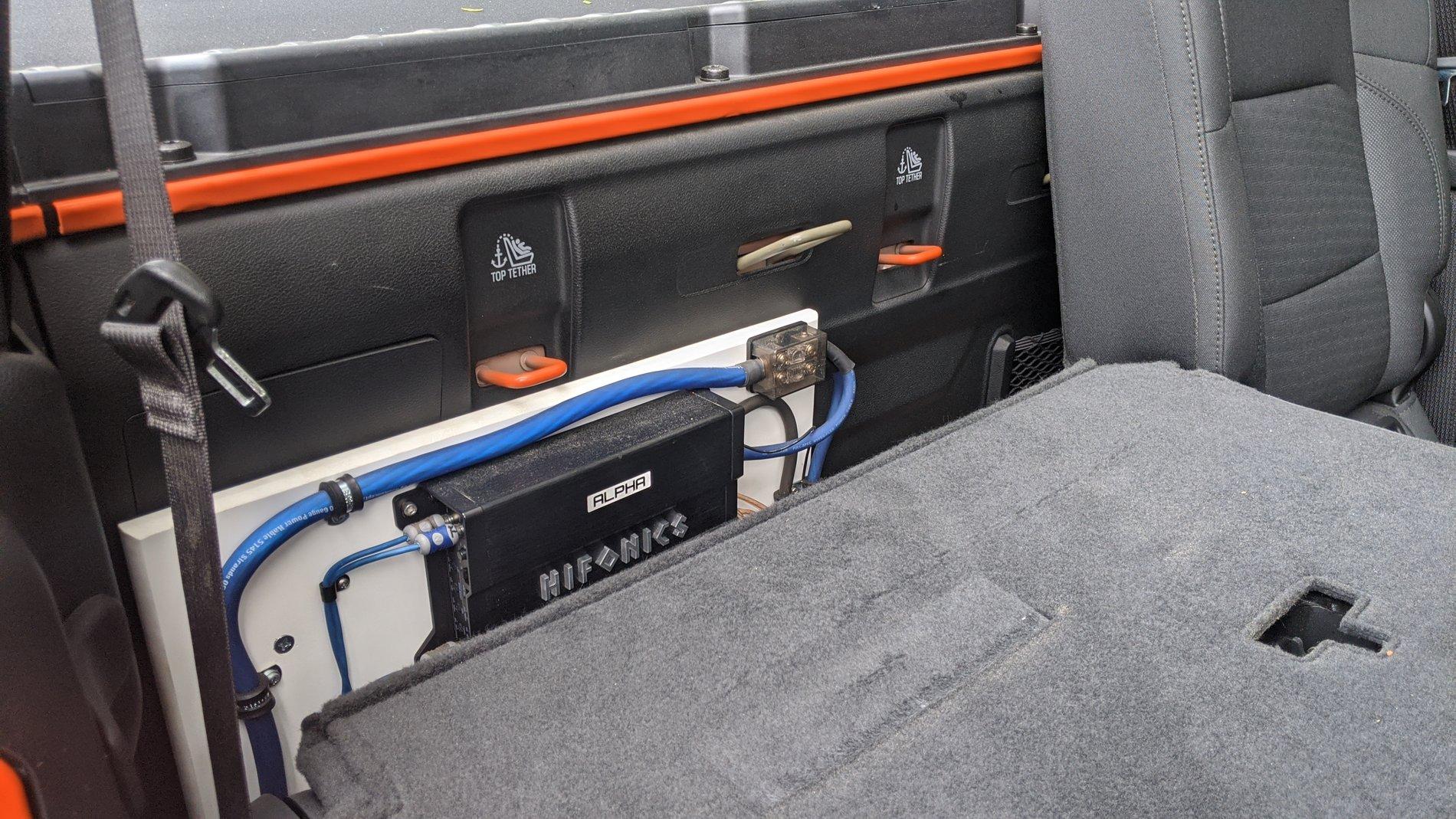

Thanks for the info. Would you mind posting a picture of what it looks like final with the seats installed and folded down? I think I’m going to steal your idea! I’m assuming the lower panel/cargo tray separates easy from the main rear plastic panel that’s in your picture?

Yes the plastic cargo tray come off easily

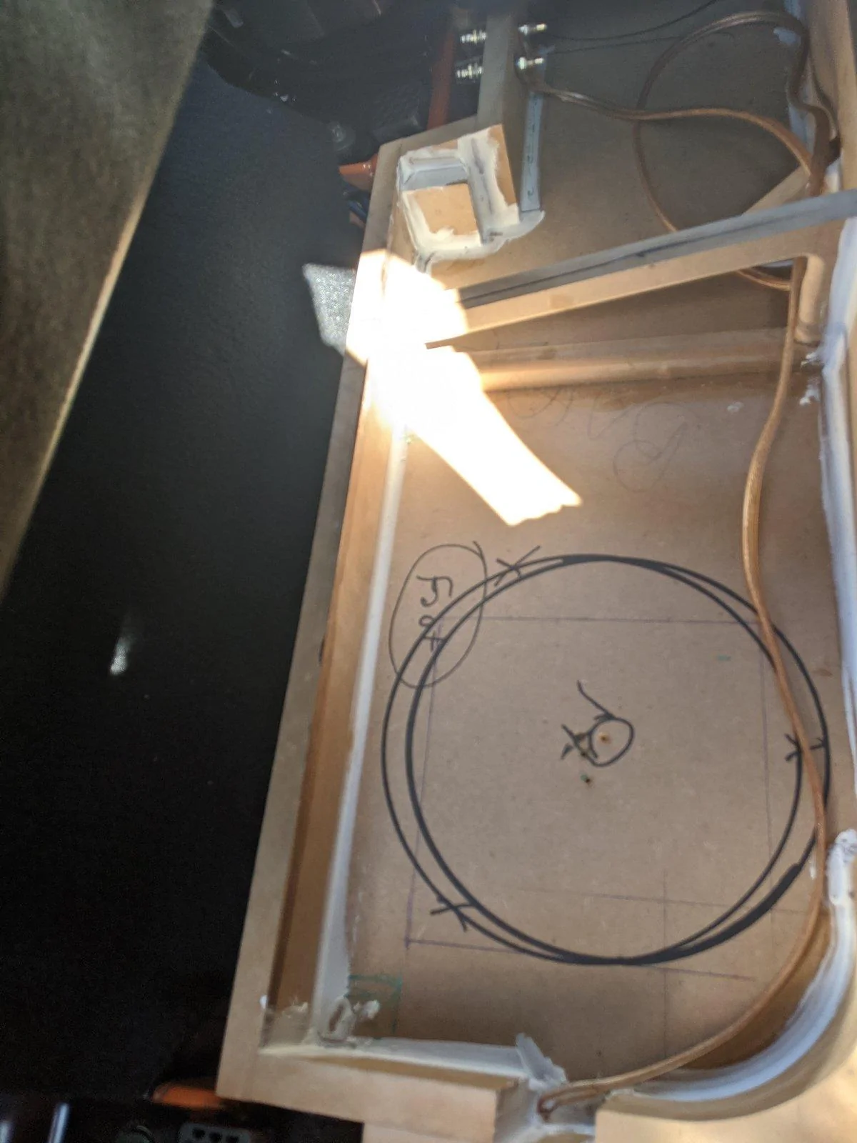

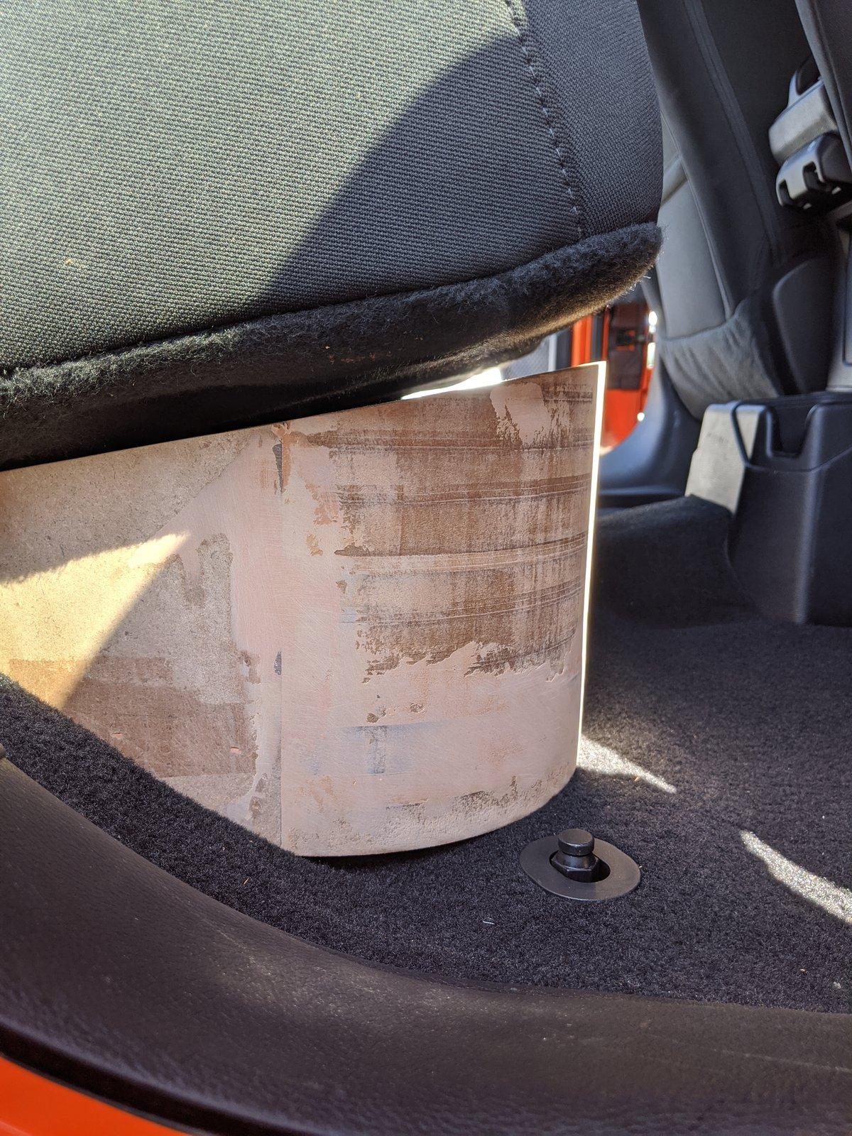

I originally planned L7T 10s (shallow) but once I actually built the box it was just a little to tight for comfort,(1.1ft³, giving each sub just over .5ft³)
So i went with L7T 8s(shallow) and I'm VERY HAPPY.
The sound from these little guys is unbelievable. I have never turned the remote knob over 50% and they hit HARD & CLEAN.

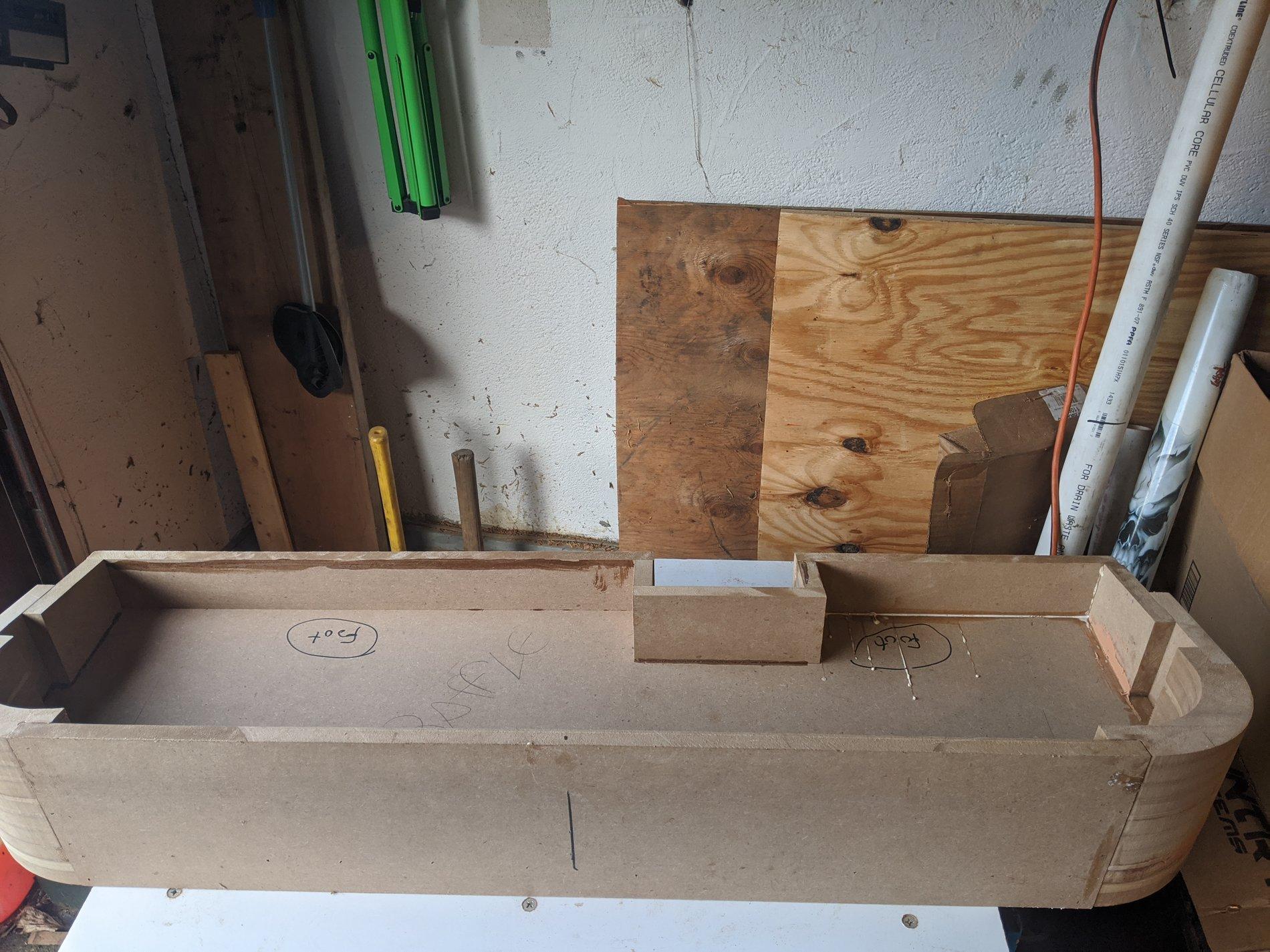

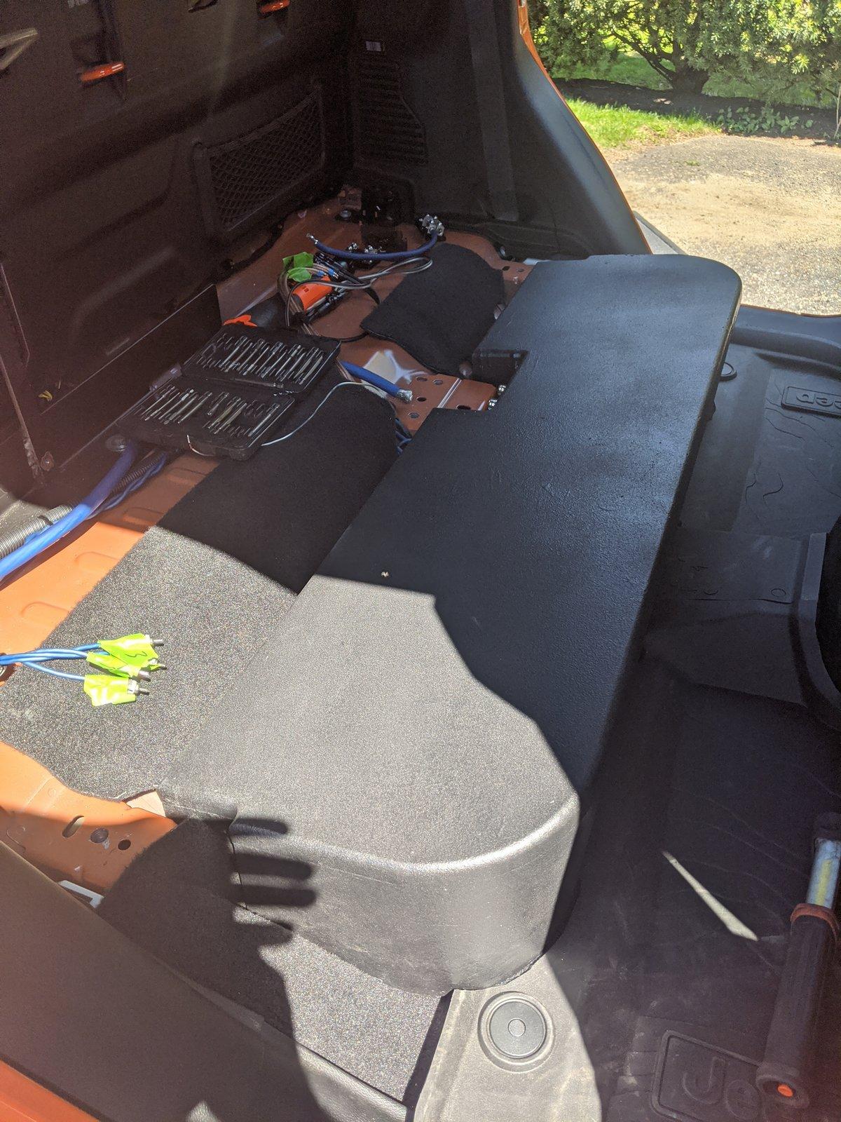

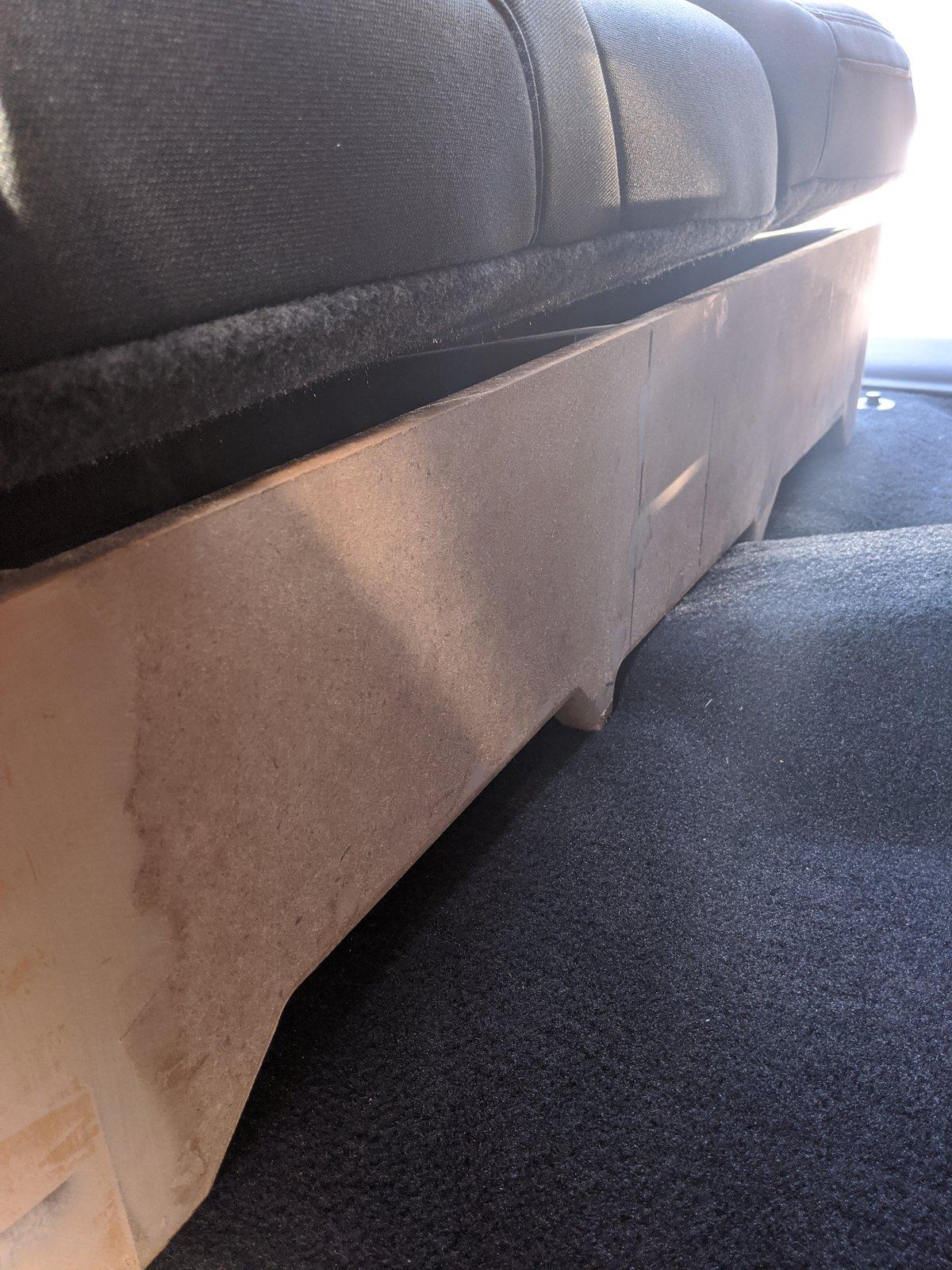

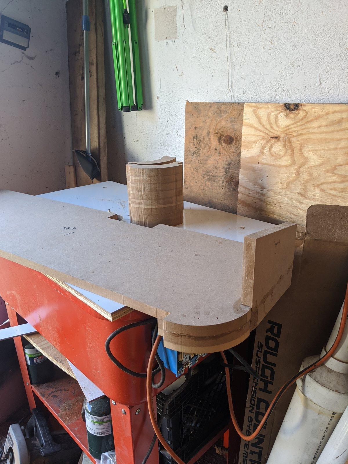

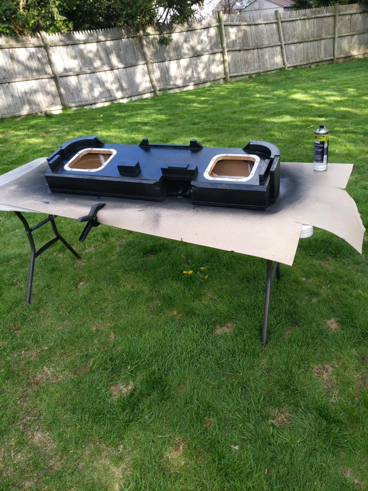

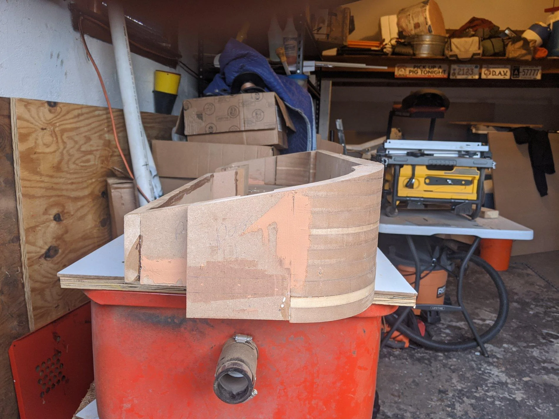

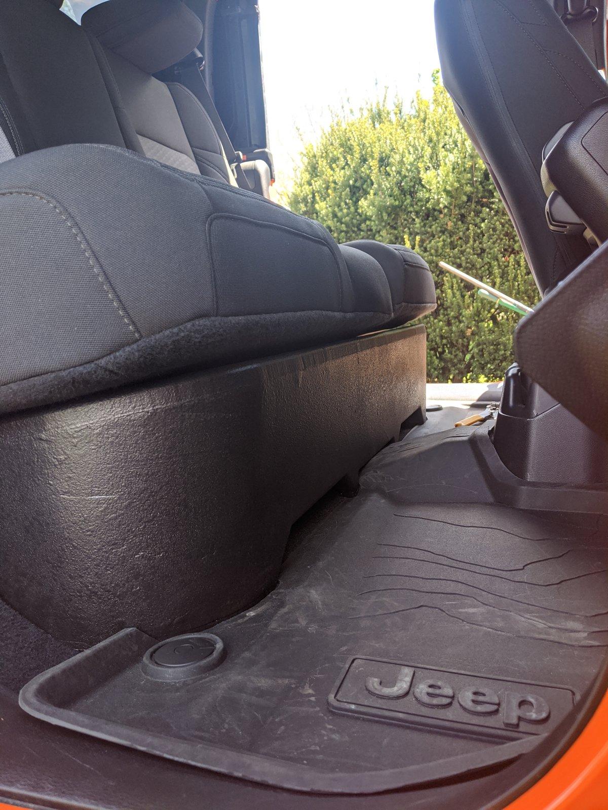

Don't judge to harshly. This was my first time building a sub box, or really anything out of wood(I much prefer metal). It took me way longer than I expected and didn't come out 100% perfect but I think it's good enough.
Built from 3/4 mdf, houses 2 kicker L7T 8" (800w RMS total). Internal seams sealed with silicone caulk. Outside coated in raptor liner.
It's 5 years later but any dimensions for the cuts? 😆
