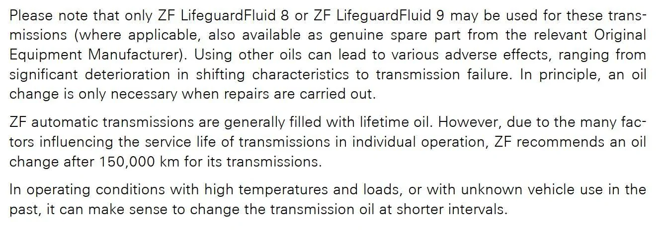

Yeah, test it.
A lot of highway miles or longer drives it's probably fine (ZF says 93,000 miles/150,000km) but if it's been off-roading, towing anything of substance, that sort of thing, it's probably time.

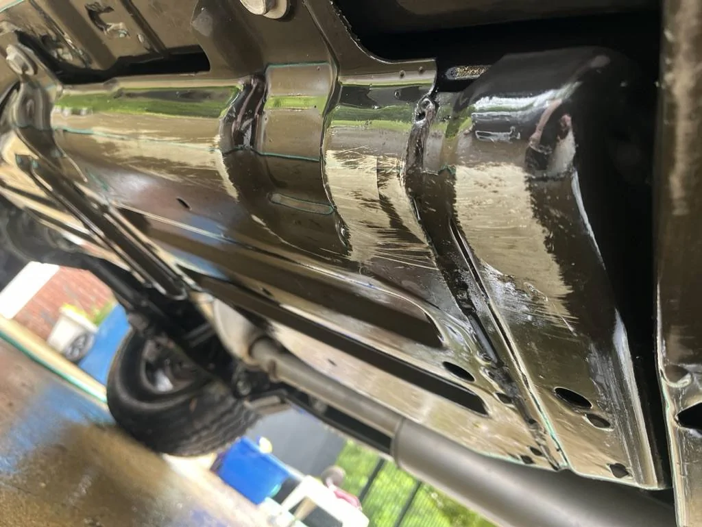

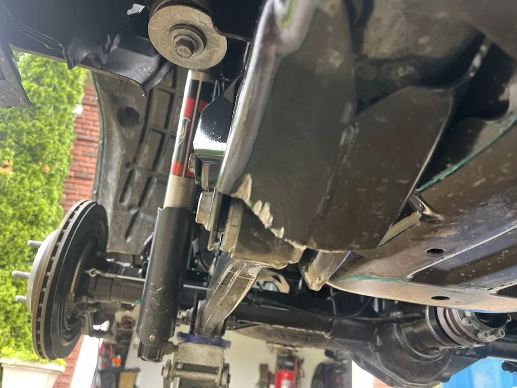

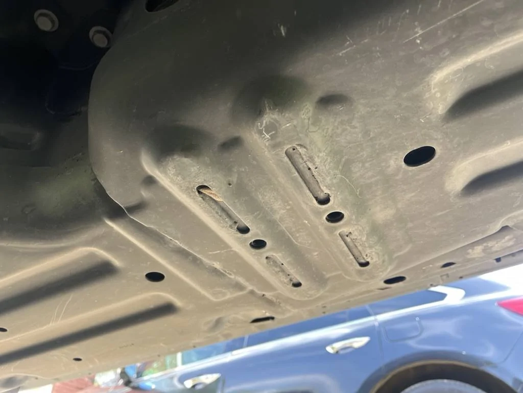

These are before and after pictures of my underneath. Looks Like I'm the first off-roader
Looks like some lca skids would help.
That's just love pics 📸 I'm off road everyday. Love the factory plates underneath saved my rig plenty of time . Nothing some sandpaper and a can of rustoleum can't fix.

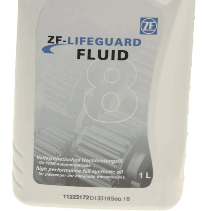

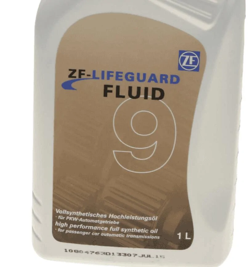

I believe the 8/9 is full synthetic.
You also have to be watchful of the differences between GERMAN rules labeling and US rules. Some things in the US labeled as full synthetic will not pass muster in Germany and can't be labeled that way.
Me - I don't care as long as it's ZF because they have it specifically formulated for their own transmissions. So what can be wrong with that? ZF fluid made for that transmission.
Even draining the converter leaves a lot of fluid in the clutch packs, valve body and so on.
I know a lot of people will say "but it's the same pour point, the same viscosity and various things easily compared - however, that's starting numbers. It's also the chemistry that matters (ask the motor oil geek)
Viscosity can change over time and use. Will it hold?
Will all of the other attributes match over time and wear?
Maybe.
Will the chemistries of each conflict with each other and end up cutting wear protection or other attributes of the fluid? I don't know - does anyone? Will I gamble it will be fine?
If you watch the motor oil geek talk about changing oil brands, types, viscosities and so on (and that's what this is) - he always does it twice. He'll change the oil to the new oil run it, change it again to the new oil.

What is a ICS skid
LCA. Lower control arm. There are several bolt through options from places like rock hard 4x4 that protect your brackets. Your damage is cosmetic at this point, but it won’t stay that way for long.

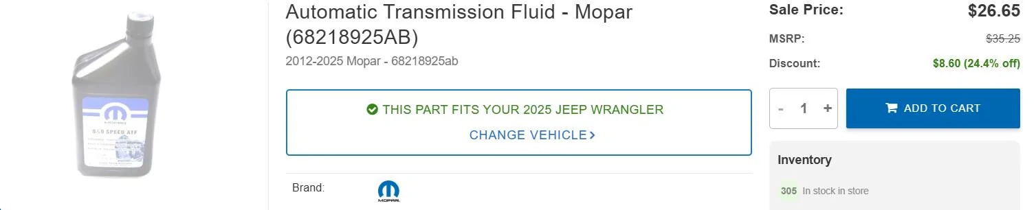

He’s full of shit. Retail for mopar fluid is about 35 per quart, not 45. And I bought 8 quarts of it two days ago, at a dealer, for 26.50 per quart. Run away. That dealer is a liar and a crook.

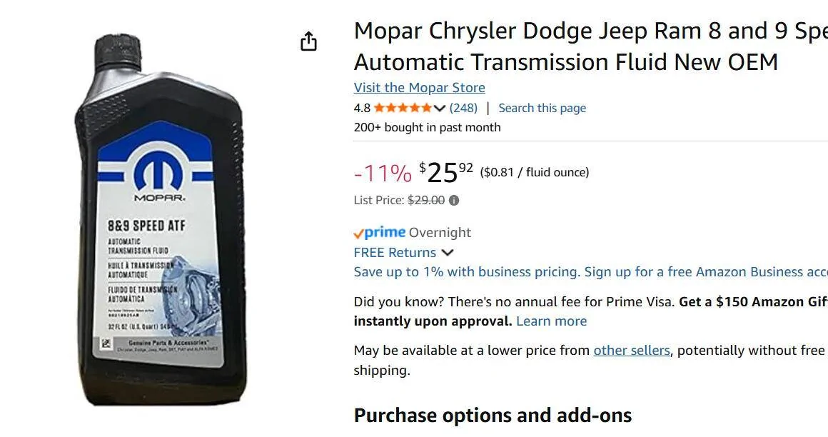

Yes, about 35/quart at a dealership even!
Jeep Gladiator Anyone else use this ATF in their Gladiator 8-speed? 1749925345268-2r

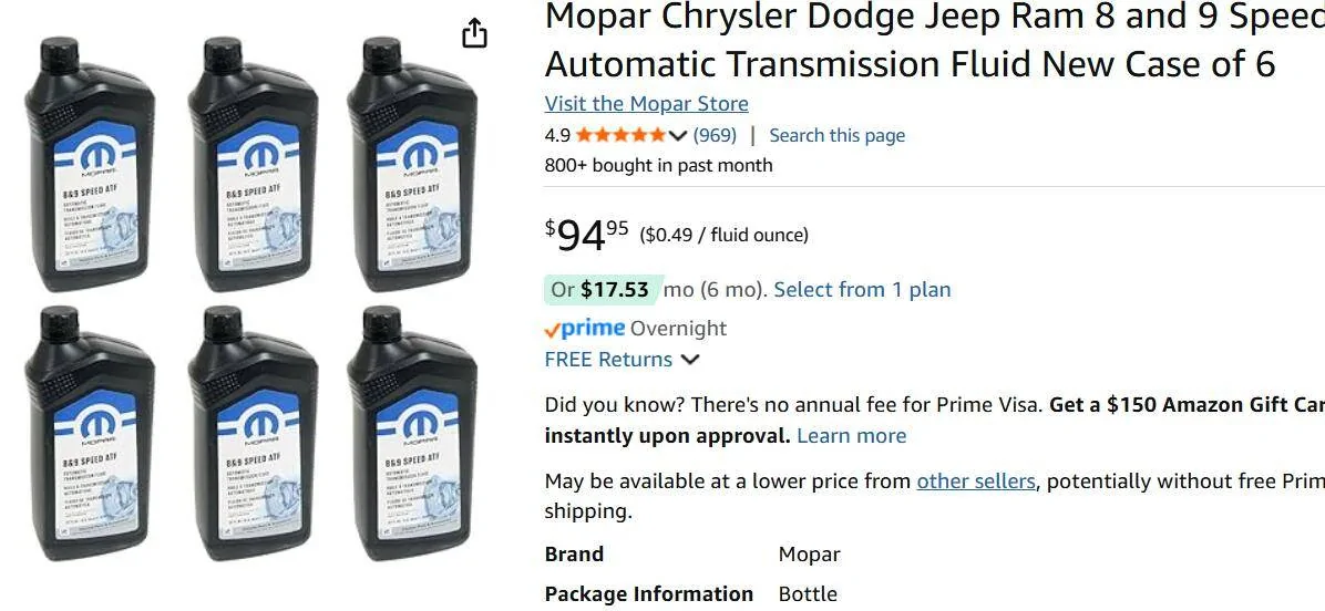

Cheaper on Amazon..........
Jeep Gladiator Anyone else use this ATF in their Gladiator 8-speed? 1749924881510-1x
OR, even cheaper than that.....
Jeep Gladiator Anyone else use this ATF in their Gladiator 8-speed? 1749924999077-km
Again, I don't get the trying to save just a bit of money, but still doing changes so very often on the other hand.
