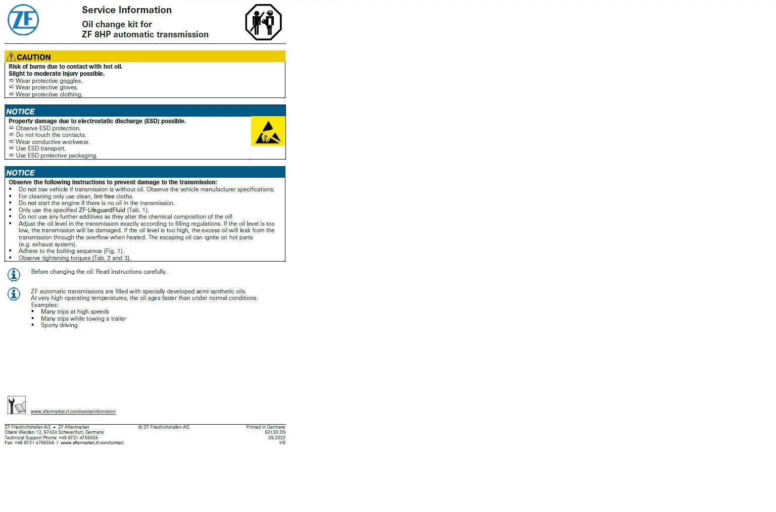

4. Service Information, Oil change kit for ZF 8HP automatic transmission
Full document: SOURCE_GladiatorPilot23_FILE_NAME ZF oil change kit.pdf (attached at end of this post) or c6f6d6c4-a254-11ef-a30a-00505690da53.pdf (latest version of same file on ZF website; if link is broken, please use attachment)
Page 1 of 6: On this page, see three causes of very high operating temperatures (and the need for much shorter service intervals):

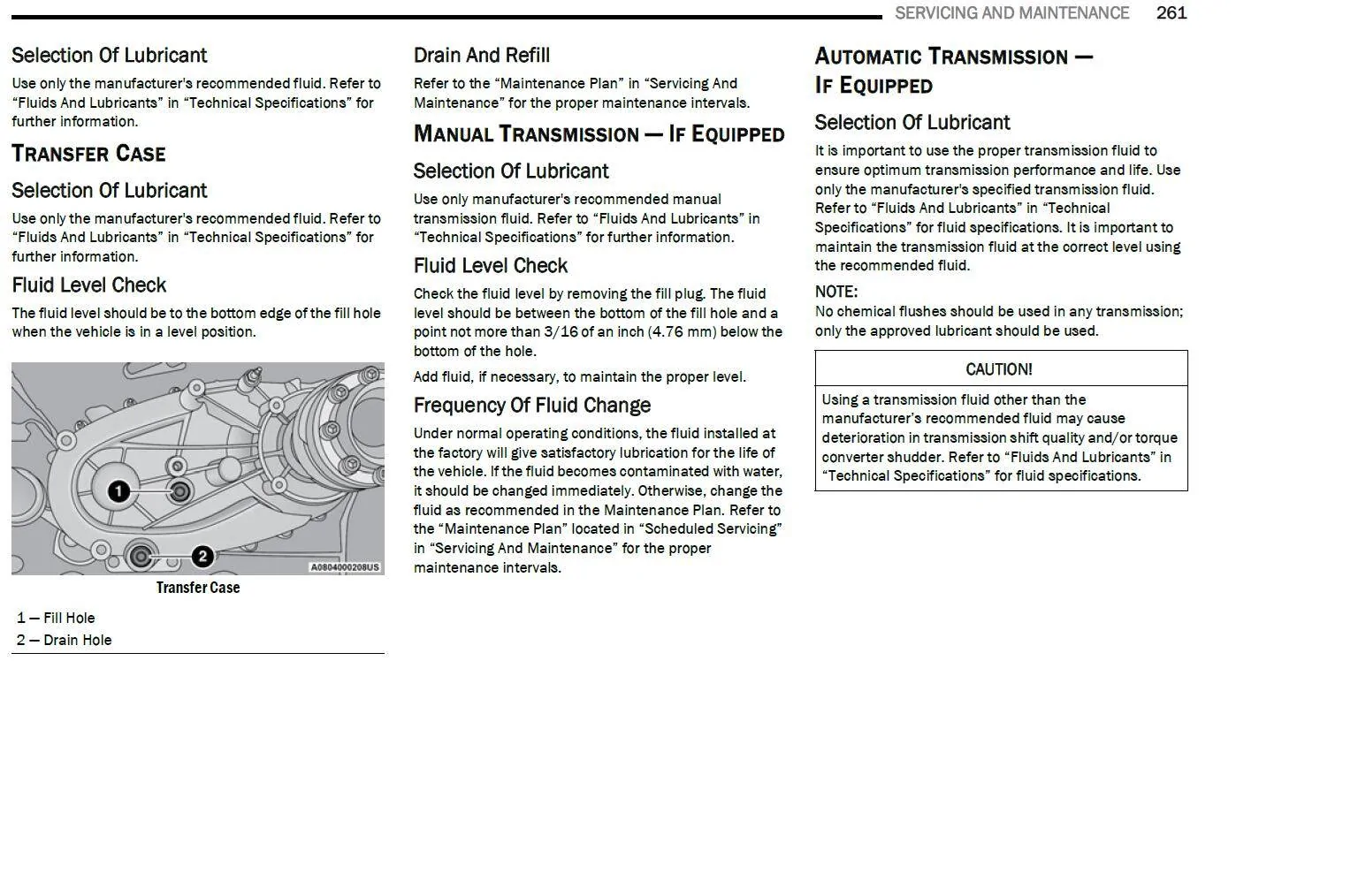

5. Owner's Manual - Page 261 (1st of 3 excerpts from online version of 2020 Jeep Gladiator owner's manual)
Link to owner's manual: https://www.mopar.com/en-us/my-vehicle/vehicle-information.html?redirect=om
>>> Click or download this image to zoom in on it:

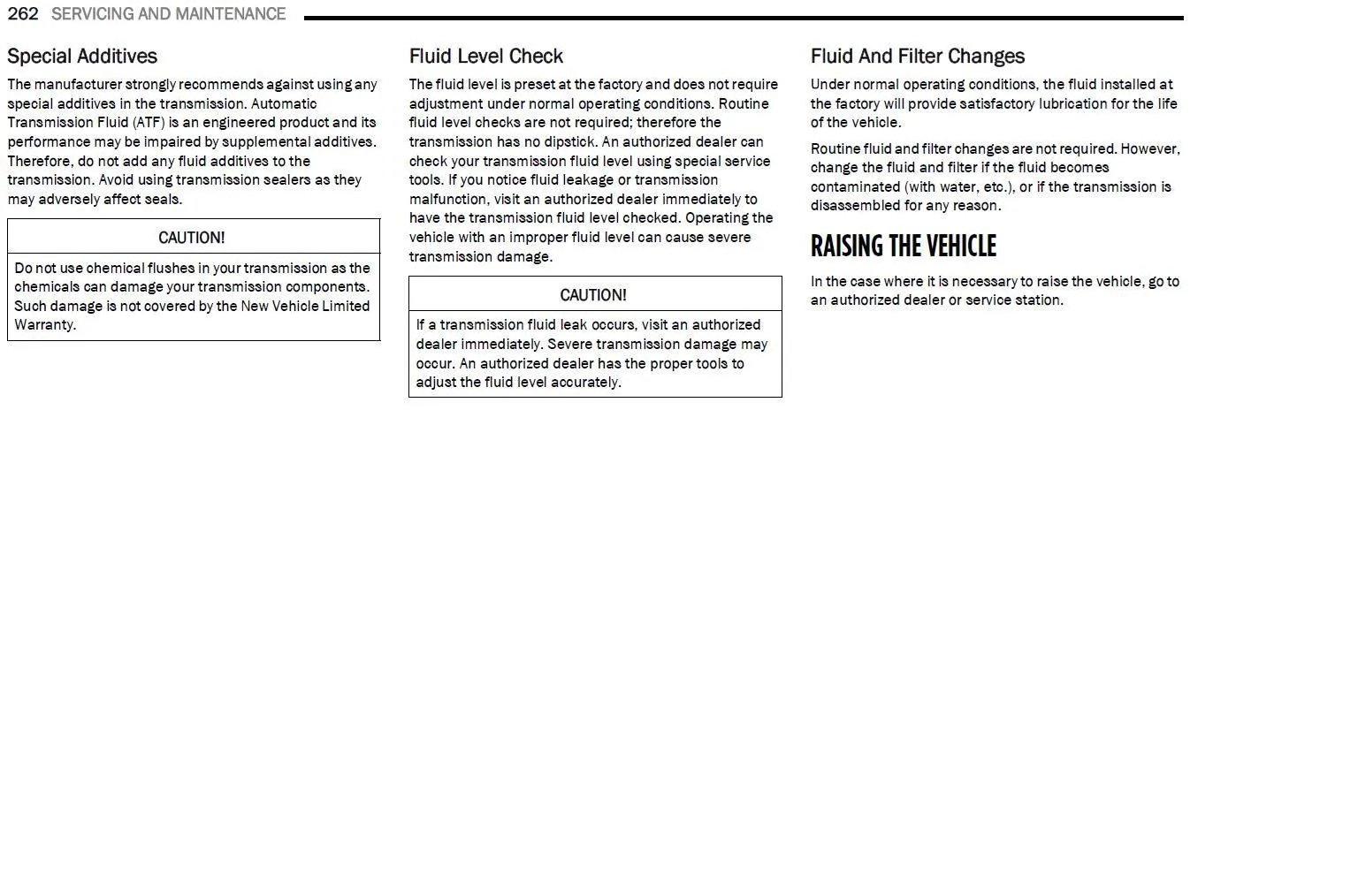

6. Owner's Manual - Page 262 (2nd of 3 excerpts from online version of 2020 Jeep Gladiator owner's manual)

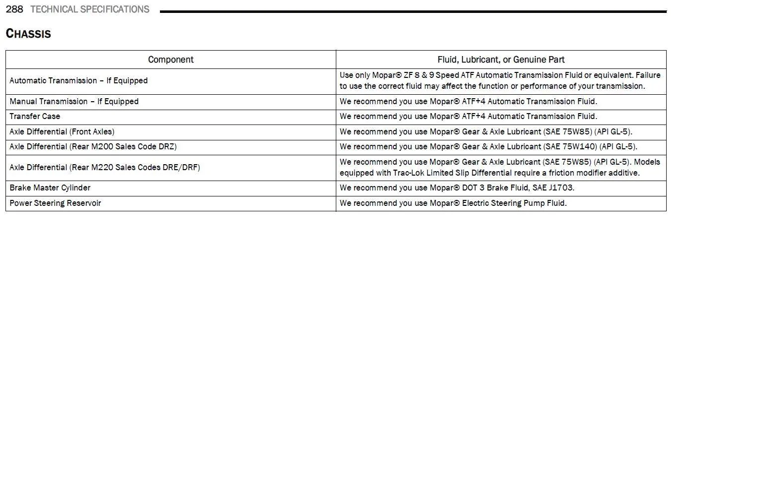

7. Owner's Manual - Page 288 (3rd of 3 excerpts from online version of 2020 Jeep Gladiator owner's manual)

- For fluid level, "an authorized dealer can check your transmission fluid level using special service tools" (see doc #6 in this post, above)
- Also see SECTION 12 - ATF LEVEL CHECK in a separate post on pan drop instructions
- For fluid quality, the owner's manual does not say anything about checking fluid quality

Option 3: Instructions from ZF
- The attachment at the end of this post (also on the ZF website as c6f6d6c4-a254-11ef-a30a-00505690da53.pdf, and entitled Service Information, Oil change kit for ZF 8HP automatic transmission) is a six-page document, published in March 2022, that describes the ATF Level Check procedure (part, but not all, of a pan drop) using tables, process flows, and schematic diagrams; this file is also described as item #4 in the first section of this post, ZF Reference Documents

Direct link to updated version of six-page attachment to this post (entitled Service Information, Oil change kit for ZF 8HP automatic transmission, file name on zf.com c6f6d6c4-a254-11ef-a30a-00505690da53.pdf; earlier version attached to this post as SOURCE_GladiatorPilot23_FILE_NAME ZF oil change kit.pdf):
