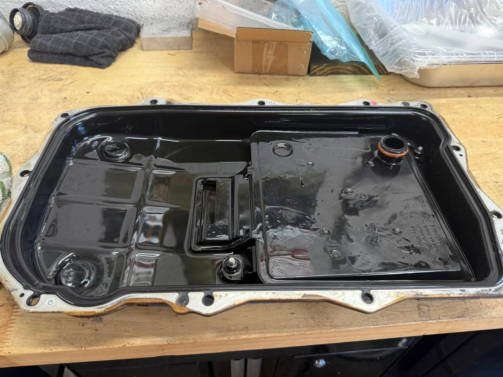

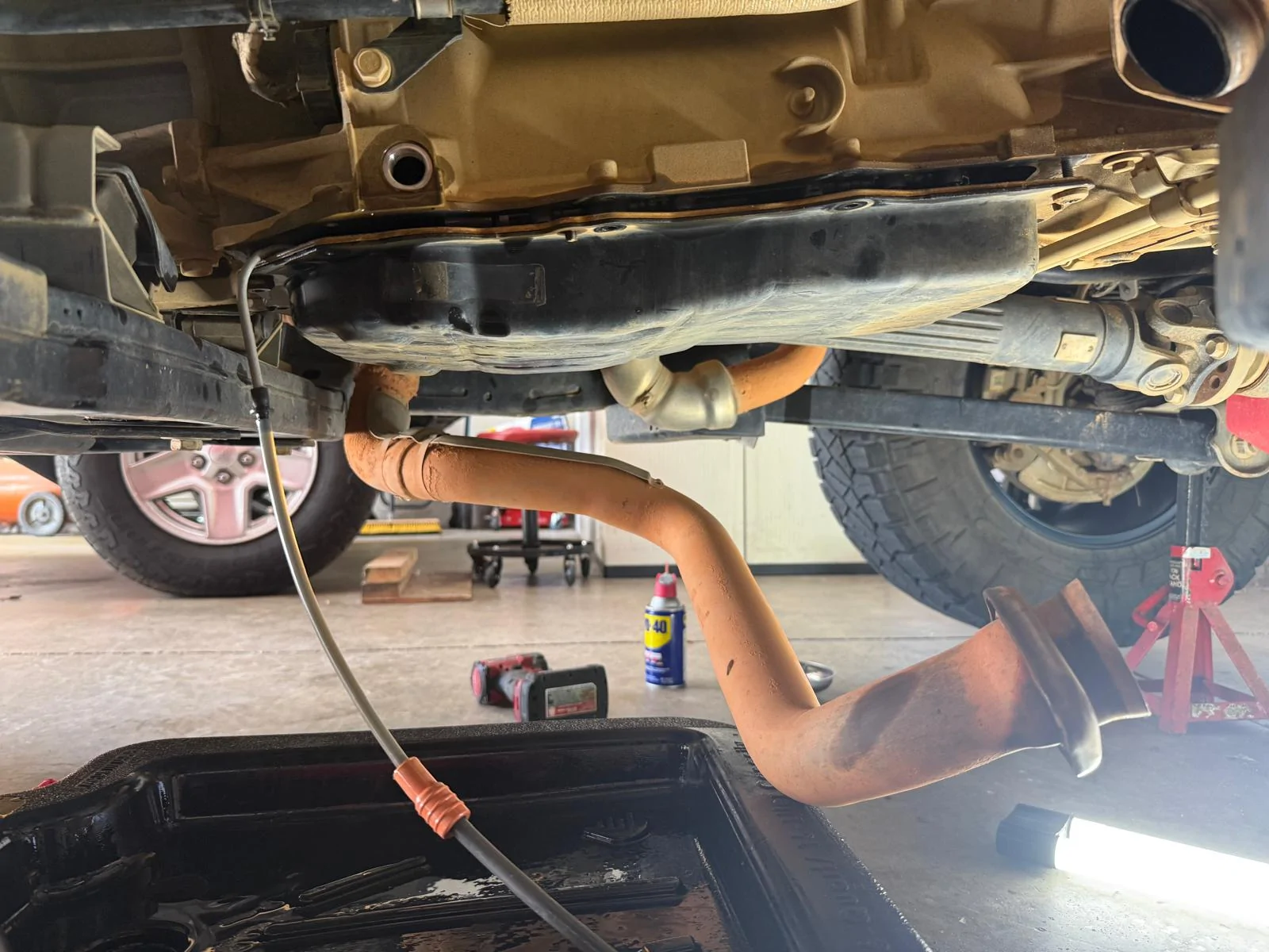

Working on this project today. I took the advice of others and pumped fluid out of the fill hole. I went an extra step. I used a piece of bent brake line to make a pickup tube. Used that in the fill hole until I couldn't get anymore out. Removed all but 4 trans pan bolts on the corners. Lowered the pan about 1/4" and stuck the pickup tube through the gap. I was able to get all but about 1/2 cup of fluid out. Cool thing is after the first pump from the syringe stye fluid extractor, the fluid will syphon out. It's not very quick that way but is sure is easy. I did some other chores while waiting for the fluid to extract itself. I spilled less fluid than I did changing my SQ5 8HP trans fluid and it has a drain plug. :CWL:
Siphoning the fluid out of the back corner of the pan.
Jeep Gladiator Pan Drop / Drain & Fill Instructions for ZF 8HP50 or Chrysler TorqueFlite 850RE Automatic Transmission WhatsApp Image 2026-04-04 at 4.25.56 PM
How much was left in the pan once removed.
Jeep Gladiator Pan Drop / Drain & Fill Instructions for ZF 8HP50 or Chrysler TorqueFlite 850RE Automatic Transmission WhatsApp Image 2026-04-04 at 4.25.56 PM (1)

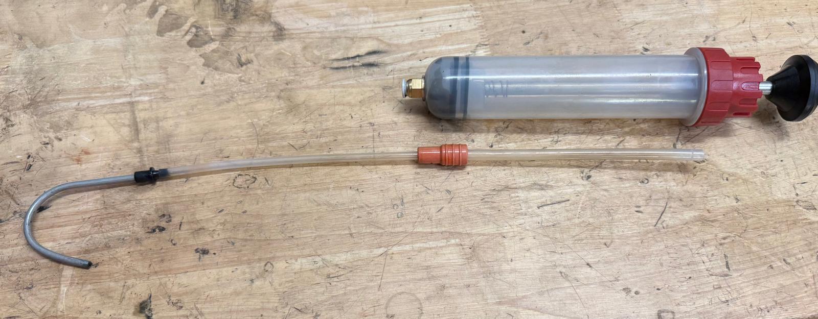

The tool.
Jeep Gladiator Pan Drop / Drain & Fill Instructions for ZF 8HP50 or Chrysler TorqueFlite 850RE Automatic Transmission WhatsApp Image 2026-04-04 at 5.10.35 PM
I dropped the exhaust down because I could. It's a Florida Jeep so the bolts came out by hand once loosened.
This is my first reply to Gatorac's post. Click here for the second reply.
Nice! I will add this technique to the original post, with credit, as long as it is approved by the committee (one person, @Maximus Gladius).
Update:
The advice on using a J-shaped pickup tube to drain the oil pan has been added to the original post. Please see the following items in each section:

The tool.

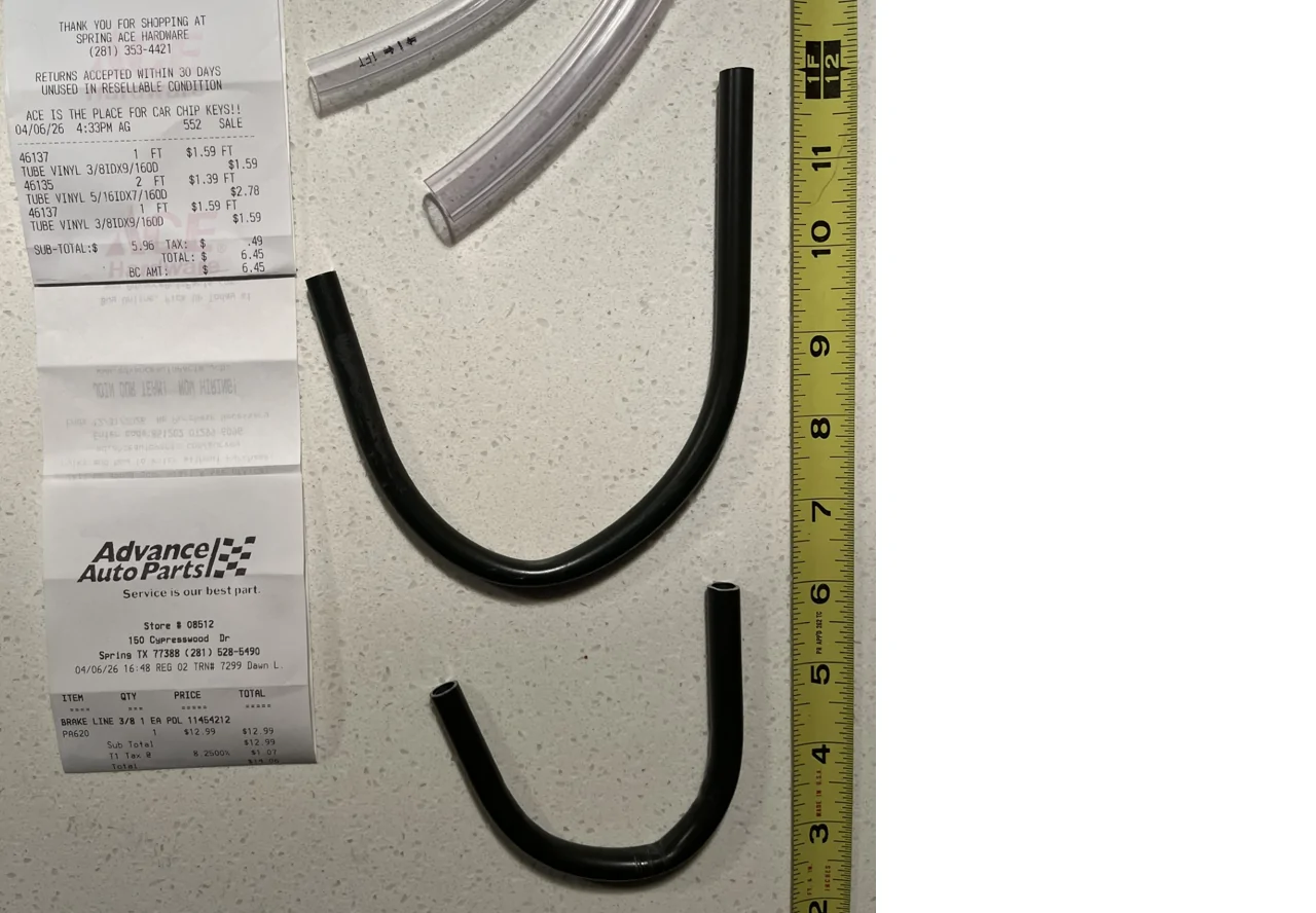

This is such a good solution that I decided to share some prices.
  • Brake line: Poly-Armour Domestic PVF Steel Brake Line, 3/8" x 20"; Part # PA-620, $12.99
    • I made two J-shaped pickup tubes from this 20" brake line: 12" and 7.5" (the larger size is probably about right)
  • Tube bender (borrowed at the store): Performance Tool Tubing Bender Up To 3/8" OD; Part # W86013, $20.99
    • There are better tube bender options
  • Optional: Additional plastic tubing
    • Vinyl tubing 3/8" ID X 2' @ $1.59/ft = $3.18 (this is 12/32" ID)
    • Vinyl tubing 5/16" ID X 2' @ $1.39/ft = $2.78 (this is 10/32" ID)
- Either one of the plastic tube sizes should fit, depending on the brand of syringe that you buy
- On a separate note, 11/32" ID appears to be the correct size for an ATF108 adapter (11/32" ID plastic tubing is difficult to find, even online, but it should be included with a 1500 cc automotive syringe)
- If you are concerned about scratching the oil pan, place a short piece of plastic tubing over the end of the metal pickup tube
I'm still learning how to use a tube bender:
Jeep Gladiator Pan Drop / Drain & Fill Instructions for ZF 8HP50 or Chrysler TorqueFlite 850RE Automatic Transmission J-shaped pickup tube and plastic tubing

  1. Extract ATF, using 200 cc syringe (for extracting ATF), by inserting narrow plastic tube into the fill hole, down and toward the rear of the transmission, until it touches any component in (or the bottom of) the Transmission Oil Pan; do not force plastic tube to the bottom; this is the drainable ATF located below the fill hole (3.5+ quarts)
  2. Extracting some of the ATF before dropping (removing) Transmission Oil Pan is optional, but doing so allows for less splash when removing the pan

Recommendation: Before continuing with this part of the process, consider using a J-shaped pickup tube to extract almost all of the ATF remaining in the oil pan. This is optional, but it will reduce mess. Credit goes to @Gatorac for sharing this technique. Start by keeping the bolts in the four corners loosened, but not removed, to create enough space to insert the tube. The J-shaped pickup tube should maintain contact with the bottom of the oil pan.​

  • pan drop 090 detached MOPAR transmission oil pan & gasket (MOPAR 68522534AA) before being completely removed credit Maximus Gladius 2025-12-30.jpg
  • pan drop 100 850RE automatic transmission with oil pan and gasket removed and flange (gasket mating surface) cleaned credit Maximus Gladius 2025-12-30.jpg
  • pan drop 110 inside of reusable MOPAR transmission oil pan with 2 magnets (MOPAR 68207788AA) & filter (MOPAR 68417054AB) intact credit Maximus Gladius 2025-12-30.jpg
  • pan drop 120 metallic sludge accumulated on 1 of 2 transmission magnets (MOPAR 68207788AA) credit Maximus Gladius 2025-12-30.jpg
  • pan drop 130 metallic sludge accumulated on 1 of 2 transmission magnets (MOPAR 68207788AA) credit Maximus Gladius 2025-12-30.jpg
  • pan drop 140 inside of reusable MOPAR transmission oil pan after cleaning shown with clean magnets & without filter installed credit Maximus Gladius 2025-12-30.jpg
  • pan drop 150 new fluid being installed thru fill hole after installing clean transmission oil pan & new gasket & new filter & clean magnets credit Maximus Gladius 2025-12-30.jpg

  22. Optional, but recommended: Automotive syringe with extension tube and capacity of 1500 cc, or 1.5 liters, such as VEVOR YS-0113
    1. A large syringe may be used to extract ATF from the Transmission Oil Pan using a J-shaped pickup tube
    2. On a separate note, if ATF adapter and 2-gallon fill pump are not being used, a second large syringe may be used to dispense/fill ATF; in this scenario, using a second large syringe will prevent contamination
  23. Optional, but recommended: A piece of bent (metal) brake line to make a J-shaped pickup tube (credit goes to @Gatorac for posting this technique)
    1. For brake line specifications, tube bending tool, and prices, also see my reply to Gatorac's post

  26. Optional: Additional plastic tubing may be required to remove and install ATF
Exhaust Y-pipe / crossover pipe clearance: It appears that model years after 2021 or 2022 might not have enough exhaust Y-pipe clearance to easily remove & reinstall the Transmission Oil Pan. Only if necessary, detach the right/passenger side (only) of the exhaust Y-pipe (68252391AM Exhaust Pipe and Converter) from the catalytic converter. Of course, reattach the exhaust Y-pipe to the catalytic converter after the Transmission Oil Pan has been reinstalled.
Tools for (slightly) lowering exhaust Y-pipe to remove & reinstall Transmission Oil Pan:
  • 13 mm socket, for two exhaust flange bolts (06105052AA Hex Flange Head Bolt)
    • The exhaust flange bolt displayed in the exhaust system diagram (06509967AA Hex Flange Head Bolt) is shorter than the original (06105052AA, confirmed) and much more expensive
    • An aftermarket bolt, nut, & spring option (quantity of 2) is shown in this post by @DanJT (for this option, existing welded nuts may need to be cut off)
  • Not required: 15 mm 12-point long socket (the nuts are welded to the exhaust flange, and are not specified in the exhaust system diagram)
  • Ratchet (this tool is already listed above)
  • Torque wrench (calibrated in in-lbs) (this tool is already listed above)
  • Torque = 156 in-lbs (13 ft-lbs), as listed in the torque spreadsheet provided on this forum; use of an in-lb torque wrench is recommended
  • Detaching the exhaust Y-pipe from the catalytic converter (only) will allow an extra 1/4" of clearance for removing & reinstalling the Transmission Oil Pan; this small amount of extra clearance can make a big difference, especially when reinstalling the Transmission Oil Pan & gasket
  • If this technique still does not provide enough clearance, please advise in the comments

1. Before removing Transmission Oil Pan, use brake cleaner to thoroughly clean exterior of oil pan and areas around edges of oil pan​
2. Transmission Oil Pan is reusable, but it must be cleaned, the magnets must be cleaned, and the filter must be replaced​
3. Oil Pan Gasket (MOPAR 68522534AA) is reusable, but it must be cleaned with a lint-free cloth​
- If performing a series of pan drops within a short period of time (minimum of 500 miles between each pan drop), Oil Pan Gasket should be replaced A) during the last pan drop, or B) during a preceding pan drop if damage to gasket is found
4. Keep new gasket on hand in case existing gasket is punctured, crimped, or torn​
5. Transmission Oil Filter (MOPAR 68417054AB) must be replaced​
- If performing a series of pan drops within a short period of time (minimum of 500 miles between each pan drop), Transmission Oil Filter may be replaced A) every time (optimal), B) every other time (reasonable), C) on a first & last pan drop basis (economical), or D) on a last pan drop basis (more economical); during a series of pan drops, a clean filter is important, but increasing the concentration of new ATF is most important; "optimal" option recommended by @Maximus Gladius, "reasonable" option mentioned by @Hootbro, and other options suggested by @g2020
6. Transmission Magnets (68207788AA) are reusable, but they must be cleaned​
7. Carefully remove thirteen (13) Transmission Oil Pan bolts (MOPAR 06510056AA) using T40 Torx bit socket & ratchet​
8. Loosen bolts in four corners first, and remove them last​
9. Note: When installing Transmission Oil Pan later, follow proper bolt tightening sequence​
10. Carefully remove Transmission Oil Pan (if at least some ATF in the pan was extracted, there will be less spill)​
11. Remove Transmission Oil Filter nuts from Transmission Oil Pan using 10 mm socket & ratchet, then remove Transmission Oil Filter​
12. Remove Transmission Magnets from Transmission Oil Pan, inspect metallic sludge, and clean off the magnets using a lint-free cloth; fine particles in the sludge are normal​
13. Carefully remove Oil Pan Gasket and clean it using a lint-free cloth; remove it using a plastic putty knife & minimal force to avoid bending or otherwise damaging the gasket​
14. Clean the Transmission Oil Pan using brake cleaner and a lint-free cloth​
15. Clean transmission flange (gasket mating surface, which is metal) using brake cleaner sprayed into a lint-free cloth​
16. Proceed to Transmission Oil Pan Installation

6. Place clean magnets in original locations on Transmission Oil Pan​
7. Fit the four rubber stubs on the Oil Pan Gasket into the slots in the Transmission Oil Pan​

5. Using 200 cc syringe (for dispensing ATF), install ATF until it drips over bottom edge of fill hole (3.5+ quarts for this first of two fills)​
- When not using an ATF adapter, a 1.5-liter syringe, such as the VEVOR YS-0113, may be a better option for dispensing/filling the ATF
- For dispensing/filling, I have not recommended the 1.5-liter syringe because, for less than $100, the combination of ATF adapter ATF108 and a 2-gallon fill pump (Option B, below) allows the ATF to be installed without any air entering the transmission
