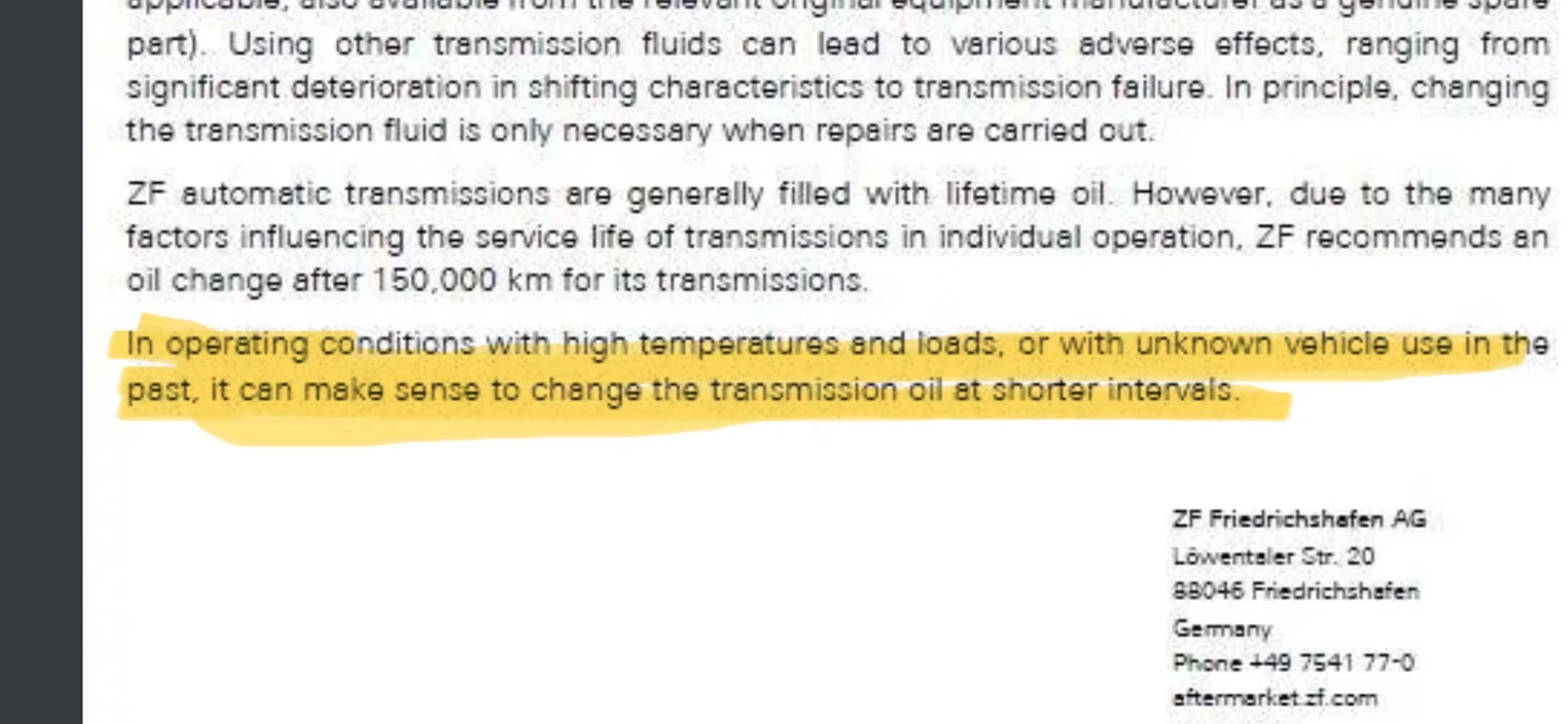

Too bad you left the building. You have much that is good. For all the ones @ShadowsPapa says will panic and feel because I said the word “prudent” to doing a pan drop because we saw our temps 200+, I need to clarify because this key thing CANT be guessed because we think these 200+ temps are just fine because we’ve seen them. It’s bigger and more important than that.
Firstly (I didn’t come up with this, ZF did) that ‘it can make sense to change the oil at shorter intervals if one doesn’t know the history of the vehicle or if higher temps are reached’ is stated by ZF
I read that some time ago and the word “prudent” came to mind so that’s what sticks out for me. So allow me to change that word for the phrase “it would make sense” to do this. For anyone reading all I’ve said and is panicking because I said that word, I hope changing it to “it makes sense” provides some relief.
The topic of “what temperature is hot” and when does it make sense to change the oil can only be clarified, not by guessing or what normal practice is for you or what’s been long time accepted by engineers and red seal mechanics and experts that express what they know based on feelings or classroom regurgitation.
“Hot” or what is “too hot” is when oxidation is formed. Oxidation will then break down the additives and also form varnish deposits. Measurable Oxidation can only be detected by the lab. If oxidation is measurable, “hot” or “too hot” was reached.
Oxidation is a cancer. How serious do we look at it? Is a little cancer ok and do we want it in there and is doing frequent or annual pan drops going to cause harm?
