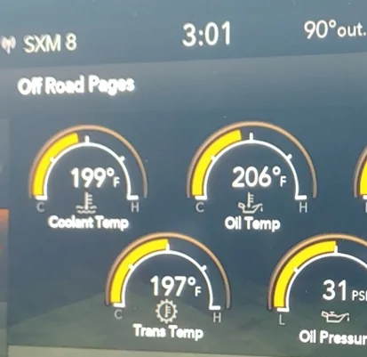

LOL - 210 is nothing, either. Modern fluids handle that with ease.
We hit 195 to a bit over 200 driving on the interstate from CO to IA on a 90 degree day.
Below is an example - long trip, 70-75 mph, reasonably flat, transmission not hunting.
I hit 210 towing on a 90 degree day.
It's nothing these days.

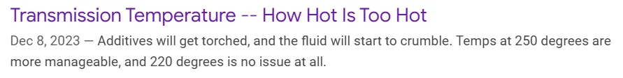

210 isn't hot - and frankly, hasn't been.
I don't know where the "being prudent" comes from as it's a safe temp.
Here's from the web -
Operating temperatures between 175 degree F and 220 degree F are considered normal.
This keeps coming up and no, 210 is not hot and it's not a danger area by any means.
210 is no reason to start thinking about fluid changes. That's such old thinking.
Jeep Gladiator 8 speed fluid change-level the truck or level the trans? 1762654408733-a6
Jeep Gladiator 8 speed fluid change-level the truck or level the trans? 1762654466575-65
You'll find a lot of talk about 200 being too hot, 210 being too hot - that's old old old thinking and even then, wasn't true. Older transmissions ran their fluid through the RADIATOR to cool the fluid - so you'd have fluid hitting temps in the 210-220 range very frequently. If old ATF could handle it, then the new stull will do even better.
I've found people with Ford and GM transmissions talking about towing at trans temps of 230 and they don't bat an eye.
210 is nothing at all.
