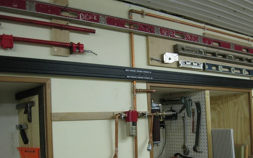

i bought it 15 years ago at an estate sale - Bruce Nottingham - he was an AMC racer, had an AMX, sheriff of nottingham. I bought some of his engine parts, tools and parts books.
See, he levelled things too, more accurately than me! That makes two!
