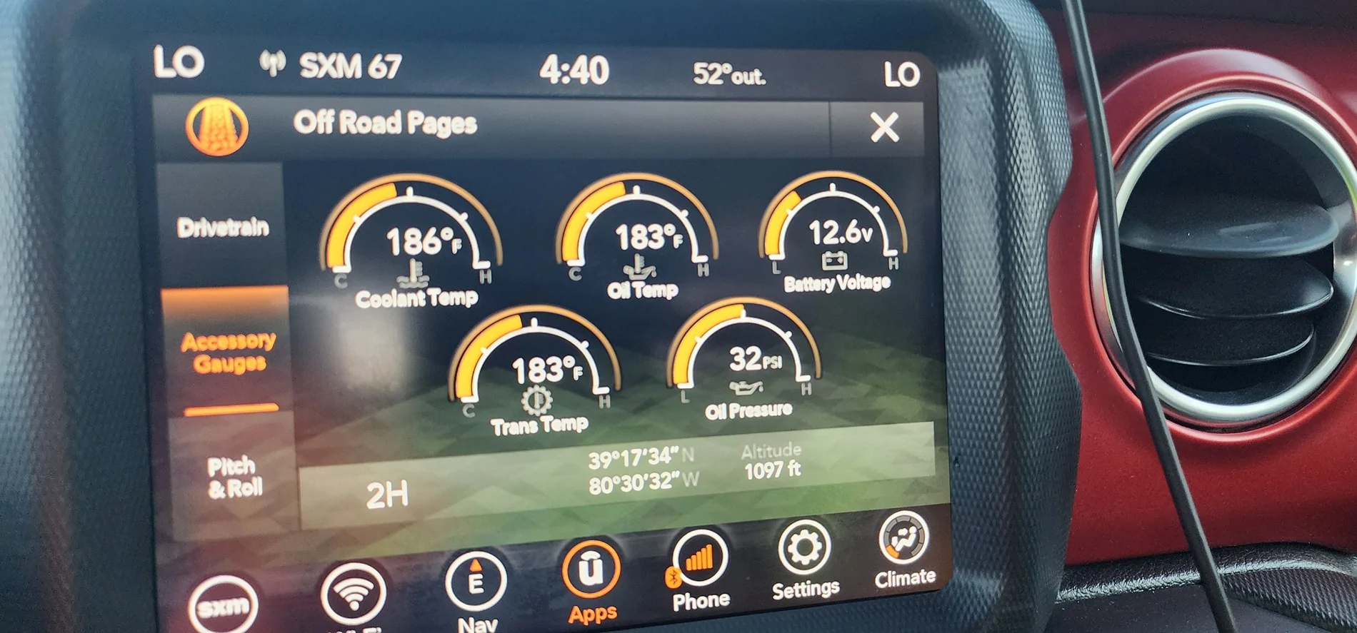

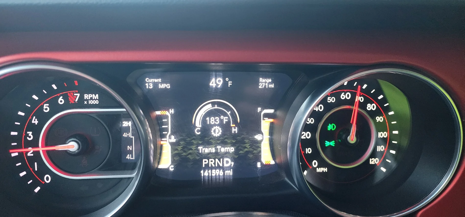

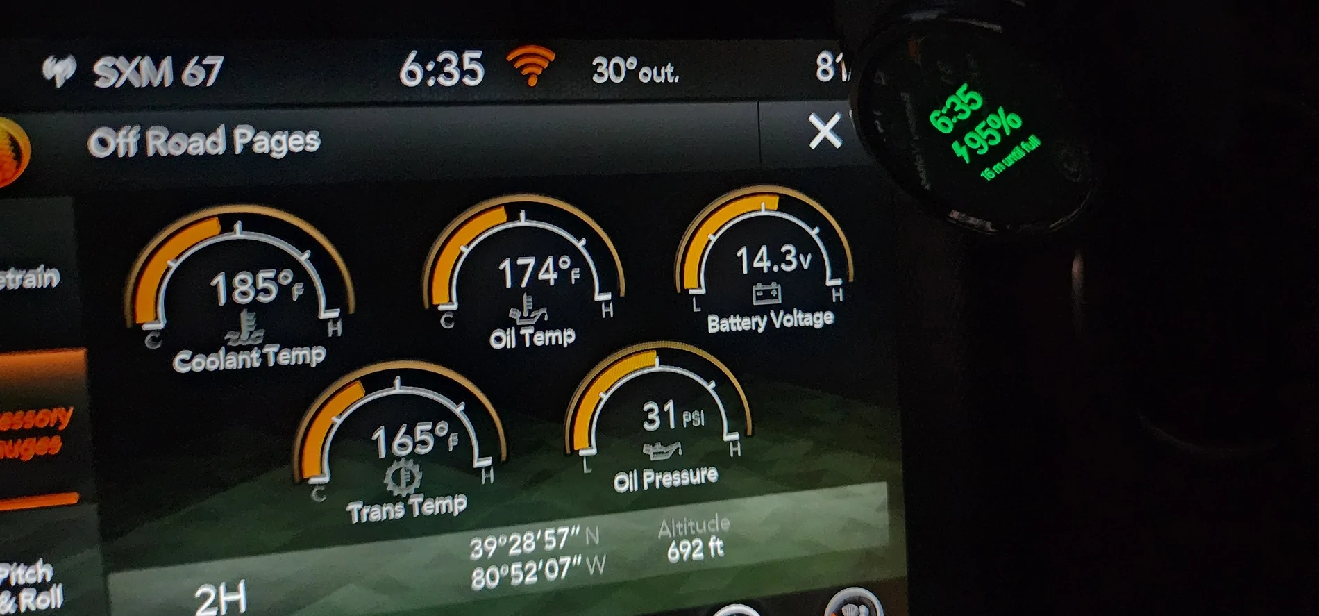

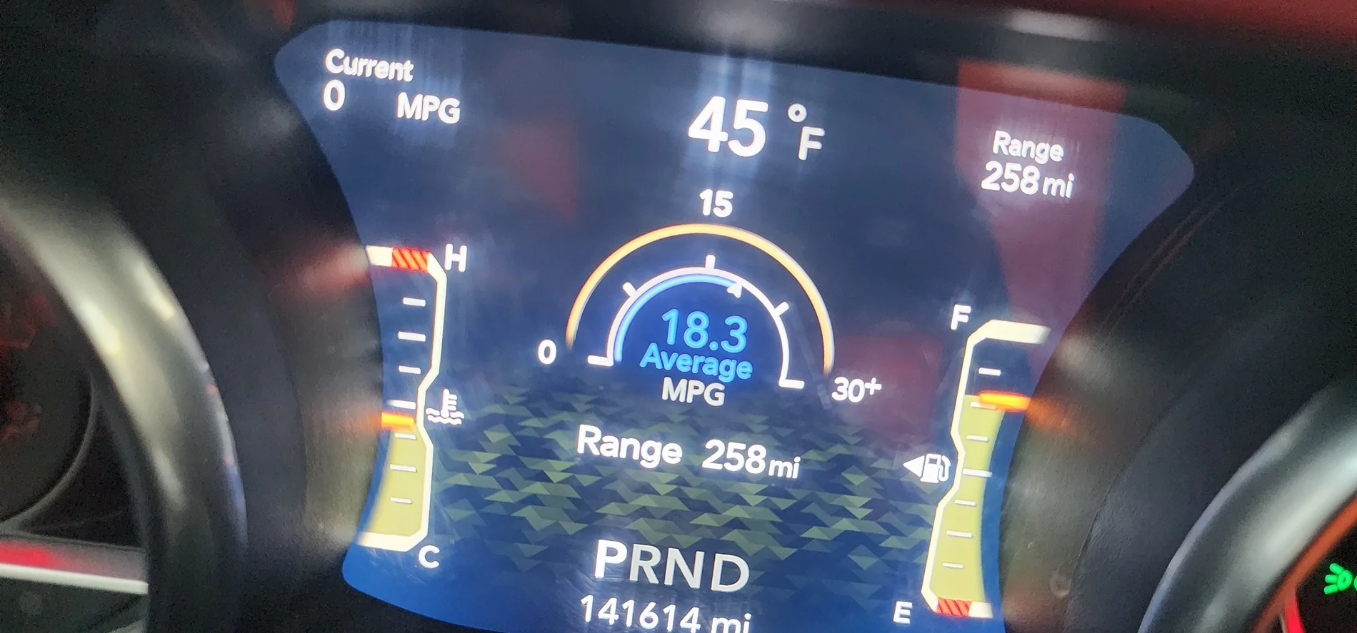

Speaking of temps.
Had to wait till this morning when it was cold out to match your 30°F Readings.
I was about 50 miles into my morning commute and not running easy . Also will post one of me on the highway .yesterday in 52 °F weather running 65mph . Look at temps to see morning and afternoon.
Jeep Gladiator First Transmission Drain and Fill 20251106_164056
Jeep Gladiator First Transmission Drain and Fill 20251106_164306
Jeep Gladiator First Transmission Drain and Fill 20251106_171027
Jeep Gladiator First Transmission Drain and Fill 20251107_063529

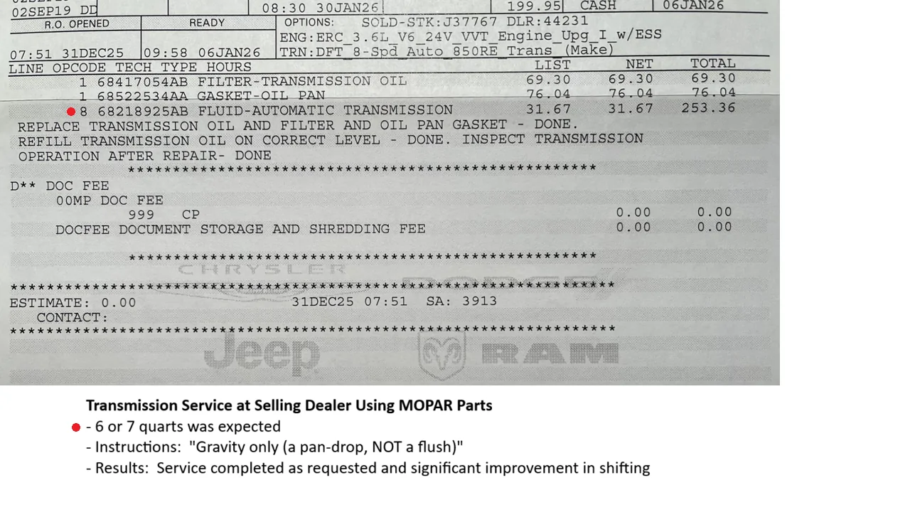

Question: Did the dealer pad the number of quarts? (Are too many quarts listed on the invoice?)
I just had a pan drop done at my selling dealer. They used genuine MOPAR parts and not BG substitutes.
Everything on the invoice looks good except the volume of ATF (8 quarts). Is this out of line, or is it possible that the tech actually used 8 quarts for a pan drop? I was expecting to see 6 or 7 quarts.
I bought my vehicle in Sep '19, the odometer reads 52,000 miles, and this is the first pan drop. I use my vehicle as a daily driver (no off-road use). On a related note, I drained & filled the transfer case myself last year.
Shifting has improved significantly.
He padded it. He would have drained 5.5 quarts and would have put in 5.5-(6 tops). The whole thing holds 9, maybe one more for the cooler (estimated, not reading the book)
A flush would have taken 17 quarts
Thanks for the guidance and the quick reply. I could have called him on it, but he only charged me for one hour of labor. I'd rather keep this deal in play, if there is a next time, than quibble about a quart or two.
Lesson learned is always check the number of quarts (six or seven).
Lesson learned is always check the number of quarts (six).
Did you drive it there hot and he worked on it right away or was it parked over night so he had it cold when he drove it in on the hoist?
40,465
53,917
That depends on if it was sitting or hot among other factors.
All responses are in a way, speculation, not having been there to know how much came out and the exact conditions.
8 would seem high - however, it's a guess as to exactly how it was done
These dry take 9 to 10 quarts, depending on cooler and so on.
Typical for a drain and refill is 5 to 7 quarts. (yes, it varies that much)
If you give them the benefit of the doubt, it's still likely 1 quart over.
