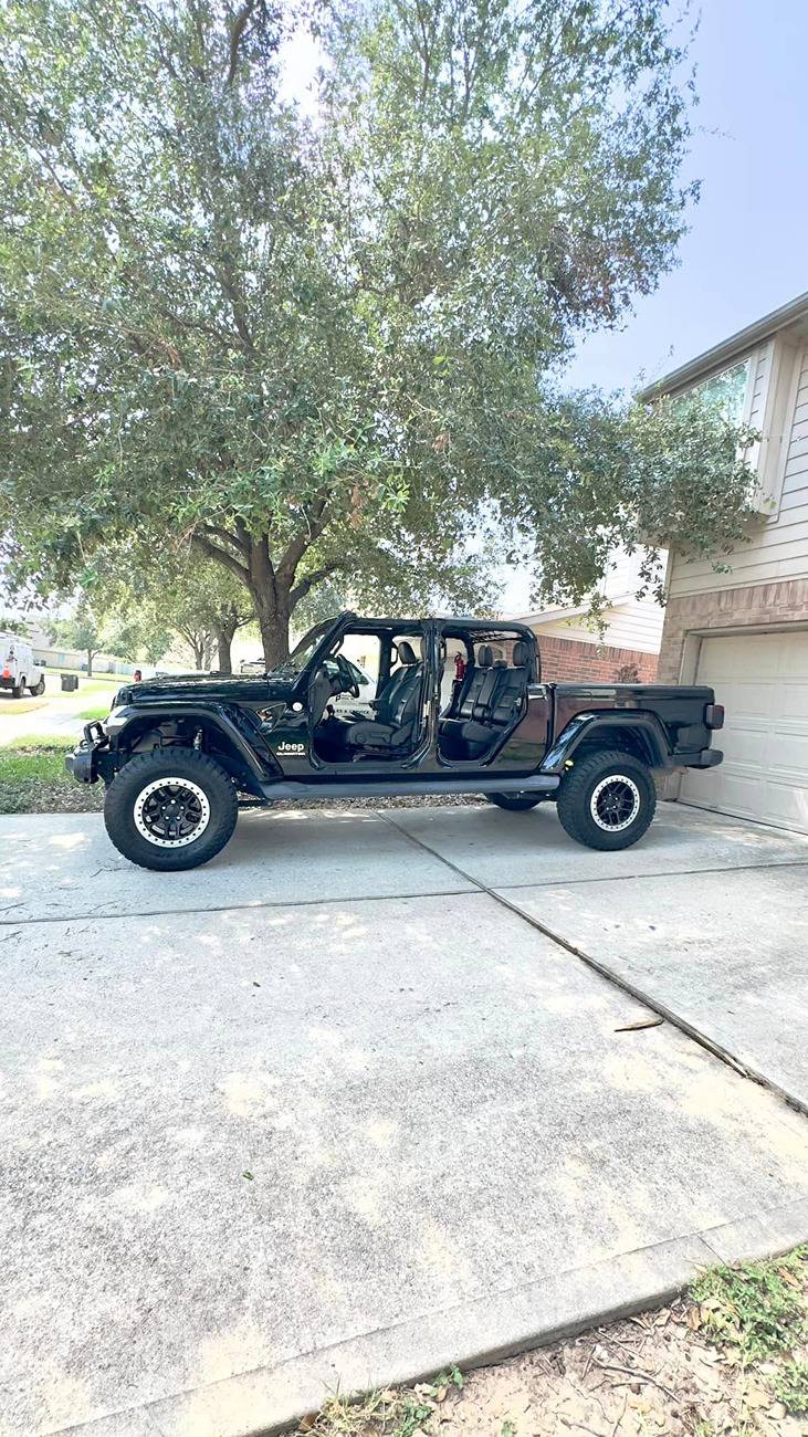

SERVICE UPDATE
Current Mileage: 68,500
No issues
Transmission runs exceptionally well
Shifts are smooth between all gears
I plan to do another transmission drain and fill at 80,000 miles which I expect to happen around November 2025. That will be 2 years from when I performed my first drain and fill. That will leave me with approx 21% of the original fluid. I'll do another drain and fill at 100,000 miles around November 2027
