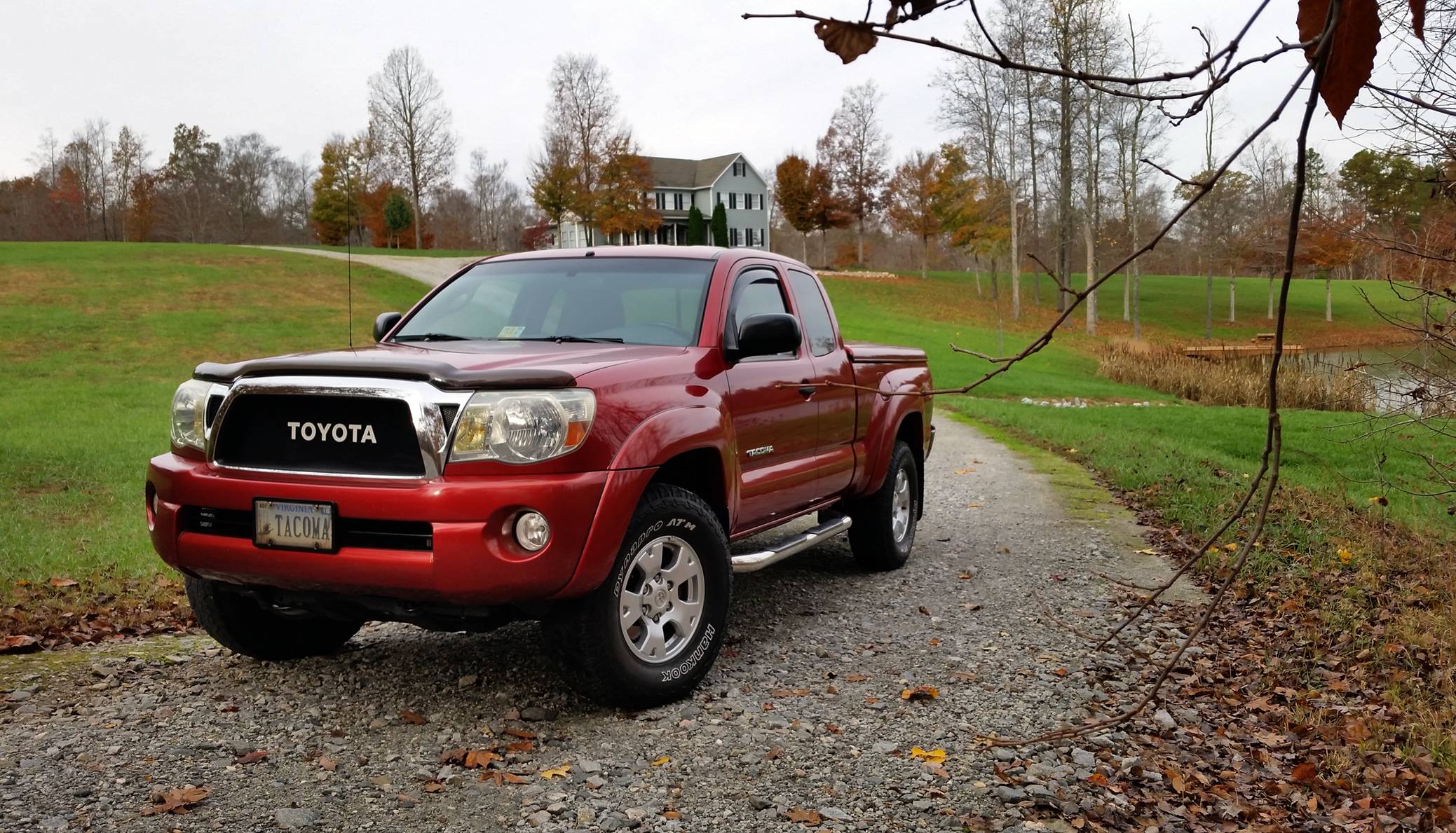

Had 189,000 on it when I sold it to a friend. Sealed system. Never changed. Ran great.
