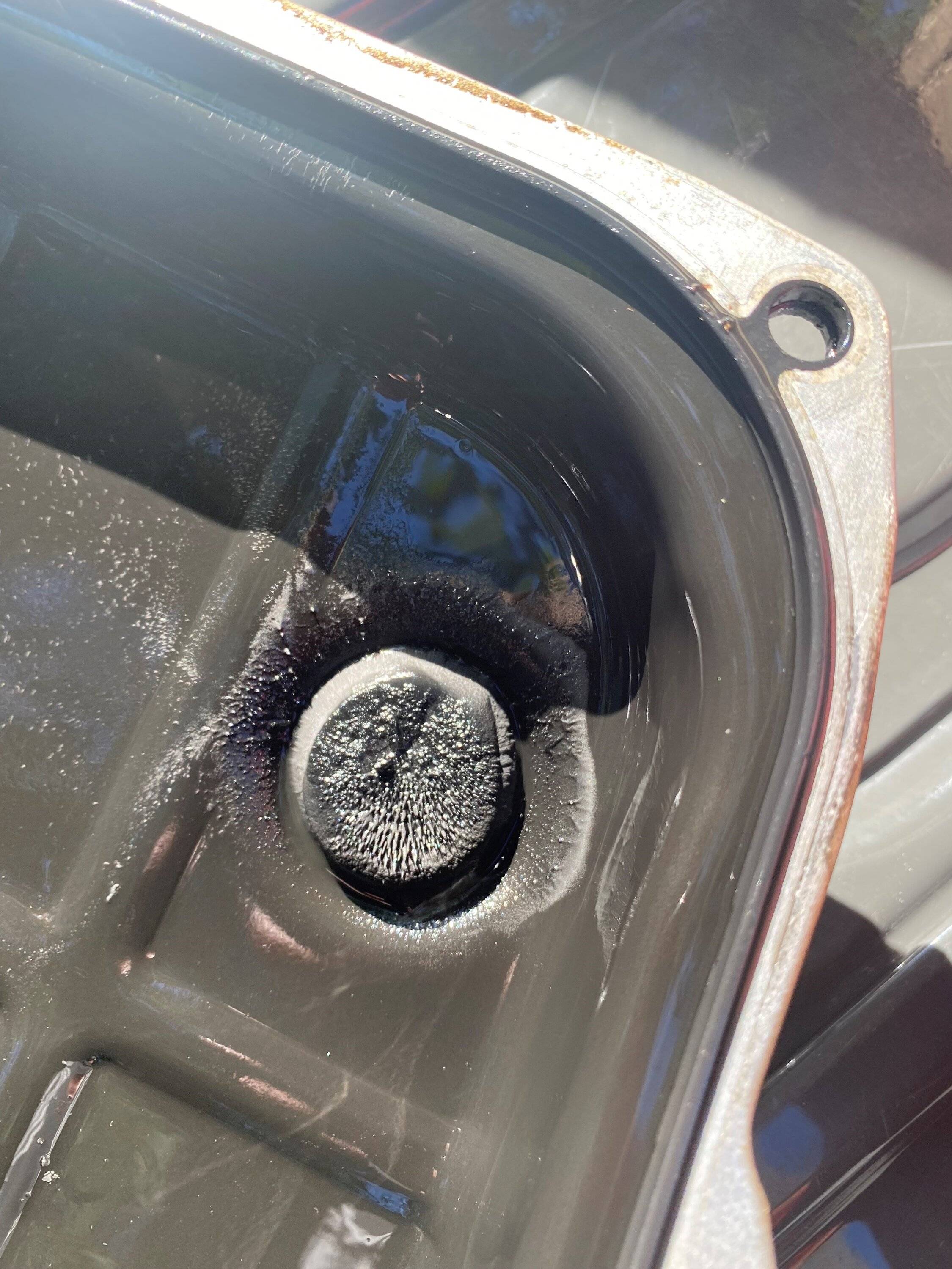

I just changed my filter and trans fluid on my JTRD 2 months ago at 30K miles and the magnets are covered in metal shavings from break-in. It's not a closed system, it's as easy as dropping the pan and refilling through the fill hole. It's almost impossible to screw up unless you don't get the trans up to the proper temp range. You simply fill until it comes out the same hole you fill it from. It's idiot proof.
Both magnets will be filled like this even at just 30K miles. I plan on keeping my JTRD until I die so I prefer preventative maintenance. Mopar does not have your best interest in mind when they make service intervals as evidenced by the "lifetime" fluid in the transmission.

Sorry, that is just not true. I know this first hand because my dealer tried to void my lifetime powertrain warranty on my JKU at 205K miles saying I improperly serviced the transmission saying I didn't use the correct oil or filter. I called their bluff and pulled the receipts and they ended up replacing mine under warranty. I used a Wix filter and Mopar ATF. The only risk is failure to document your service history and parts used. Long story short they incorrectly diagnosed a bad wire in the trans harness and the trans itself was perfectly fine. Got a new one for free under warranty. You can also log you own service records right on the Mopar "My Garage" site and the dealer can see them and vise versa so there is full transparency.

I've done countless automatics over the decades, and sorry, but the "concern" about the stuff on those magnets? That's nuttin. People without years of experience see that, though, and oh, man, that's BAD!
No, not really. That magnet did the trick, it's fine now. That's exactly how it might look. Some may be better, but that in the pics - meh, I'd not be concerned and I used to rebuild transmissions for a living.
A big difference when you understand and have had tons of hands-on, and seen many many dozens of transmission internals.
It's not going to fail if you don't service it so soon. But the internet is what it is........ so the messages will keep getting posted around and it's more fact than real fact.
