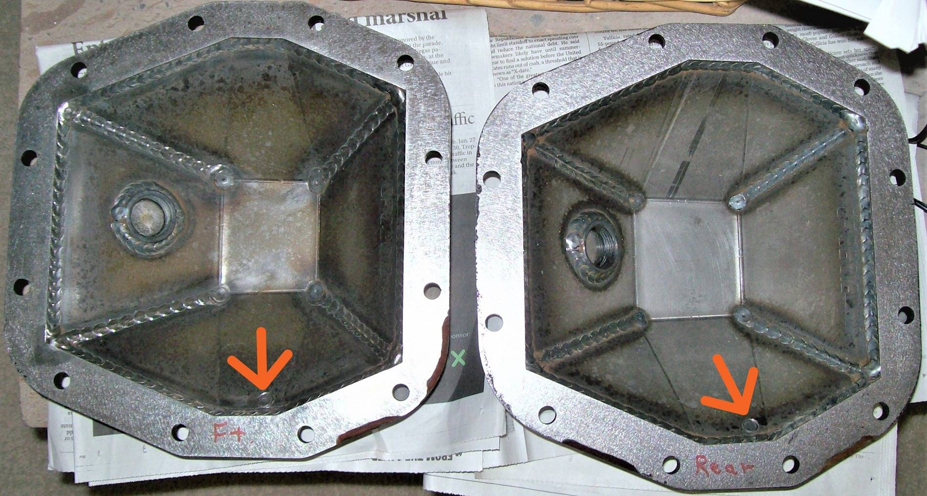

I drilled and tapped my CavFab covers 1/8 NPT for drain plugs.
