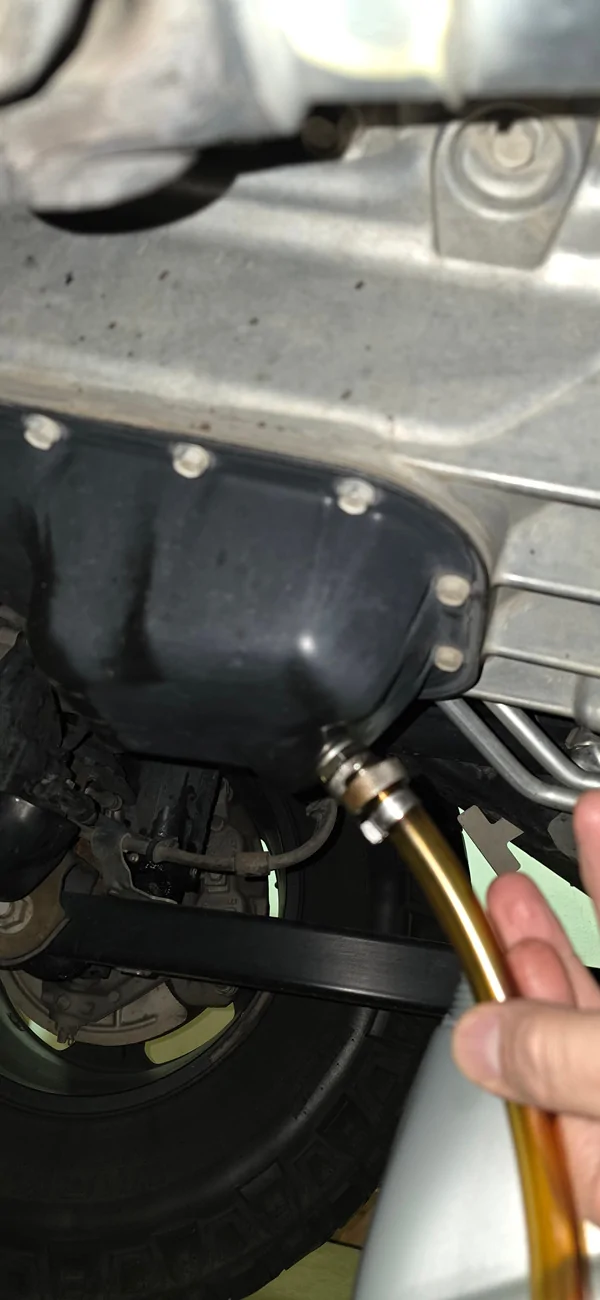

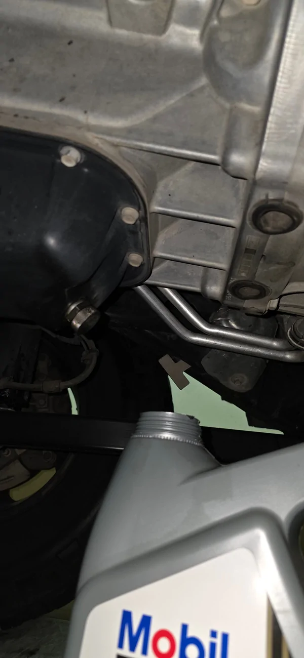

Engineer
We use the Votex - Oil Drain Valve on both the Gladiator and Wrangler.
Very easy to drain the oil into an old 5 qt jug then return the old oil when I buy a new 5qts (saving the newest empty 5qt jug for next oil change).
Since the ValvoMax looks the same except it has the cap retainer, I would go with the ValvoMax if I were buying now.
