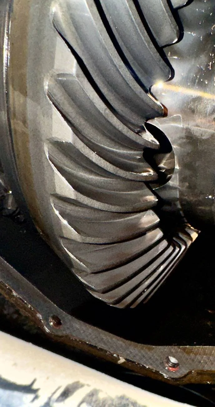

I take some photos of the gear faces in the process for documentation. Next change I can compare and see how it’s going.

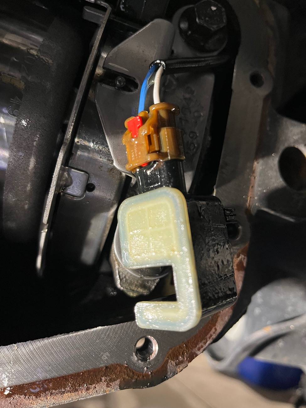

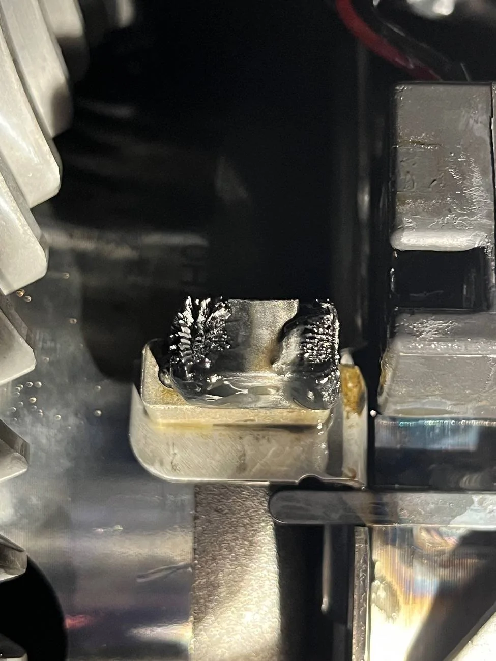

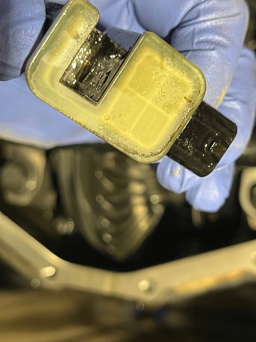

OP, there’s a few other things to address while you’re inside the diff that no one has mentioned and that is if you have the Rubicon model, you have lockers and because you have lockers, you have to maintain the locker magnets and do a visual inspection of the locker sensors (one in each diff).
Have you engaged your lockers yet, I think you said you’re at 60k now?
Doing your magnet cleaning is essential because you don’t have a magnetic drain plug pulling the suspended metal filings out of the oil so your locker magnet is doing it and you can be sure the magnet is plugged up which causes your lockers to not work well, if at all.
Inspect the sensor for oil intrusion which can also short out the sensor and you won’t have lockers if that happens. The sensor pulls out after undoing the single Torx screw. The magnet is holding on to it so you have to grip it and pull it off. You’ll see all the filings around the magnet. The magnet stays in place, just clean it off.
I would use brake clean to spray out the inside and get it all clean. Don’t spray the electrical connection. Let it dry and put it all back together and fill it up.
You also don’t need the LSD additive because you have lockers. Good luck.

Yes, and to those that just say “I just bypassed the sensor by using that Z automotive bypass locker sensor harness and I never have locker problems..” …you still have a magnet in there and they don’t attract metal filings forever. They still need to get cleaned off in order for the magnet to be effective at cleaning the filings, if nothing else.
But for those of us that just left things alone and factory locker harness is fine and the sensor doesn’t have oil intrusion but your lockers aren’t engaging fast or at all or thinking too long before engaging, the magnet has too much metal filings on it.
The photo above of my magnet with filings, …this was enough debris on my magnet to delay the engaging and disengaging of my lockers. After hitting the button, I would count 10 flashes on the dash where the lockers weren’t engaging. After about 10 flashes or so, it would quit and I’d have to hit the button again and repeat multiple dash flashes before it would engage.
After I cleaned it off, cleaned things up in there and put it all back, lockers engaged on the third flash of the indicator light. I then drove another 25-30k kms and changed oil again. Lockers were still engaging on the third flash. I then drove another 30k kms or so and pulled the covers and cleaned the magnets again.
Locker engagement is now on the second flash, nearly instant.

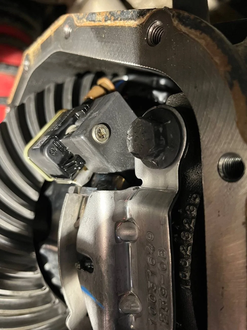

Looks like you twisted a bolt off . You need to get that removed and get another bolt.
