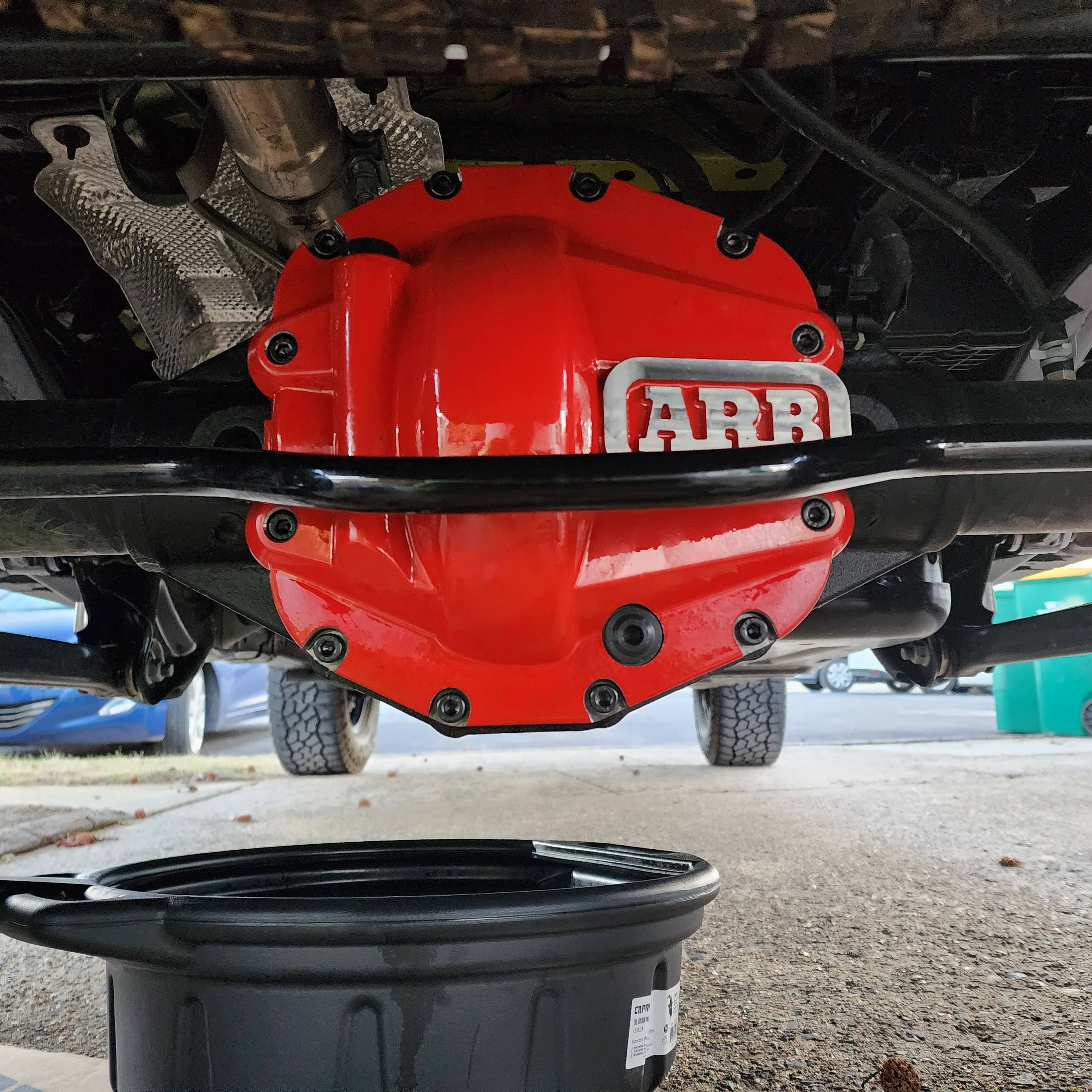

2023 JTR-HVY 6spd, 2019 Mustang Bullitt
That narrows it down to two I can readily think of for the Advantek 44 diffs, AFE and ARB. Does not leave a lot of choice, especially if a buyer does not like the aesthetic of either.
Yeah, due to my lack of factory drains, I went ARB covers, well for more reasons than drains, but yeah, lol
