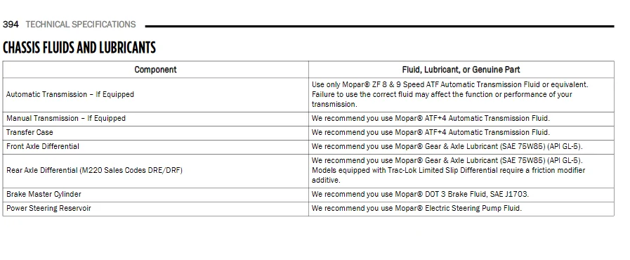

So I have been all over this sight and have never seen a statement on what fluid weight is being used and what brand/brands . Also do the front and rear take the same weight ? I worked as a parts guy at a ford and dodge dealership back in the 80's and the techs would also ask for a I think was a 2oz bottle of Anti-slip friction additive . Do these need any of that ?
75w85 is what the Mopar oil is. I'm going to use Valvoline flex fills when I change mine in a few weeks, 75w90. If you tow a lot or or you use case is "severe", 75w140 is recommended, and if you have an LSD, then you'll need the additive. A lot of oils have the additive so probably do not have to purchase separately

So I have been all over this sight and have never seen a statement on what fluid weight is being used and what brand/brands . Also do the front and rear take the same weight ? ...
Information on the required oil for the front & rear differentials can be found in your Owner's Manual.
Here's the page from the 2021 Owner's Manual:
Jeep Gladiator Front Differential Service 1674417509502
