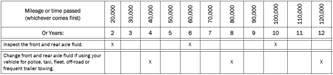

when should the diff oil be changed? I'm at 26K miles and live in the desert.
For a new vehicle that is used as a daily driver (no off-road use or trailer towing), a very good service advisor at my selling dealer recommended changing the differential fluid in both axles at 30K mi.
For a daily driver, or normal driving, the owner's manual ("the book") says do an inspection at 20K mi and then every 40K mi thereafter. Also, the book does not provide a specific fluid change service interval for normal driving. After the first fluid change, I recommend that you follow the service interval for severe duty (every 40K mi), inspect the fluid, and determine whether it needs to be changed (which is what the book shows, but doesn't explain).
For severe duty, the book says inspect the fluid every 20K mi and change the fluid every 40K mi. Others have already commented on this.
In practice, the rear usually needs to be changed more often than the front.
Info pieced together from the owner's manual (not much help for a daily driver):
Jeep Gladiator Front/Rear Diff Service - DIY 1781819828491-42

For a new vehicle that is used as a daily driver (no off-road use), a very good service advisor at my selling dealer recommended changing the differential fluid in both axles at 30K mi. After that, I believe that the guidance from the dealer, for a daily driver, is every 60K mi.
Also, the book says do an inspection at 20K mi.
For severe duty, the book says change the fluid every 40K mi. Others have already commented in on this.
Appreciate that. I think I will do it at 30K miles.

I might have missed it and am definitely too lazy to look it up in the manual, but when should the diff oil be changed? I'm at 26K miles and live in the desert.
40k

T
Annually or every year, which ever comes first.
His is a good rule of thumb, and as previously mentioned 40k min. If used for towing ,offroad applications.
