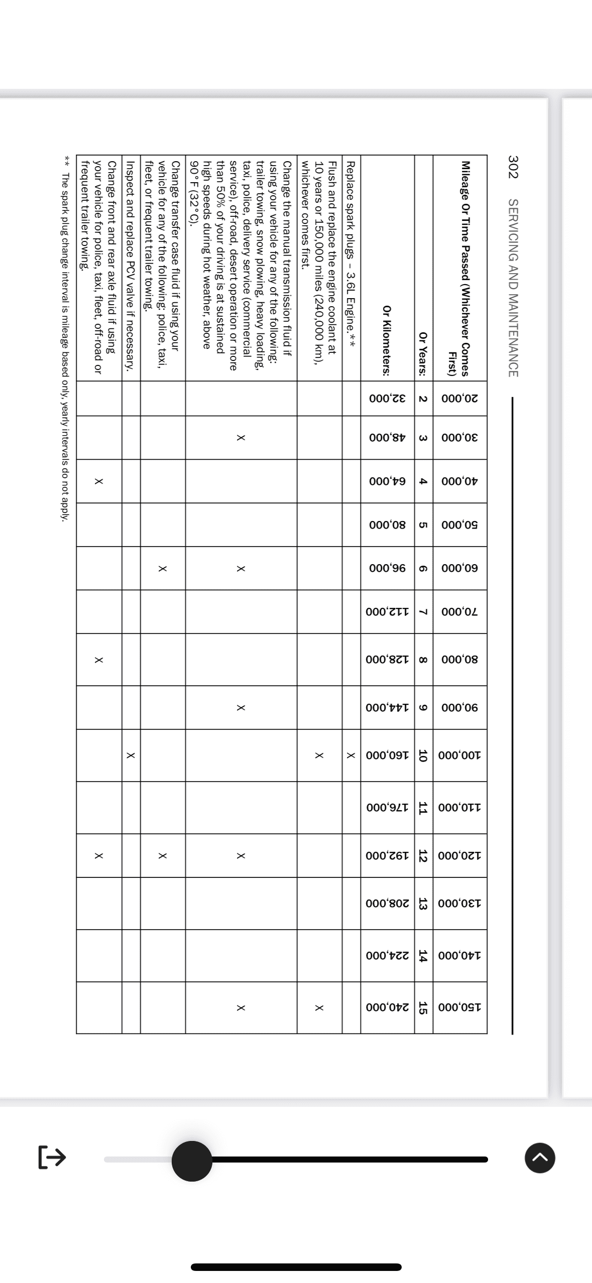

So I’m approaching 20k miles. I have searched the threads on here and it seems like that’s when everyone is changing the diff fluid. When I look in the owners manual it says inspect at 20k but it doesn’t say change until 40k. But if you’re going to “inspect it”, why not just change it. Unless I’m an idiot and missing something. The dealership I normally take it to says I don’t need to change it at 20k. Not till 100k, I’m thinking to myself your an idiot have you ever even looked at the owners manual. But he wasn’t my typical service advisor. Was gonna go in there today after work to talk to my normal guy who I generally trust. Typically I don’t start servicing stuff myself till the 36 is up. So was just gonna let the dealership do this one.
Thanks!
