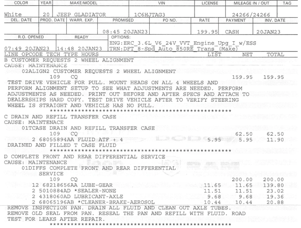

Here's a dealer invoice for these jobs:
Jeep Gladiator Front/Rear Diff Service - DIY 1782761450753-7k
262.50 Labor (excluding price of alignment)
214.96 Parts
26.95 Misc (negotiable to zero)
504.41 Total charges
17.73 Tax (8.25% on parts only)
522.14 Total paid
- The labor rate of 199.95 has remained the same since at least 2021.
- Parts prices (for fluids) may have changed, but some dealers are using MOPAR equivalents, such as BG Products, to keep prices down and maintain margins.
- The twelve (12) units of gear oil might be pints (= six quarts), especially given the unit price. When using the same viscosity grade (75W-90 in this case) for both axles, a total of three quarts of gear oil is required. The two (2) bottles of friction modifier (4318060AD, 4 fl oz) are also twice as much as required. I had this service done before I joined this forum and started doing these fluid changes myself.
