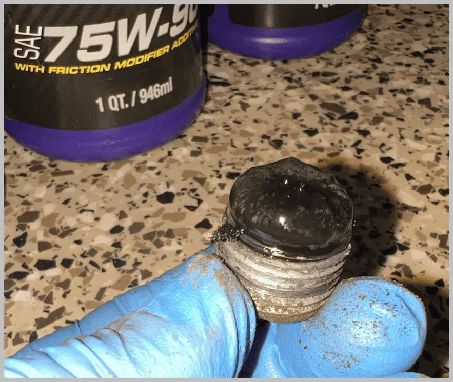

By all accounts, I believe I should be fine.
2020 Overland with Trac-Lok LSD option
I service mine at 50K miles.

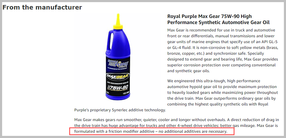

Drained and filled with Royal Purple Max Gear 75W-90 High Performance Synthetic Automotive Gear Oil.
Royal Purple states that their Max Gear is formulated with a friction modifier additive – no additional additives are necessary.

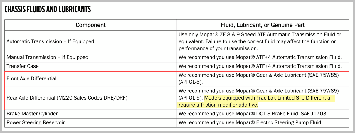

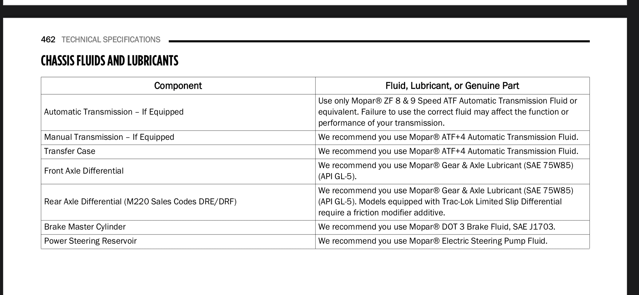

Just came to add my 2 cents
1.) there is DEFINITELY conflicting info in OEM documents about wether a OEM locking differential needs friction modifier, my statement is it doesn’t hurt to add it. Also with that, some fluid says with friction modifier added, I tend to ignore that as FCA/Jeep uses metal disc and no friction material in their limited slips, so I always reccomend using Mopars additive, its cheap and ensures you long life
2.) Ive personally put 75/140 in all our personal axles, while I might not tow, we do wheel, and adding the larger tires (37s from 31s) is a big difference. FCA/Jeep likes to change the oul weight like this even when the physical axle is unchanged. The Gladiator does change with a towing package, but the JK was a good example of this, simply adding the towing reciever meant “tow package” and basically they said if there is a hitch, then bump up from 75/90 to 75/140. They manual listed if a hitch is present, use the higher.
just to be safe, with the locking stock axles, go ahead and buy a bottle of Mopar, put half in the front, half in the rear. Choose your favorite fluid, at recommended weight or slightly higher if you understand mods/use case of your particular vehicle
