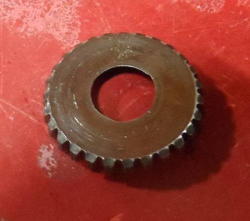

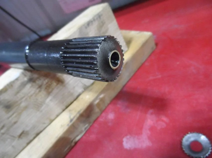

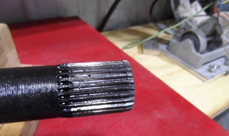

The clunk in the pan I talked of ->
Jeep Gladiator 28,000 mile Rear Diff Fluid Change sx4-axle-broke_3670
Jeep Gladiator 28,000 mile Rear Diff Fluid Change sx4-axle-broke_3667
I put the piece back on the end of the axle to get a shot of where it came from - you can see the break.
Jeep Gladiator 28,000 mile Rear Diff Fluid Change sx4-axle-broke_3666
