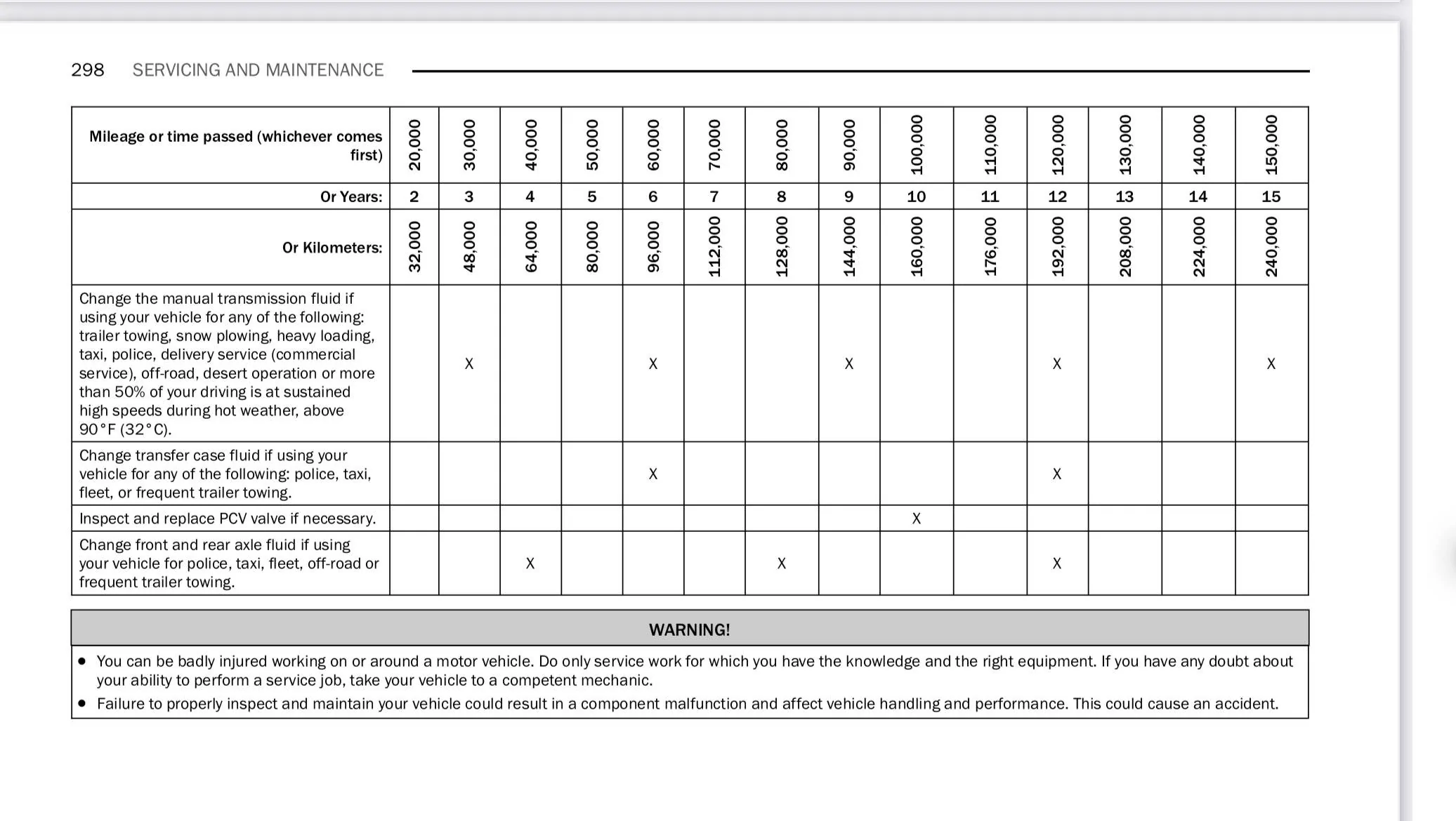

28k isn’t every oil change or every other month. The recommended interval according to page 298 of my owner’s manual is 40,000 miles if frequently towing or off-roading. What does towing mean? What does off roading mean?
What if I tow a 4,500lb trailer 300 miles a day at 70mph Monday thru Friday and stay in 4lo every weekend and wait until 40,000 miles? Would the dealer be more likely to say my rear diff going out at 38,000 miles with my use is abuse or that it’s a good thing I didn’t bother to check it until 40,000 miles? What if I buy a Mopar performance parts set of diff covers? Would that be considered tampering or do I need to make sure I do it at 40,000 miles on the dot and make sure a dealership mechanic learns on my rear end how to swap fluid on one?
