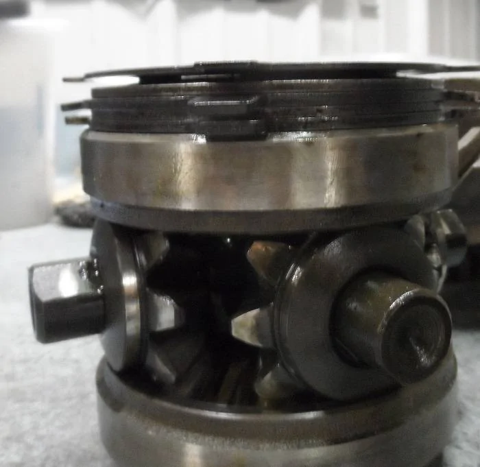

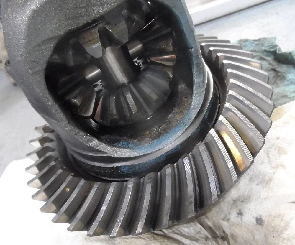

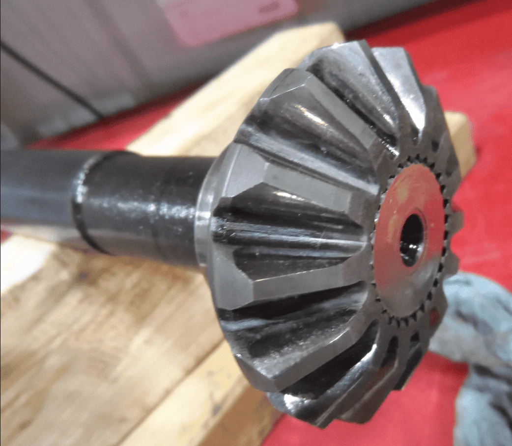

The smaller teeth in this picture or something similar. I assumed they were part of the factory limited slip, but I have not personally rebuilt one, so perhaps I am mistaken. I have seen 4 instances where they were broken off in a little more than a year and two myself with less than 35k miles. I also had it happen in a Jeep Liberty years back. All my rigs had the factory limited slip, so I made the assumption.
Those are in ALL differentials, every one of them for decades.
If the teeth broke it's not a problem with limited slip unless the thing was under extreme torque stress going around a corner and the clutches didn't slip.
They just don't break.
Those gears are how one axle can go a different speed than the other in a differential. The torque is transmitted from pinion to ring gear - which is bolted to the carrier housing, then through the pin and spider gears to the larger side gears which the axles are splined to.
I've busted AXLE shafts but never taken teeth off those gears.

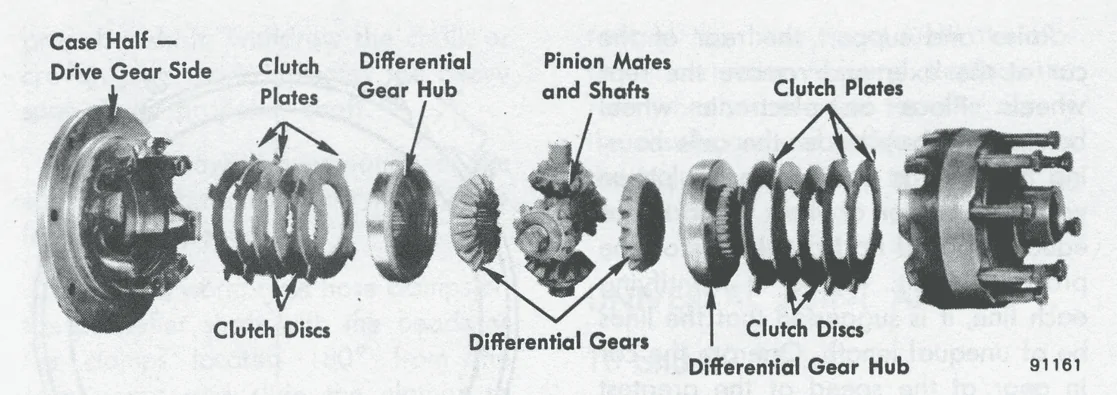

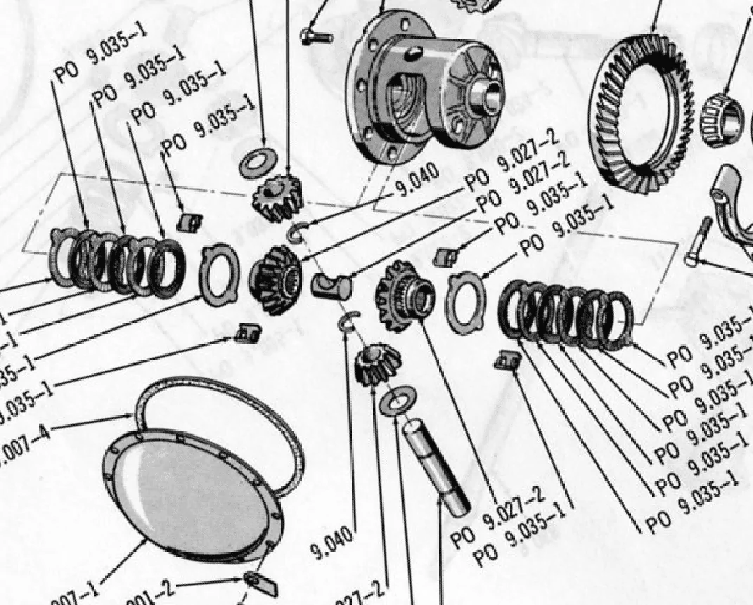

Here is a non-limited slip differential (AMC 15 from an Eagle) ->
Jeep Gladiator Early fluid changes: differentials, transfer case, manual transmission misc-camera_4-16-17 037
Jeep Gladiator Early fluid changes: differentials, transfer case, manual transmission 1692815986496
Liimited slip (AMC used 4 pinions or spider gears in the limited slip instead of 2 like the standard open differential had)
Jeep Gladiator Early fluid changes: differentials, transfer case, manual transmission 1692815789933
Jeep Gladiator Early fluid changes: differentials, transfer case, manual transmission posi-plates_2015
Trac-Loc ->
Jeep Gladiator Early fluid changes: differentials, transfer case, manual transmission 1692816109024
Lots of different configurations, some with 2 spiders (carrier pinions) and some with 4, but all have the same basic configuration unless it's an after-market setup.

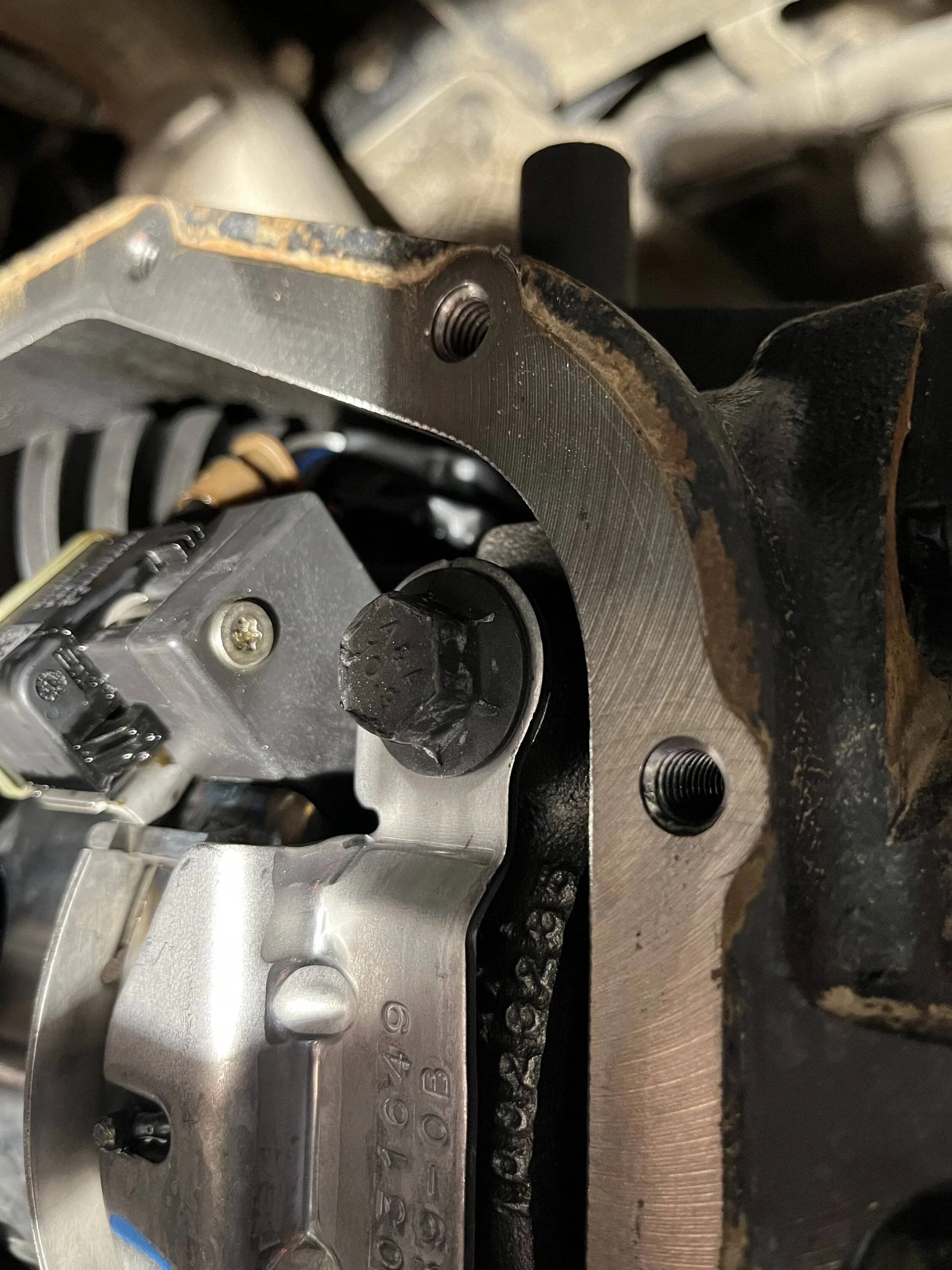

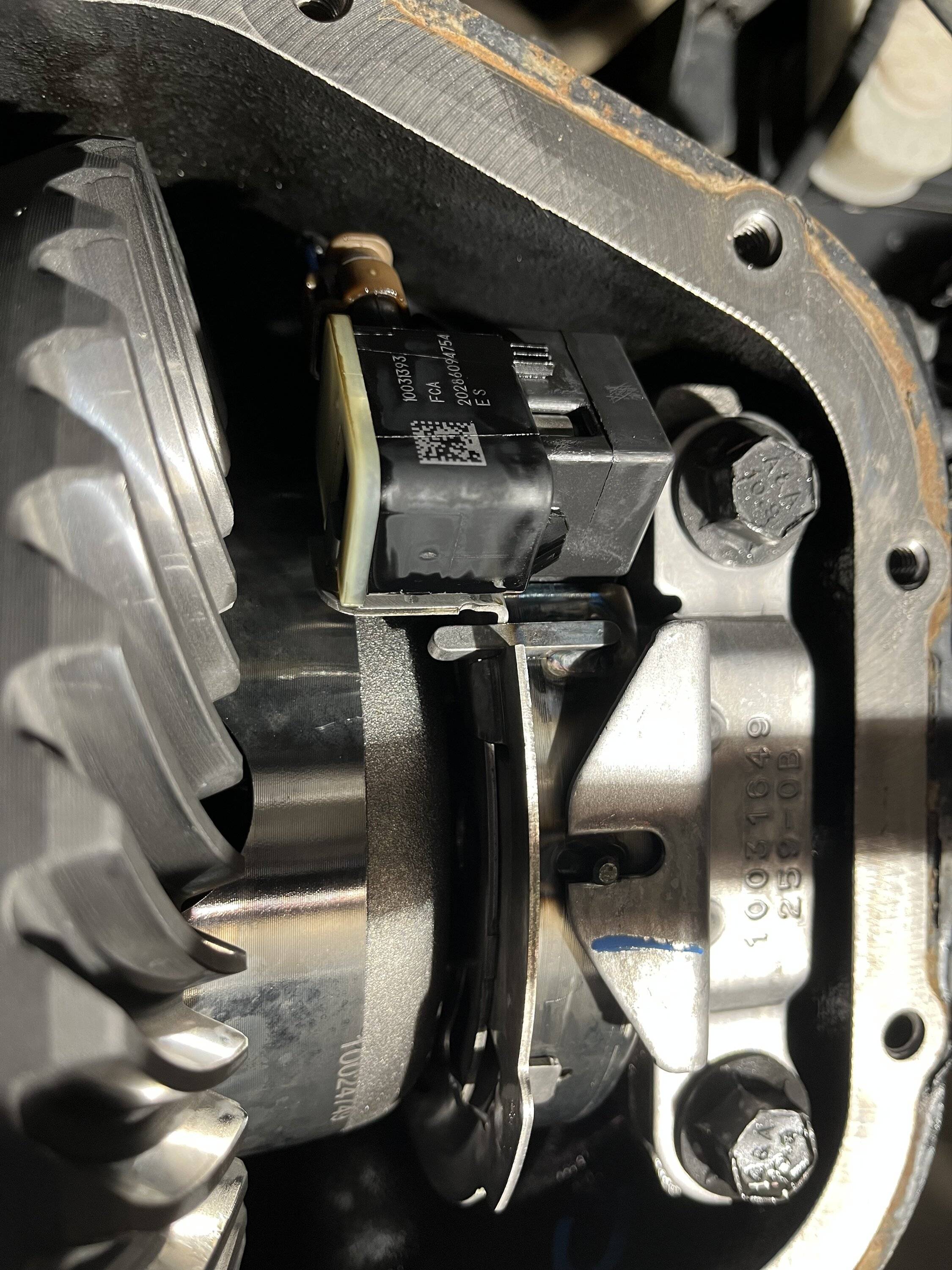

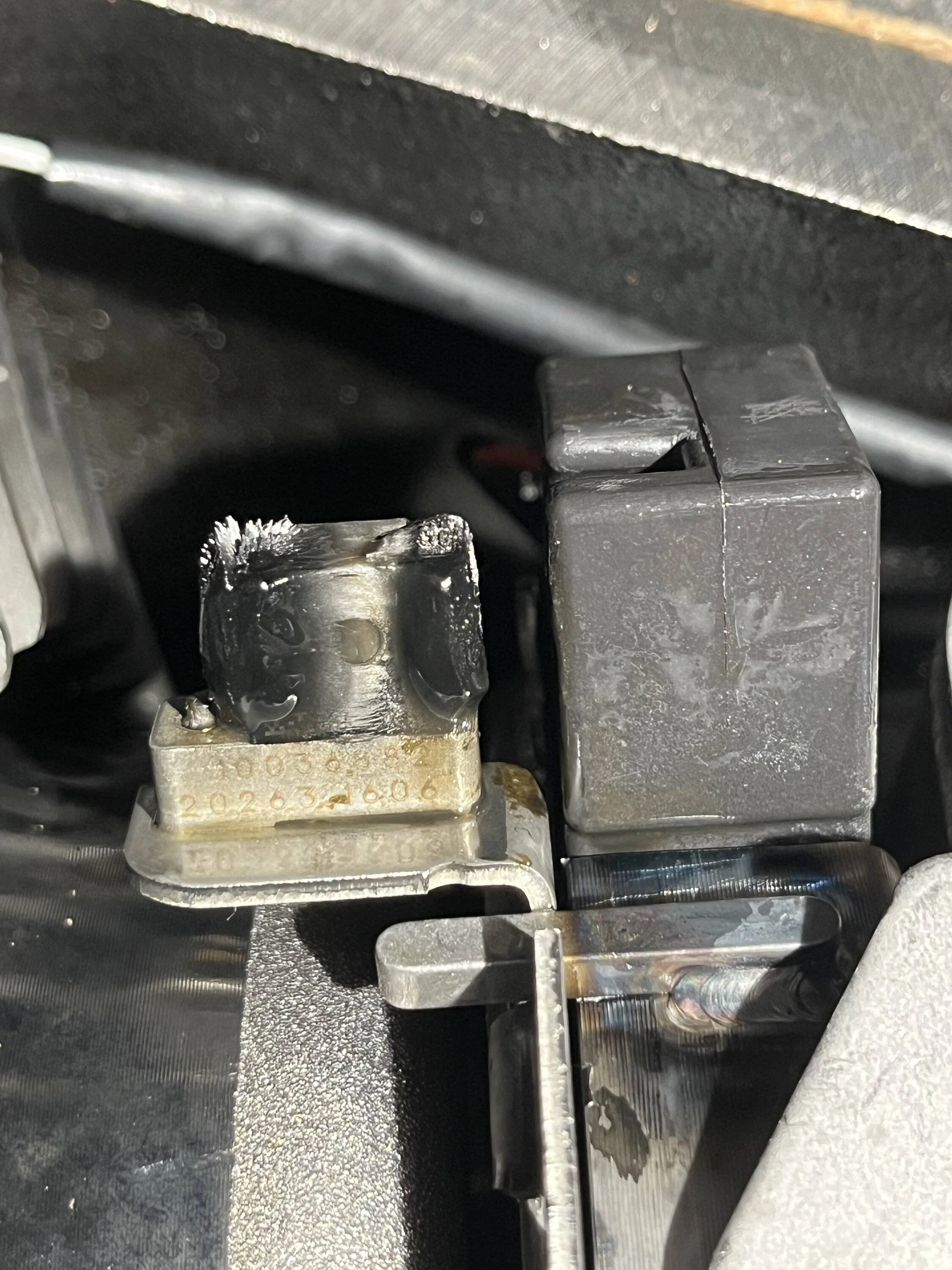

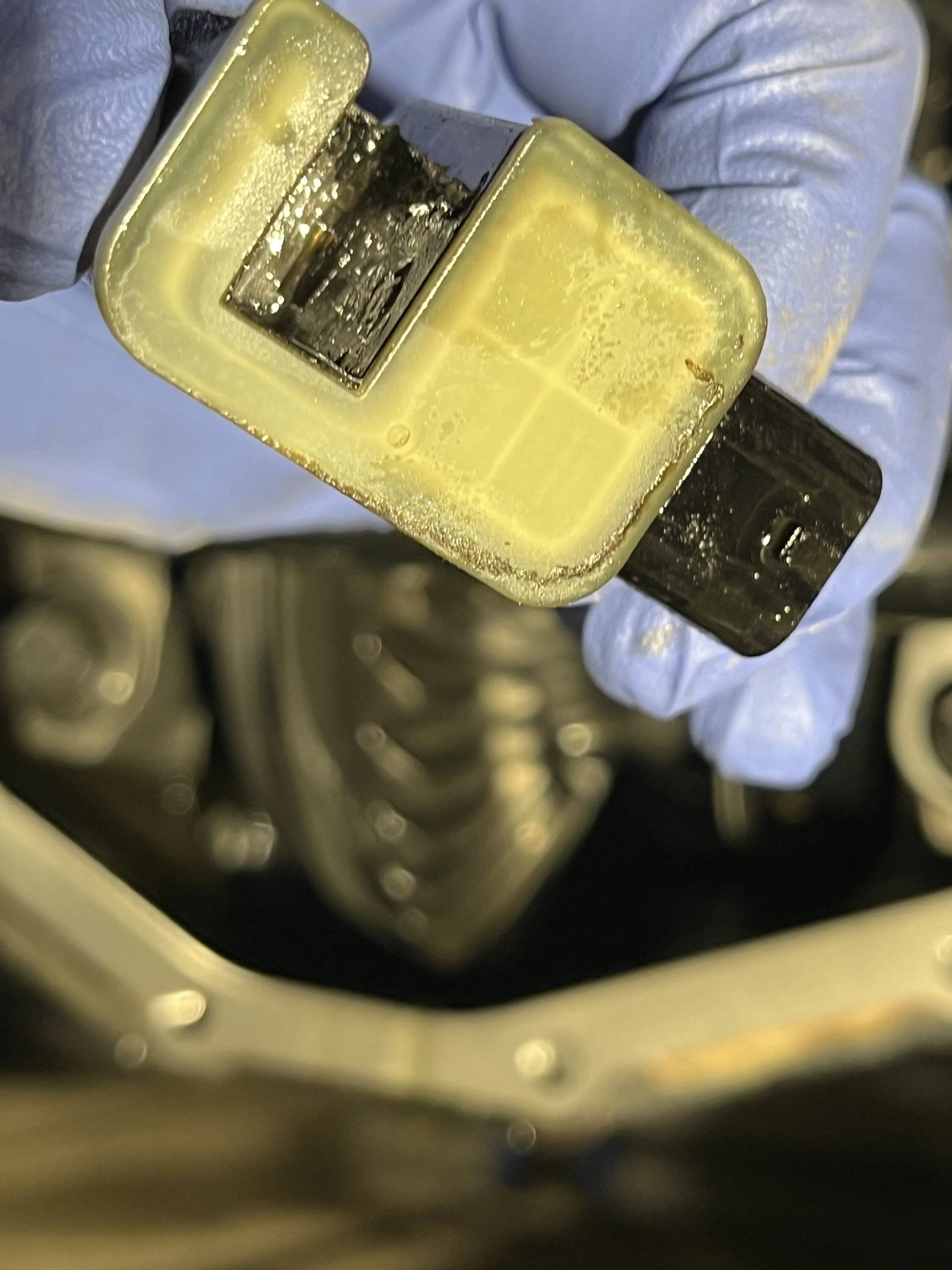

Oh ya, almost forgot…
While you’re in there with the rear diff cover off, don’t forget to clean off the locker sensor magnet and inspect the sensor for oil intrusion. There’s one Torx screw holding it in place over the magnet. It’s easy to see oil in the sensor through the light coloured housing. If there’s oil in it, you’ll want to do a warranty claim and have the dealership take care of it.

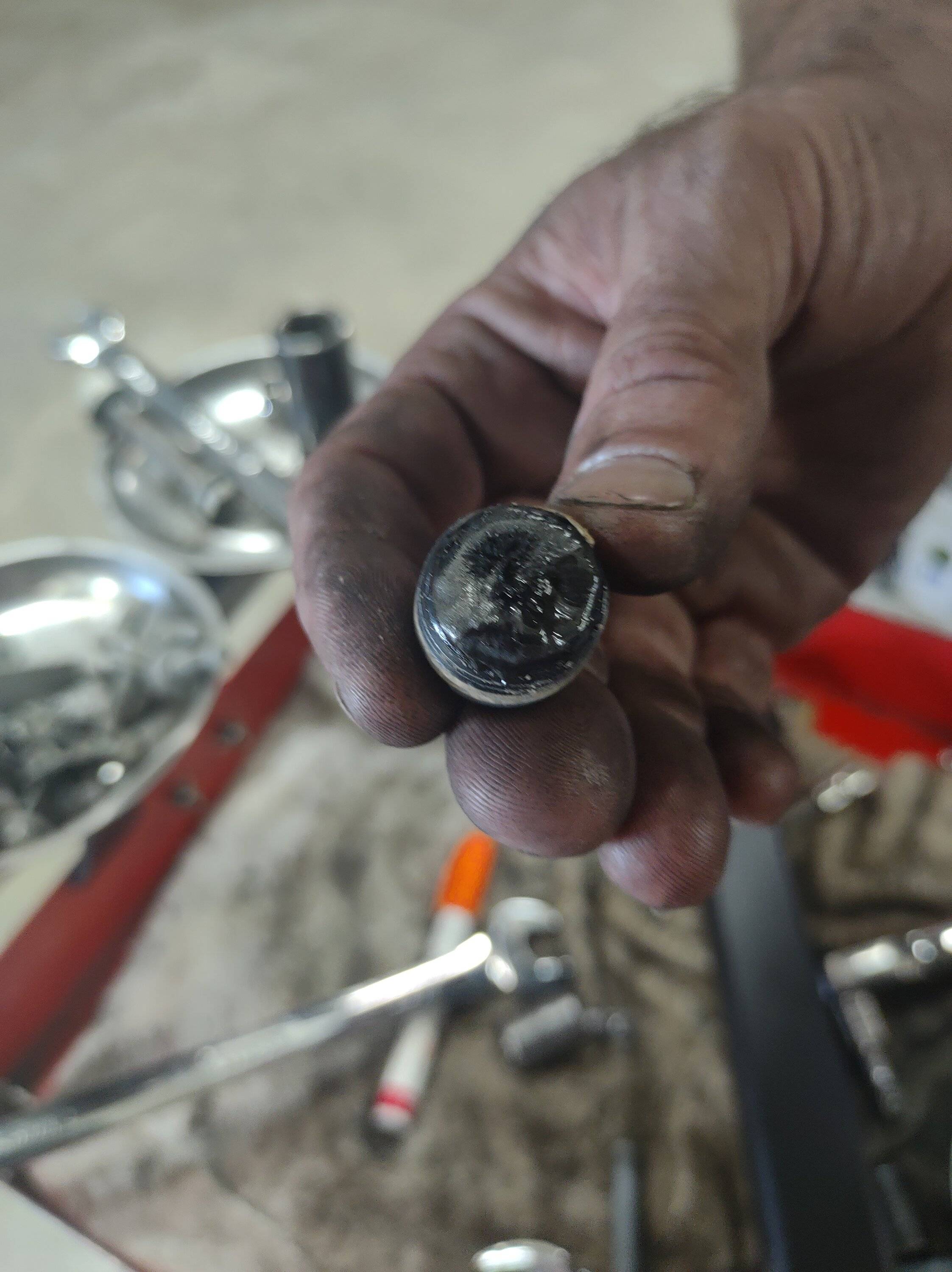

... and the new axle w/o a drain plug DOES have a magnet on the fill plug. Minor particles after 40 miles or so of break-in.

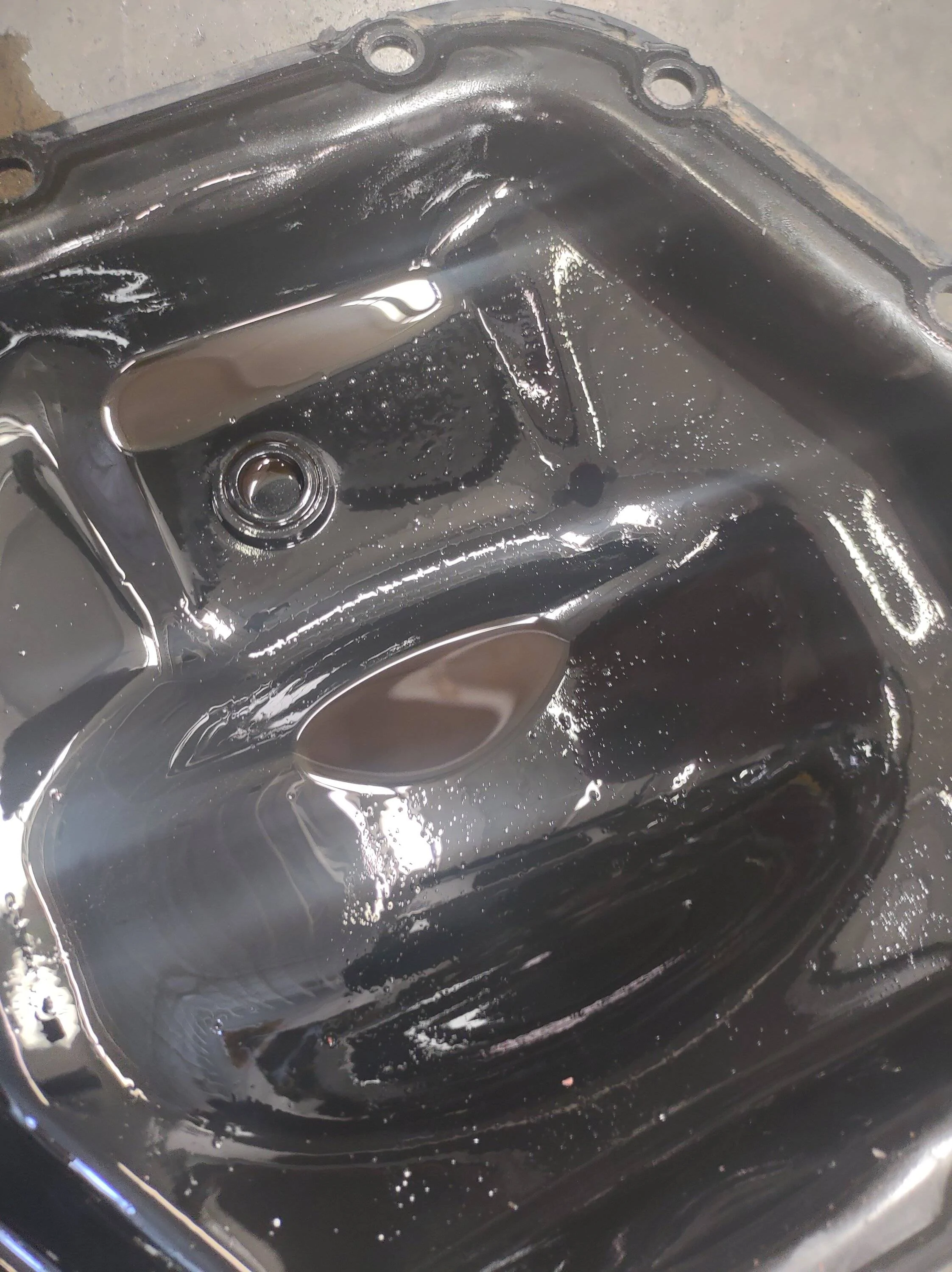

Today. Not much on the mag plug some flakes but not much in the cover itself either. Looking pretty normal after 40k miles
Keep in mind that the locker sensor magnet will have the same amount on it too. If you notice it takes a while for the lockers to engage or disengage, it’s because of that.
