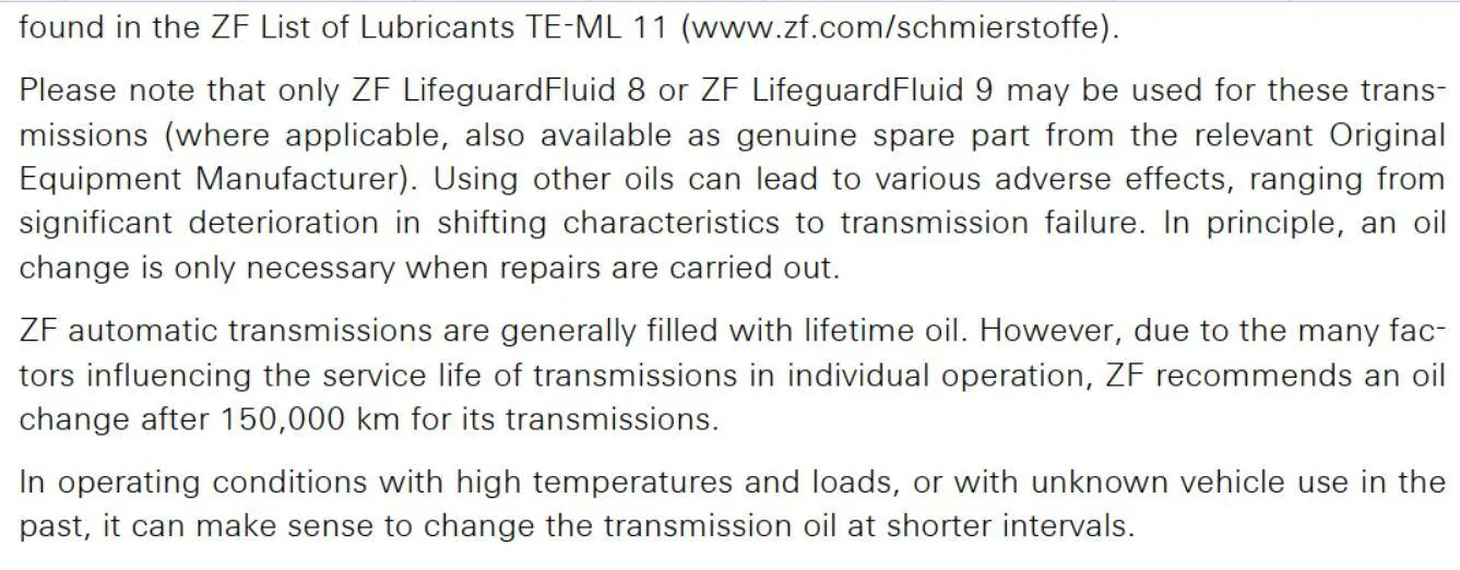

Why is everyone wanting to do all of this maintenance ahead of schedule, but then insist on not using the fluid that ZF says you should use in their transmissions?
You can never ever get all of the fluid out. I just plain see no point in risking it and no other fluid is "better" except in marketing and forum posts.

About to get my ZF8 transmission oil changed and bought Amsoil ATF (which I used for a DIY Trans Case change last year).
There's a lot of opinions on using Amsoil ATF for the ZF8. I don't want to start a debate about it here as there are many threads already but I will ask "Can I use Amsoil?" My 2020 is of course out of warranty.
I'm also thinking its a good time to upgrade my transmission pan to the a PPE pan.
Many of the basic considerations on ATF for the automatic transmission are covered in post #40 in a different thread. I also suggest reading that entire thread.
Service Intervals
The 1st link in Post #40 includes advice on NORMAL and SEVERE service intervals. The service intervals are based on ZF guidance (NORMAL), and 40% to 50% of the ZF mileage (SEVERE).
Advantages & Disadvantages
- Advantage of using MOPAR or other ZF-approved ATF equivalent: 100% same chemistry / additive package
- Disadvantage of using MOPAR or other ZF-approved ATF equivalent: For DIY, no warranty on damage to other parts
- Advantage of using AMSOIL (or other aftermarket ATF with similar warranty terms): Warranty on damage to other parts
- Disadvantage of using AMSOIL (or other aftermarket ATF with similar warranty terms): Chemistry / additive package is at least slightly different and mixing of ATF brands is permanent
