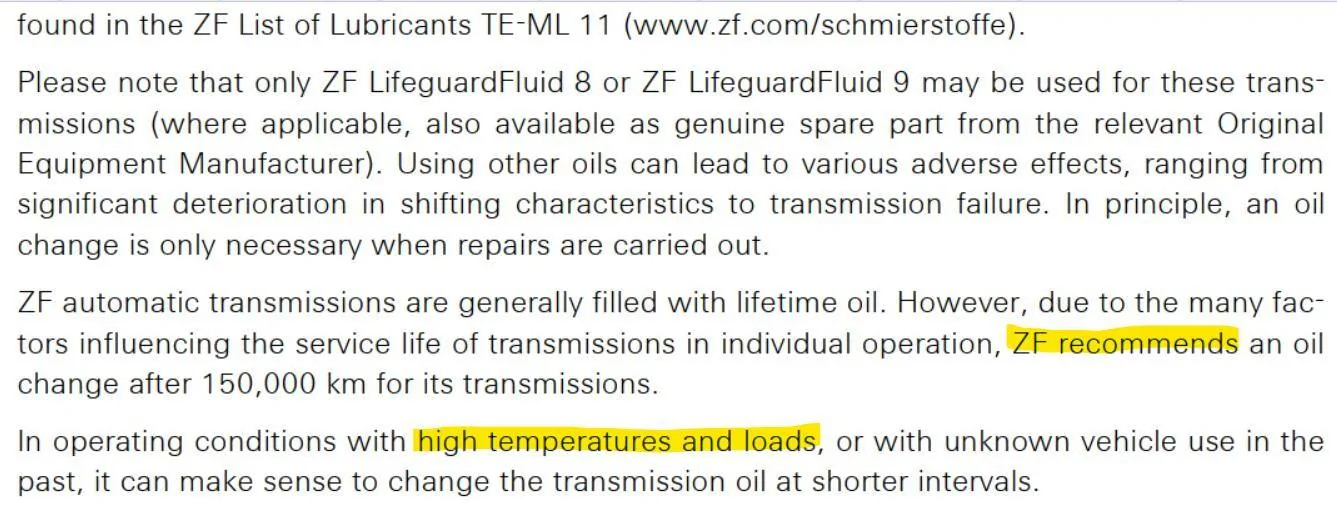

So, back to chemistry, and best practice for long life, ZF does loosen the reigns to changing oil “early” or at times not stamped in stone when “you don’t know the history of it”, when running hot, when it’s contaminated etc and it even tells you to “check”.
So “checking” is suggested but ZF doesn’t tell you how. God forbid you pull a sample and have it lab test wear metals and oxidation test. Maybe doing a “sniff test” or “dip your finger in the fill hole and rub them together test”, IDK, MAYBE a little varnish is ok like a little bit of cancer is ok or smoking little cigarettes is more ok than big ones.
I’m going to ask my lab tech to run oxidation tests on my transmission from time to time and IF varnish has markers that can be detected without having to do a tear down to visually see, I’m going to find out and share that knowledge here. I hate guessing and assuming, I like the cold hard data points. Maybe doing this might shed light on the whole complicated world of varnish and not letting it form in the first place.

The 4th of these four posts is more like War & Peace. The specific sections in the first three posts are quick reads. Facts are thoroughly documented back to manufacturer or licensor. Some advice is borrowed from experienced members of this forum.
1. Key Info on Fluids & Filters for Jeep Gladiator
- See Important Reminders | ATF for automatic transmission
- See Exceptions to Owner's Manual | ATF for automatic transmission
2. Links to Prices of Fluids & Filters for Jeep Gladiator
- See table in section 1.10.1
3. Warranty Coverage on Damage to Other Parts
- See ATF for the Automatic Transmission - After the Drivetrain Warranty Expires
4. References to ZF-Approved ATF Equivalents for 850RE Automatic Transmission
This post contains:
- Four documents related to ZF-approved ATF equivalents for the ZF 8HP50 / Chrysler 850RE automatic transmission
- Advice on ATF for the automatic transmission (and manual transmission) from the Jeep Gladiator owner's manual
- Key considerations on ATF for the automatic transmission
A few things I would add/repeat:
  • For normal driving (if normal is possible in a Gladiator), consider changing ATF for automatic transmission at 93K miles (or a bit sooner) and then every 93K miles (see key considerations above)
  • Whether a transmission service is performed by a dealer or an independent, it will essentially be a pan drop with sparkly new parts
    • In many DIY cases, the pan, gasket, and bolts can be reused; new ATF and new filter are required; for bolts to be reused, they must be steel and not aluminum, and be in good condition; use a magnet to determine type of metal)
    • A transmission flush is not recommended
  • Also see key considerations above for a discussion of Warranty Coverage
