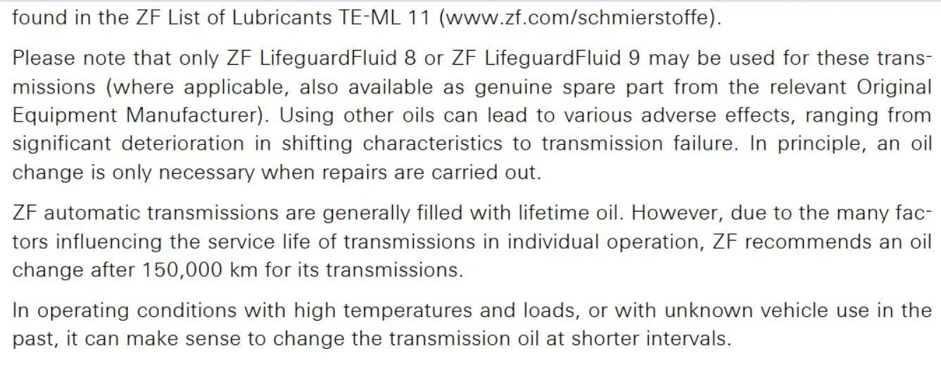

FCA isn't throwing anyone to the wolves. ZF themselves states the following -
Jeep Gladiator Transmission fluid or not! Screenshot 2025-05-11 101222
These aren't your 1970 TF727s with open vents and dipstick tubes and old-generation fluids in their infancy.
Obviously owners can have it changed, or change it themselves every 5K if it makes them feel better about it.

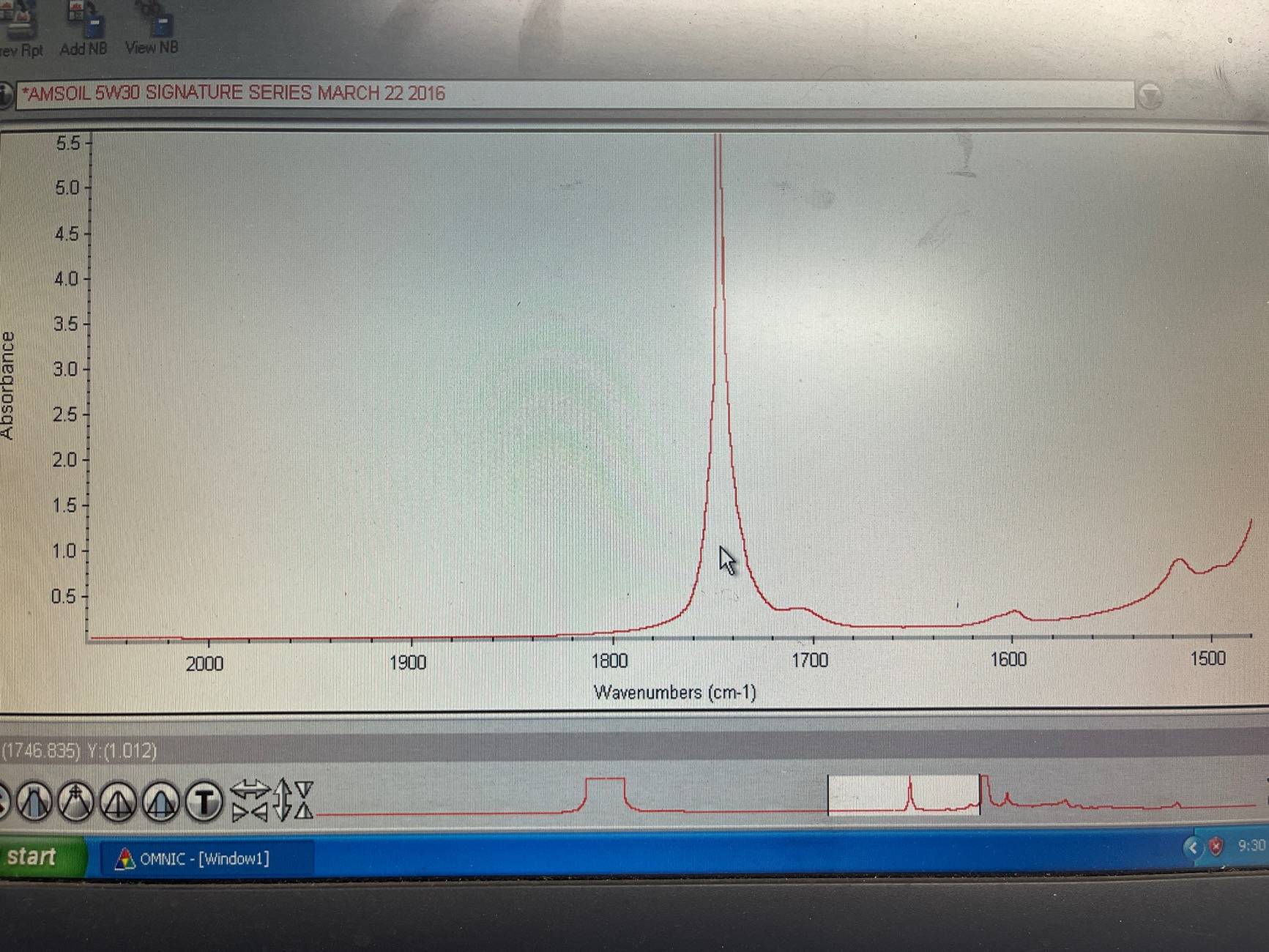

The lab tech called me today to say the “synthetic spike” in the Mopar 8/9 speed ATF isn’t as prevalent as AMSOIL’s ATF (making comparisons) so varnish markers can be detected but I only have 20k kms (12k miles) on this sample and as of now, there is no detectable varnish markers.
As I mentioned earlier, he asked me if the Mopar 8/9 was a full synthetic or semi? I have read from ZF sources in their docs that it’s been called both so I didn’t know.
He showed me from his computer files what a “synthetic spike” looks like in a full synthetic like AMSOIL’s and I’ve attached the screen shot for you all to see what he’s talking about. He said it’s essential to understand the chemistry of synthetics when checking for varnish markers and he tried very hard to speak more “dumbed down” so I could try and grasp what it all means in a brief 15 minute explanation.
If in their oxidation tests today, if the “synthetic spike” is like that of AMSOIL’s ATF, it will be impossible to detect varnish markers. If the spike is less than AMSOIL’s ATF, it supports the notion that MOPAR 8/9 speed ATF is semi-synthetic and varnish markers can be detected.
I asked him, because AMSOIL’s spike is so tall (see photo attached) and it’s impossible for this lab to detect varnish markers, can one drive hundreds of thousands of kms and not have varnish markers present? He said correct, but there are many other factors that cause the oil to need changing like contamination, moisture and wear metals etc. Lifetime oil can not be effective for a lifetime.

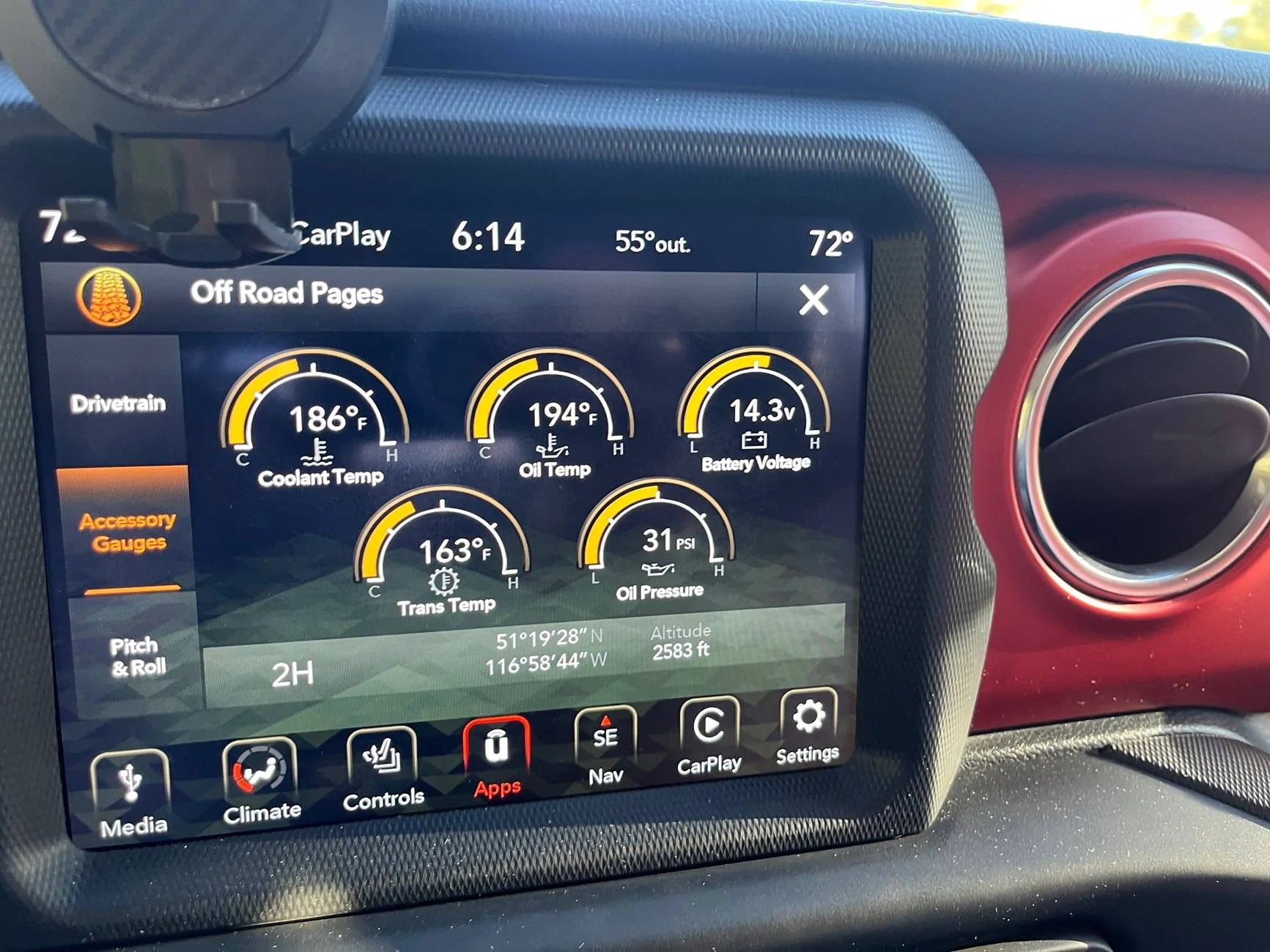

I noticed my temps dropped after the second pan drop, then dropped further on the 3rd pan drop and then dropped again on the 4th. I wanted to see if doing pan drops and keeping the oil clean was directly related to the cooler temps, my speculation and experiment “appears” to be working. I’ve also decided to stay with Mopar 8/9 to keep the chemistry the same.

I have to run mine pretty hard to get transmission temperatures up - I really only get concerned towing in our hills where it wasn't to "hunt" - and I force it into manual mode and things tame right down again.
A day in the 80s it takes forever for the transmission to really warm up unless running it hard.
If I was driving in 55 degree temps, it would take a good 30 minutes at speed in the highway in some hills to see transmission temperatures to get to coolant temps.

The temperature photo I posted above was a trip to BC I took with the wife last weekend to pick up a kayak for her. It was approximately 2000 kms return trip and we took the south route there and came the north route back. South was fairly flat, avoiding the mountain passes but coming back the north route with the kayak, we had several mountain passes to climb starting at 1600 ft elevation and reached heights in our trip of over 5400 ft.
The transmission temps never went above 182F (I’m speaking US’n to make it easy for y’all) and settled back down to the 160’s when cooled down. I’ve never seen this before is all I’m saying.

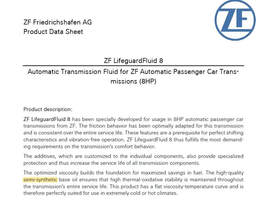

Yet ZF's own PDF says "Lifeguard is synthetic".
This says it is a semi synthetic 🤷‍♂️
Might be a difference in how Germany defines "Synthetic". They do not allow Group III base oils to be defined as full synthetic unless they are from Group IV base oils. Group III base oils in some instances can be defines as "Synthetic" in the USA market.
It is a difference in how the base is defined. For our purposes, it's synthetic like other USA products sold. For Germany, they aren't allowed to say that on the bottle due to the grp 3 base.
It's made through synthesis technology, which means that it was based on grp 3 but "massaged" into synthetic performance through chemistry.

We cheat, it is still a semi synthetic.
