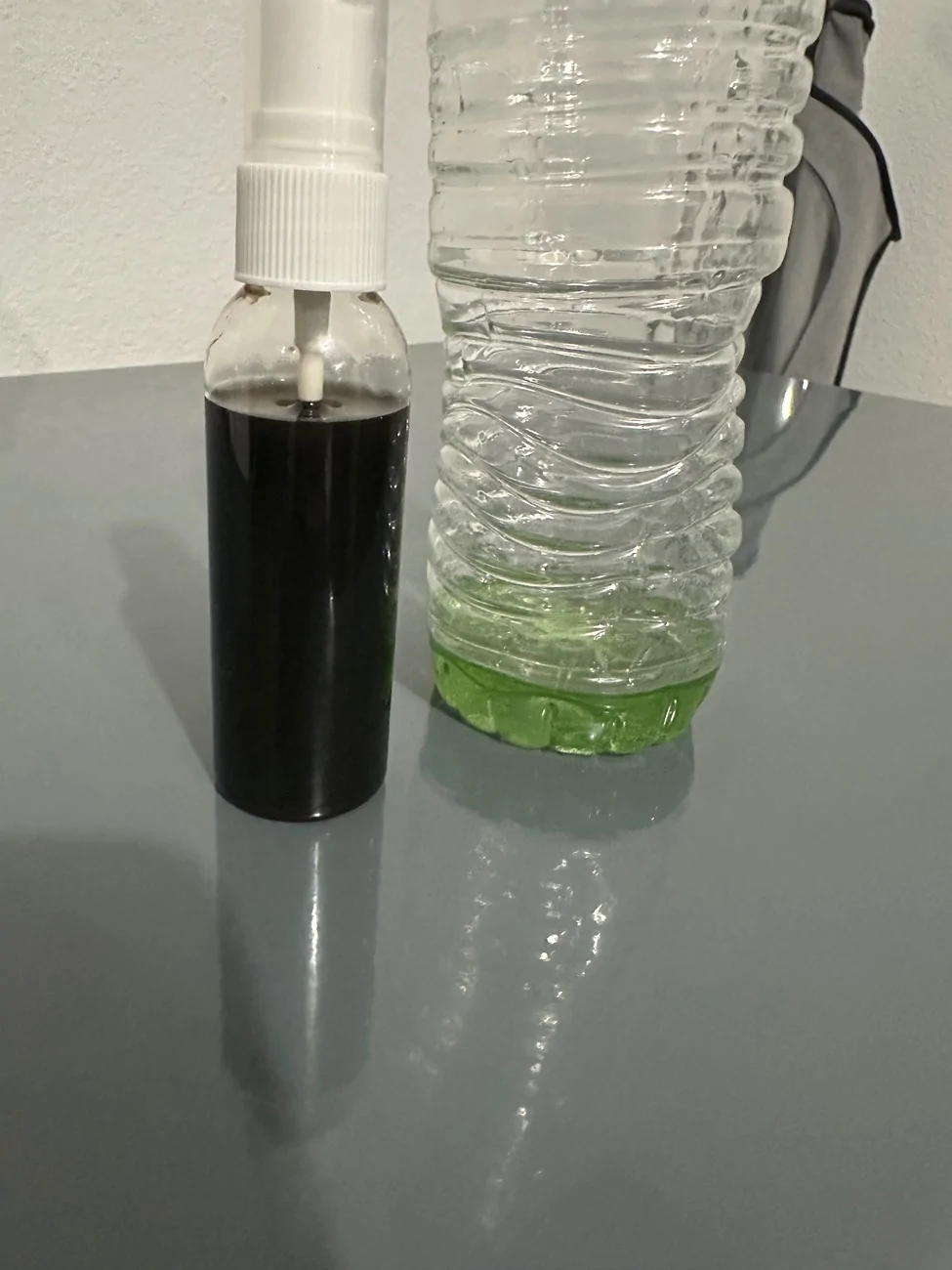

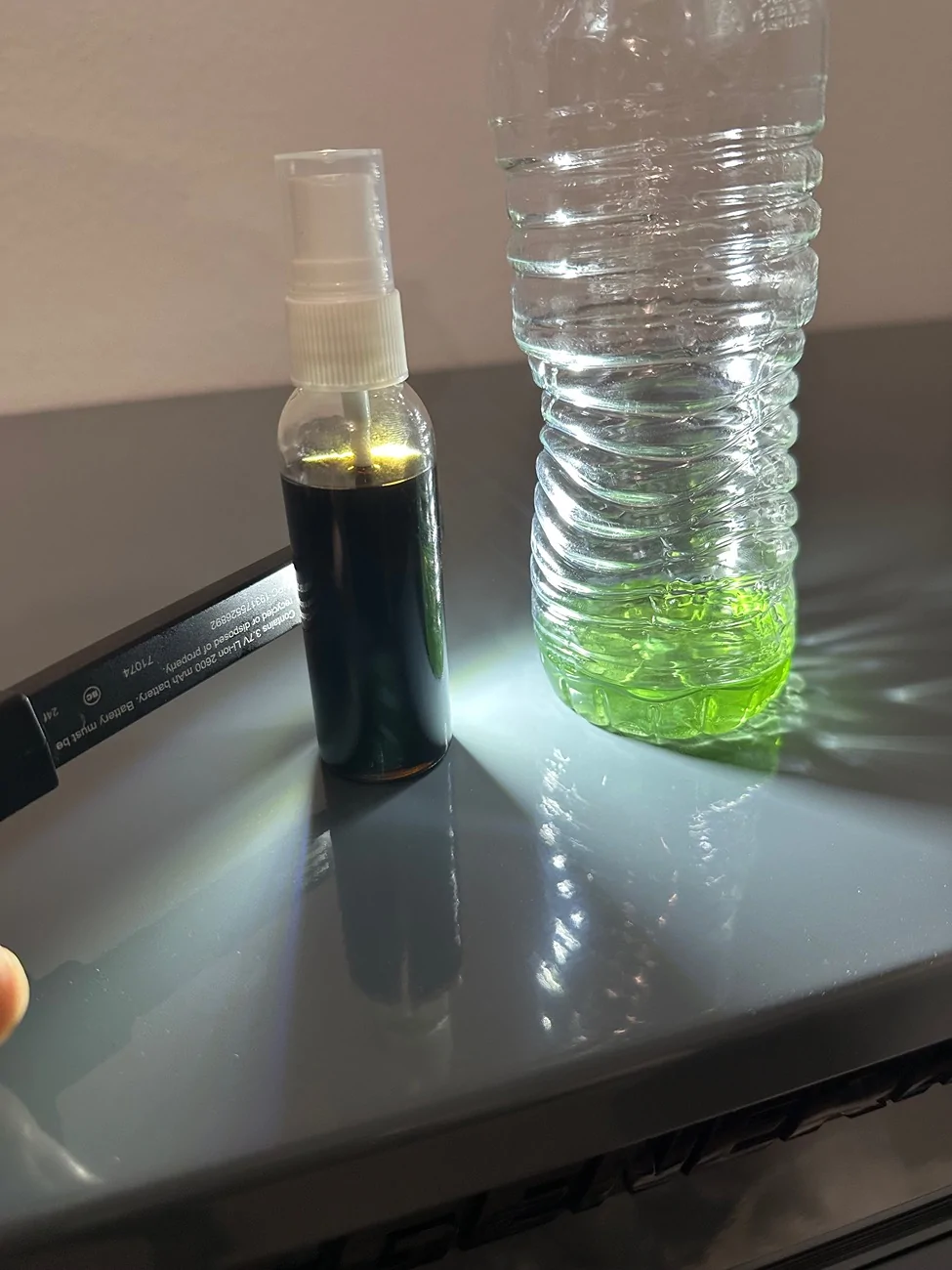

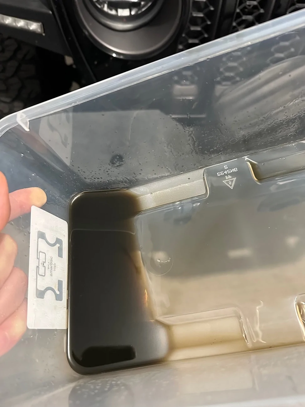

So that’s the backstory and I think about this everyday, it drives me nuts. Am I wrong to think this is a transmission issue? An unsettling noise ONLY in 6th gear that gets louder as the rpm’s increase and less loud as rpm’s decrease? It’s strictly based on those factors, the speed at which I’m going doesn’t have any effect. And then last night I check my trans fluid, dealer said they did but I don’t trust them anymore. I followed the proper instructions for checking fluid level on it and the fluid level itself was not low as fluid came out when I unscrewed the plug. Now I’m no expert but should the trans fluid look like this at 39k miles? I feel like it shouldn’t and I’m skeptical now if the dealer ever even checked the fluid at all. What do you guys think of this? I put the fluid in a small little bottle and next to a bottle with new Mopar fluid. The flashlight I have behind it is pretty bright and can’t penetrate through the fluid at all. And now my concern is if something is actually wrong in the transmission, I’ve been driving it for 10,000 miles since the noise first started.

first I would attempt to record the noise. Second, do a drain and fill on your transmission. Make sure to replace the filter in the pan.

Thank you, I was thinking of that but wasn’t certain if I should do anything even as simple as a drain and fill if there could be something wrong while under the warranty still. I’ll give it a go and see if it helps, my concern is if there’s any long term damage now

It is making noise, but it still functions. The dealer cannot do anything until it shows a CEL, or stops working.
Anything you do is a risk of warranty denial when it does break.

Appreciate that information thank you. That was my concern, so are you saying that a drain and fill with a filter replacement would void that powertrain warranty? I know it’s a maintenance procedure and other procedures like changing your oil won’t void warranties but with the trans I’m not sure if that’s outside that scope?

According to Jeep, the warranty provider, the fluid is a 'Lifetime' Fill and the transmission does not need service under normal operating conditions. The designer of the transmission recommends a drain and fill somewhere around 75k miles. To get a nearly complete change of all the fluid would require three drain and fills.
A drain and fill may not do anything to help with the noise. Where the fluid is that dark, and the noise is only in 6th gear, i suspect something will fail before the warranty is up. The best thing for the transmission would probably be a drain and fill. The best thing to ensure you have no issues with warranty coverage is to do nothing more.

I don’t know if it’s the best option but at this point I’m kind of hoping for the transmission to fail (if that’s truly what this issue is) because it’s been going on for a while now. The last thing I want is a damaged trans and a voided warranty so i suppose I’ll just wait it out a while longer. One again I appreciate you sharing this info with me!
