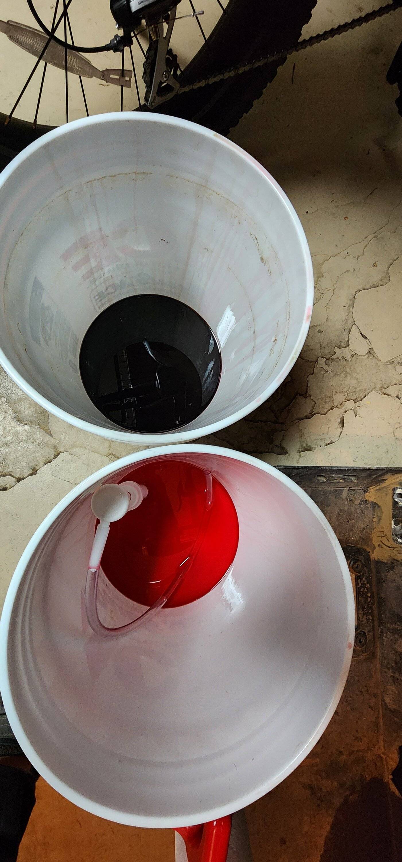

Hootbro
Apr 13, 2019
10,237
20,136
2025 Gladiator Sport
Hootbro did you jack up the wheels ? This is the part I thought would be hard for me to accomplish being lifted and all..how far does it need to go up an 1" or 2" my Jacks will lift high enough to rotate my tires ..is that sufficient? I have read the procedure several times and some leave that part out of the procedure which is ultimately why I had my local dealer perform the task. Also have nothing to force the fluid into the pan.
No, left wheels on the ground and just shifted through all gears I manual mode. Did the temp level check and filled until dribble and called it a day.
In both cases I measured what drained out and what went in and it was pretty much the same.
