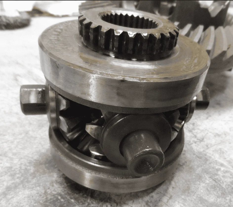

Here's a smaller version of the clutch type limited slip - curious as to which gears/teeth you were talking about.
This one had a ton of miles on it and the respected shop that rebuilt it didn't know their head from........ as far as clutch disk assembly, pinion preload, depth and so on.

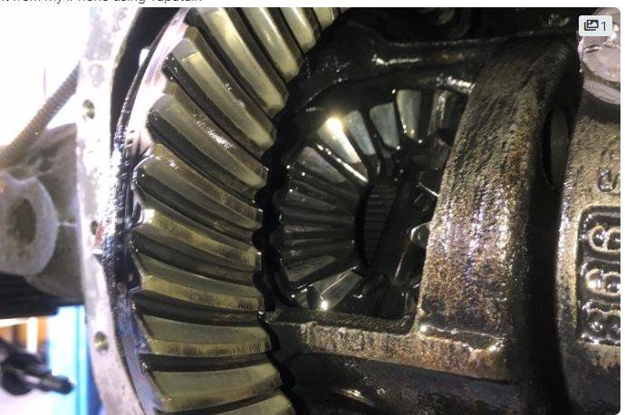

The smaller teeth in this picture or something similar. I assumed they were part of the factory limited slip, but I have not personally rebuilt one, so perhaps I am mistaken. I have seen 4 instances where they were broken off in a little more than a year and two myself with less than 35k miles. I also had it happen in a Jeep Liberty years back. All my rigs had the factory limited slip, so I made the assumption.
Jeep Gladiator Early fluid changes: differentials, transfer case, manual transmission ls.JPG

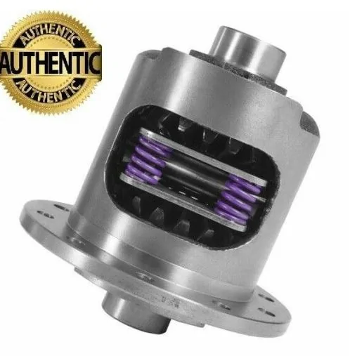

When I replaced them, it was with this type of unit from Yukon.
