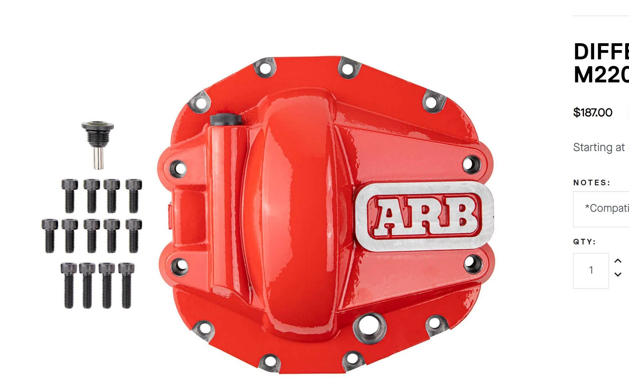

Hi all, this thread has inspired me to change out my rear diff fluid. I was disappointed to learn that there isn't a drain plug. Does anyone know if changing the cover will void the warranty? The one I've settled on is the ARB cover (pictured below). I figure that I'll take it to the local shop to add the cover that has the drain plug and after that I'll do the fluid changes myself.
I called the dealership to ask what they would charge to change the fluid and was shocked at the way they took my question when I told them I had 23,000 miles on my Jeep. "Why do you want do change the fluid? It doesn't need to be changed until 120,000 miles". That was really their response. And their price to change out the fluid? $289.
In addition to my question about if the cover would void the warranty (I can always put the old one back on if I have axle troubles and have to make a claim), I am wondering if it will hurt to use mobil 1 75w`140 in the rear diff?
I live in the Southeast, Georgia, and make many long haul trips to Arizona and load my truck up to capacity. I also drive to other states (last trip was New Jersey) and buy a truck load of materials. So I have day-long stretches on the highway and often with the max 1,000 pound payload in the bed. I haul in the summer a good bit so I'm thinking the 75w140 is the way to go?
I tried to find a gear oil without "LS" or limited slip friction modifiers added and had no luck finding anything other than Redline. I spent way too much time searching and decided to just go with Mobil 1 after reading others experience with it and things like valvoline in the bags.

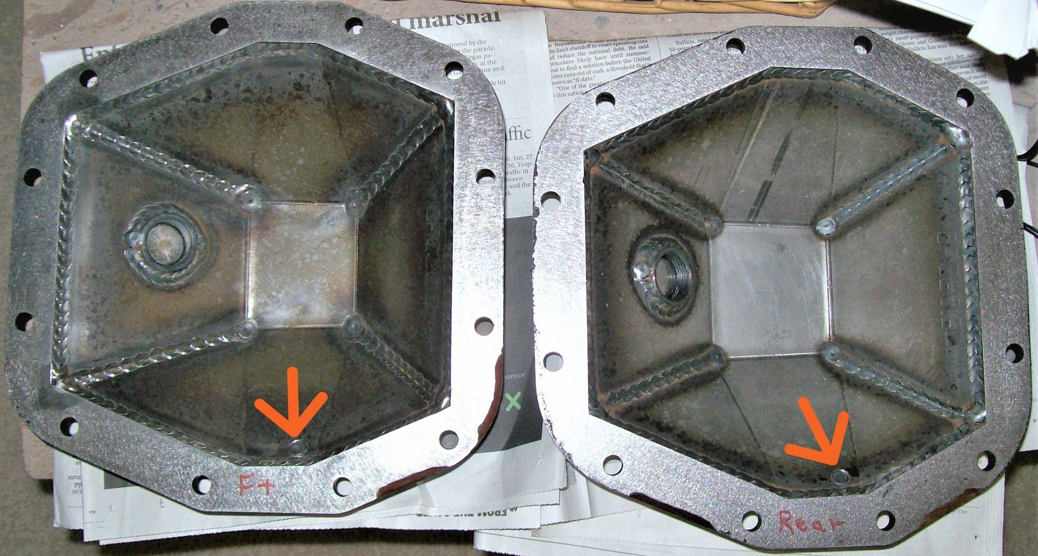

I used the 1/4" thick covers from CavFab and Motobilt, drilled and tapped for 1/8" NPT drain plugs. I prefer grade 12.9 Allen head M8x1.25 bolts and torque about 24 ft-lb. Lesser grade bolts should be taken to only about 18 ft-lb. Some specs show 30 ft-lb but that would be appropriate for 3/8" or 10 mm bolts.
Drain plugs were deleted by Dana around 2021.

Here are the insides of my covers with 1/8 NPT plugs installed:
